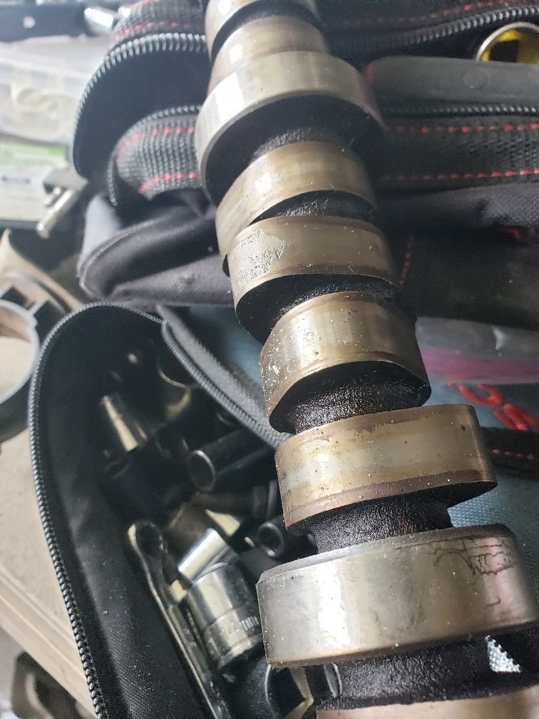

And the hits just keep on coming. this was the cam from the supposedly "good" donor motor...really glad we pulled it all the way down...new cam, cam bearings, roller lifters and timing set on order.
If you look close enough, the coating on the cam is just gone on a couple lobes...

Yeah, it's pretty pitted in some places. I think it's safe to say that donor motor was run low on oil.
Yeah, also possible head gasket issue as well. New cam will be here tomorrow hopefully.

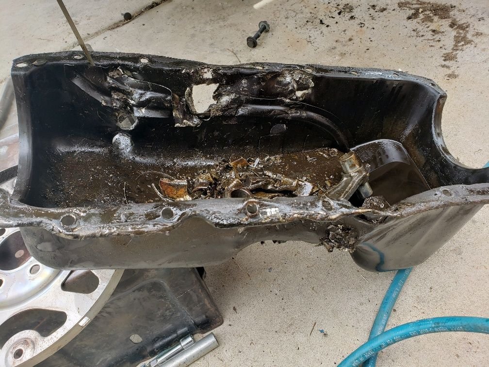

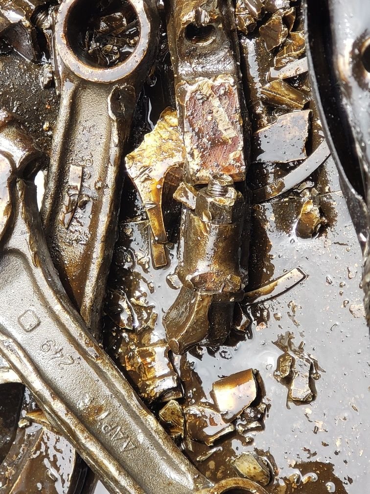

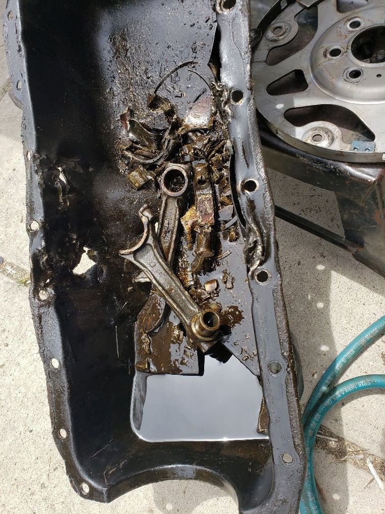

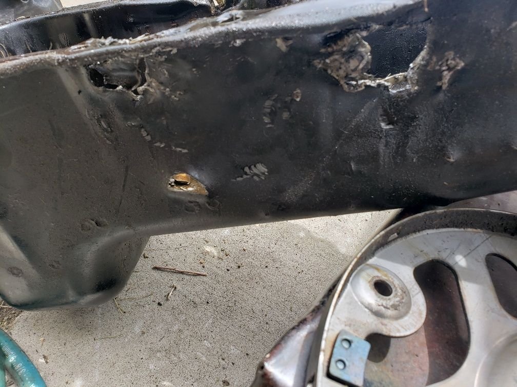

OK, for all those that have been following this little adventure, we FINALLY have the old motor out and the "new" rebuilt motor from the donor 2wd Durango in...as promised, here are the pictures of the aftermath of damage found in the lower end of the 5.9L engine that came with the 2000 Duragno:
Cylinder #4
I sent some of these to my son in Colorado...after asking if he liked jigsaw puzzles...told him some assembly would be required...he doesn't know the donor motor is completed and installed...just ran out of steam yesterday...taking the day (or maybe 2 days) off and then buttoning her up.
Thanks for everyone who has helped us get this far...
Steve

Wow, that's pretty thrashed....... How many miles were on it?
