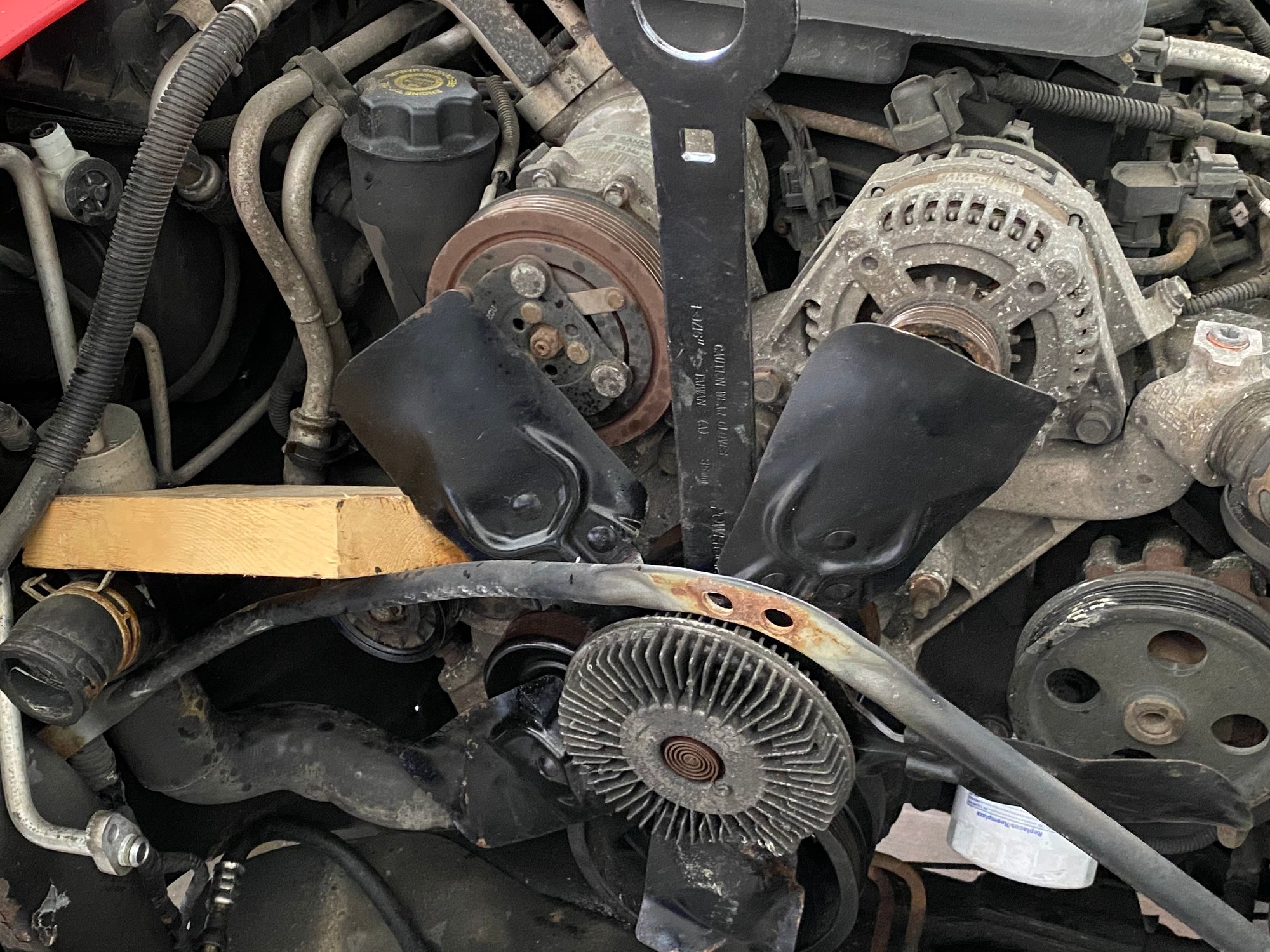

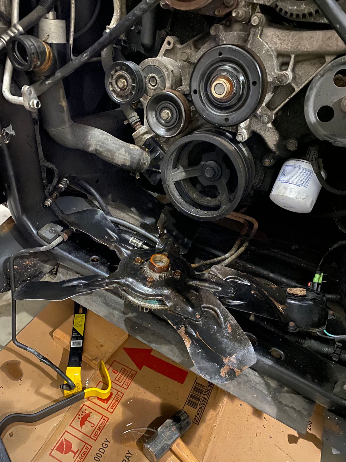

After long delays, and a visit to the pull yard, I’m back looking at this project after a year of the truck sitting still in my garage. Clutch fan needs to come off before rebuild. Still learning the ropes as a guy who never changed his own oil before but making progress. But I wanted to keep this thread informed.
Advance auto parts was kind enough to loan out the clutch wrench so here we go. I don’t care about the fan anymore so used a wood wedge and a sledgehammer. And...after days of deep creep even, the fan clutch nut just not moving. It doesn’t help that the wrench actually turns (like a stripped feel) on the clutch nut with force, either the wrench is 1mm big or the nut is too small, I’m debating if finding a way to put a rag or tape or something else over the nut will help that wrench snug up better, any ideas? Yes I know the wrench turn is counter clockwise.

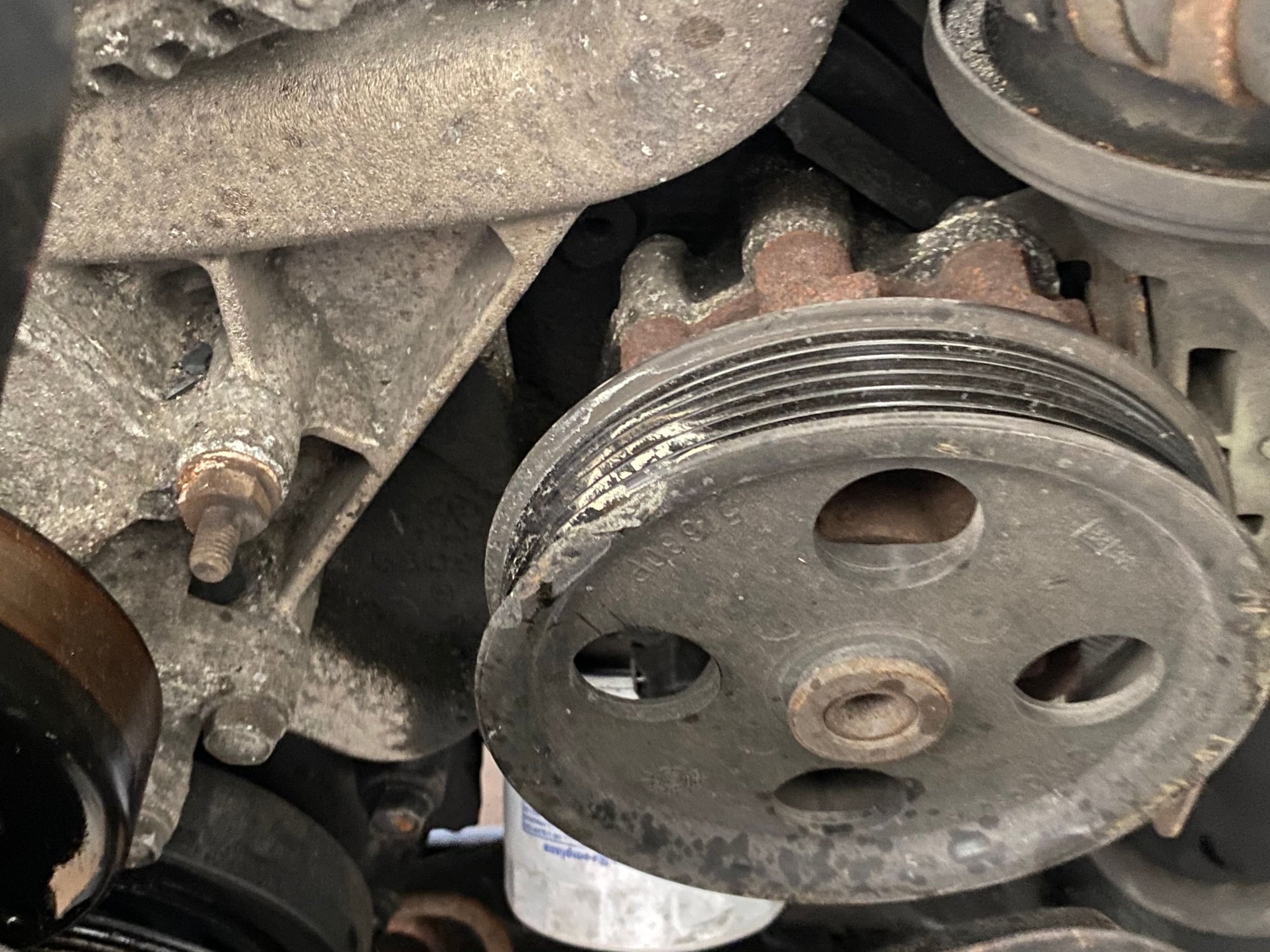

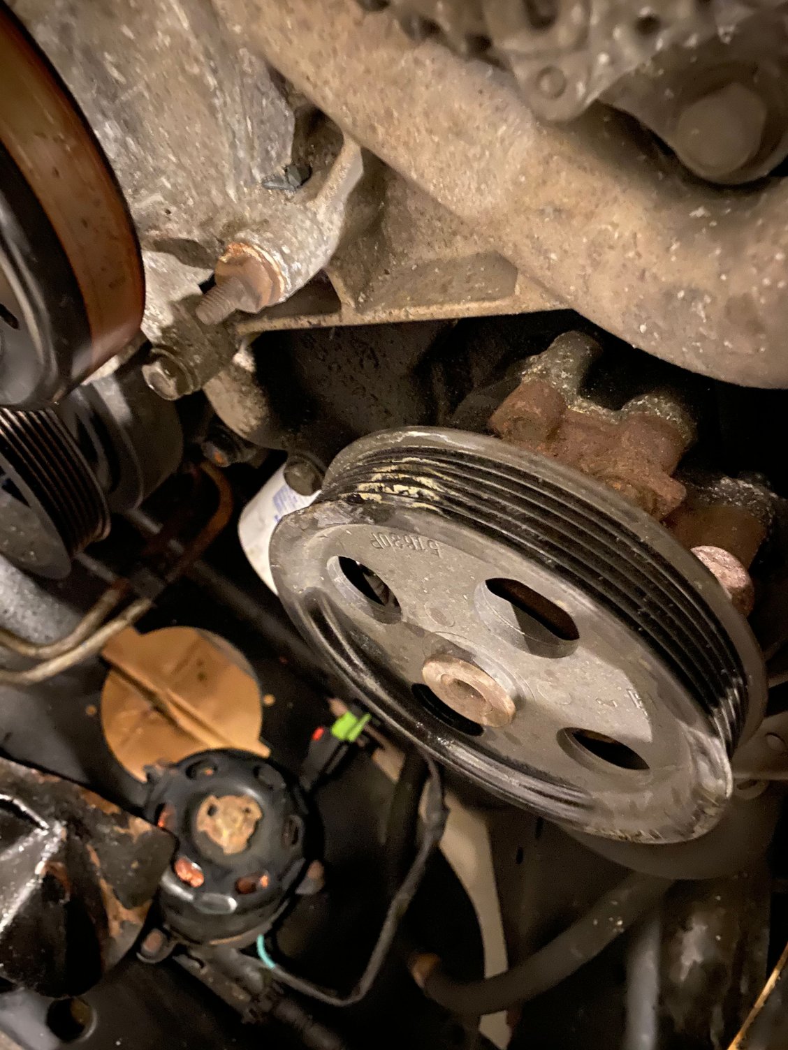

No body work pricing yet just what I think I need to get it running. I could junk hunt for some of this but I am thinking I just spend the $275? That said if the repair fails I am out $275. Speaking of, noticed this on one of the pulleys - can I leave that be or am I now also needing to replace this as well? I was hoping to stop at the fan clutch.
Latest photos, welcome any thoughts on the fan clutch removal, as I remain stuck, I think maybe the loaner wrench is a little worn?

Clutch and fan are off. Chalk up one for the good guys. If the serpentine belt pulley isn’t also dead due to the chip and minor thread damage I think I’m ready to build back out. Just need to decide if I want to go to the pull yard or just buy new. Pull yard wants $40 for a junk radiator and a new generic one is $75.

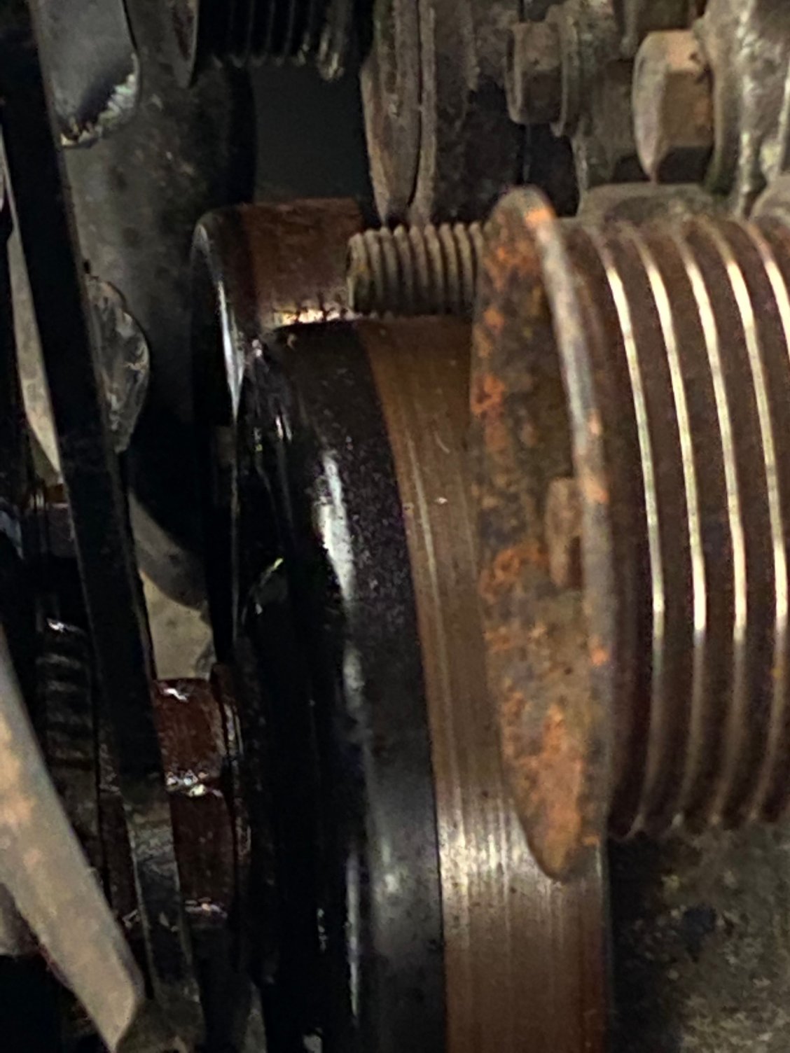

Quoting myself here...
On the 4.7L, I laid a strip of cardboard on the fan pulley to protect it, then gripped the pulley edge-wise with a channel lock. Was able to lock it against something, then pulled the fan nut with another large channel lock. (Didn't have an adjustable wrench big enough to fit that thing).
The fan pulley is the pulley in your pic above. That stud sticking out is what I locked the channel lock against. Better photo of the pulley and the threaded bolt stud sticking out below. This is from when I did my water pump some years back. Remember to protect the pulley with something before gripping with channel lock....
