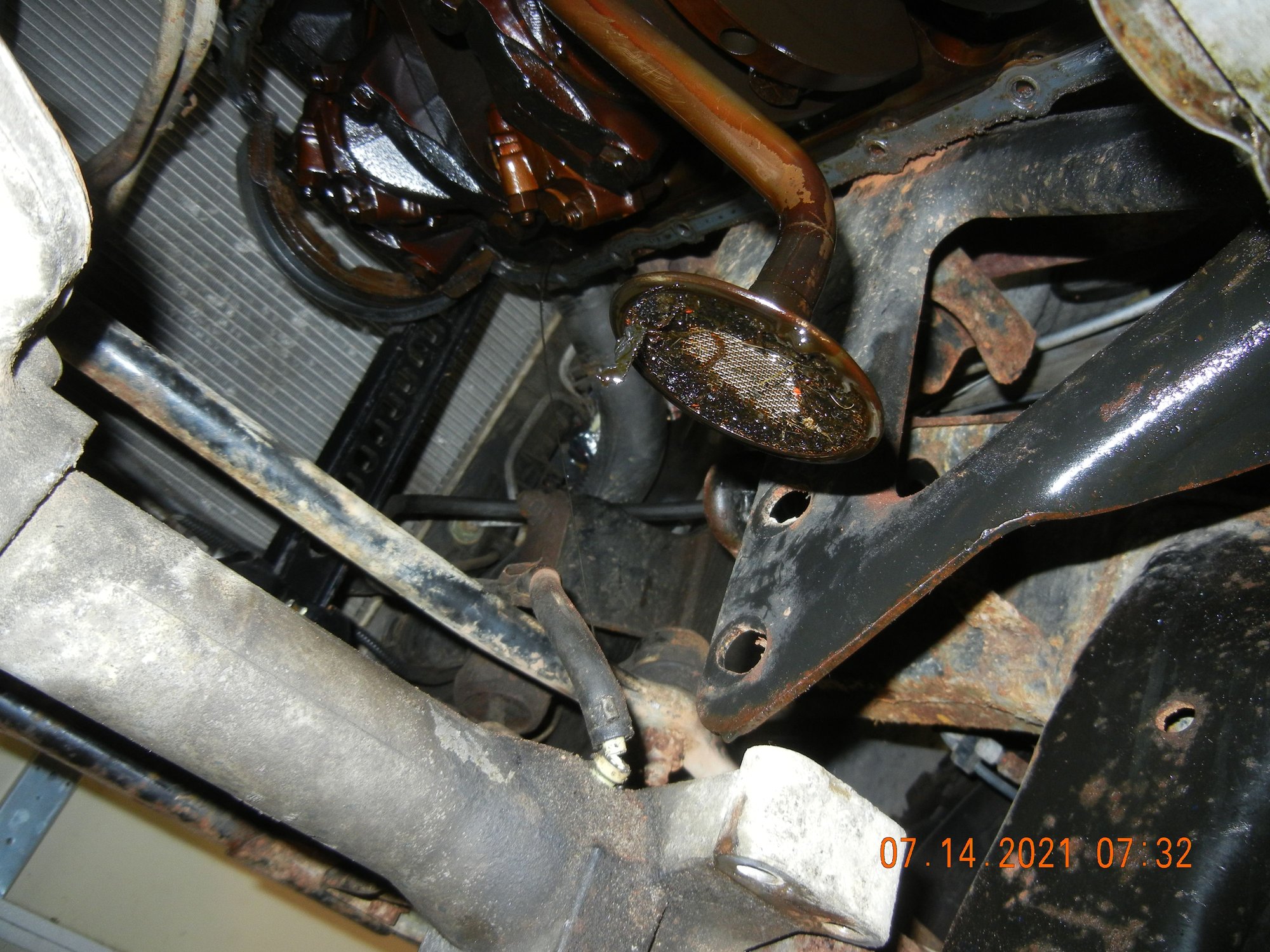

Around 100k got intermittent oil pressure lights.
Soaked and cleaned pickup through drain hole - went away for awhile.
Now at 150K, opened up, new plate gasket, and now into bearings.
Pickup was 6/7s blocked with 'crystal'-y debris, and some (5 sq in) on block near pickup - but not a sludged up motor at all.
All rods down to copper, mains not so bad, except 3 - the thrust bearing - and crank scored.
All seem worn, not foreign deposits/embedded.
I cleaned the journal a tad, back polished another tad, and fitting 1's and 0's mixed to all positions.
Rods smelled horribly of fuel (started project just after an oil change, that was also fuel-y.)
New pump ready to go in; soaked, reamed, and picked pickup clean.
What causes a crystal-y debris?
Will fuel thin oil (but yet not cause overfill) and 'cut' bearings?
Can plate gasket somehow affect oiling or bearings?

I don't think anything would cause the oil to crystalize... more likely, something was added to your oil, and THAT is what crystalized down there. Sugar, maybe?

How long have you had the truck, or how many miles? You alway inherit former owners habits, good or bad. What oil have been using… brands, conventional or full syn? Change habits? Been using any additives?

Had since birth, 150,000 now, religious oil changes, Mobil 1, and 3 or 4 plate gaskets.
Anyone have experience on fuel smell? (Plain old leak, blow-by, plate gasket?)
