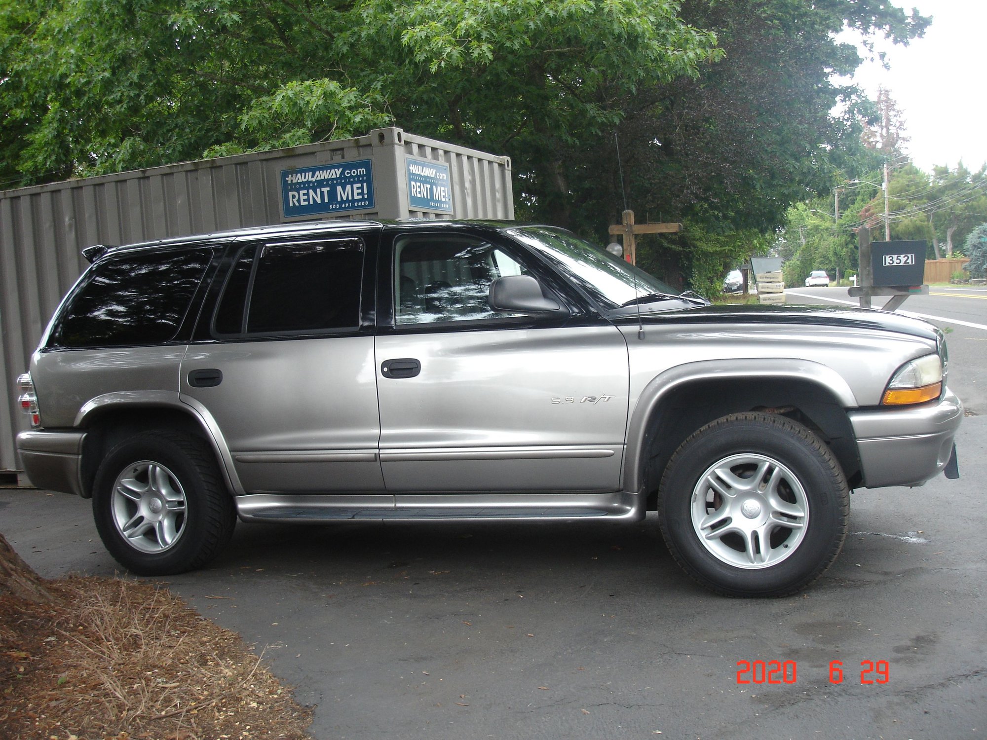

Drove my 2001 Durango yesterday evening and all was fine. This morning it would turn over but not fire up. It usually starts up first turn of the key. I've tried 5 times today to get it to start but it won't. It has a full tank of gas. Any ideas?
