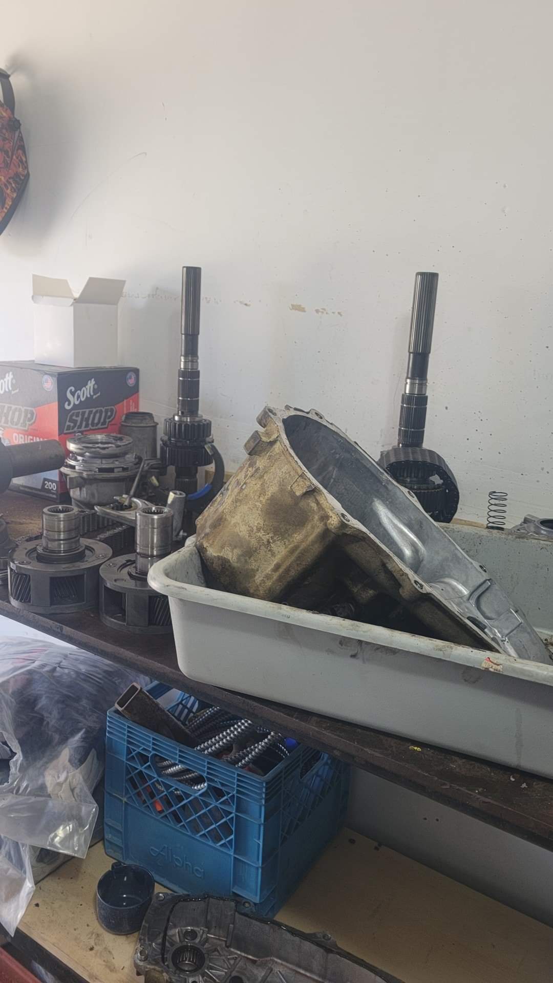

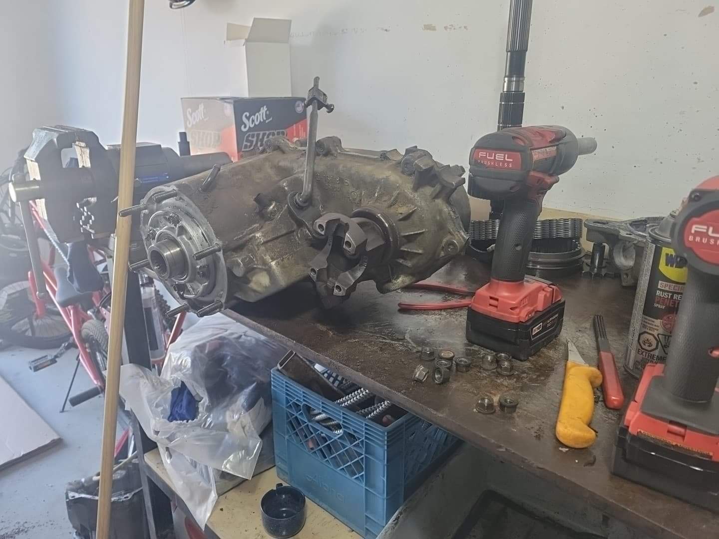

The bearing behind driveshaft yoke piled and ripped the tcase in half. I got a donor from a 94 Ram 1500, its a 231, but a few mild differences. The end of the planetary that goes to the trans mission was longer, shown in the pic, the gear ratio was different, and the outside planetary bearing was thicker. Had to swap the electronic 4x4 switch for the vacuum one on the donor, and the front drive shaft yoke. So I tore them both apart and swapped the internals from my blown up case to the donor.
Got it back in everything looks good. Need to replace the ujoints in the H yoke on the front driveshaft, think the blow up hit em.pretty hard. All sloppy now. Looks like a chunk got taken out of one the joints.

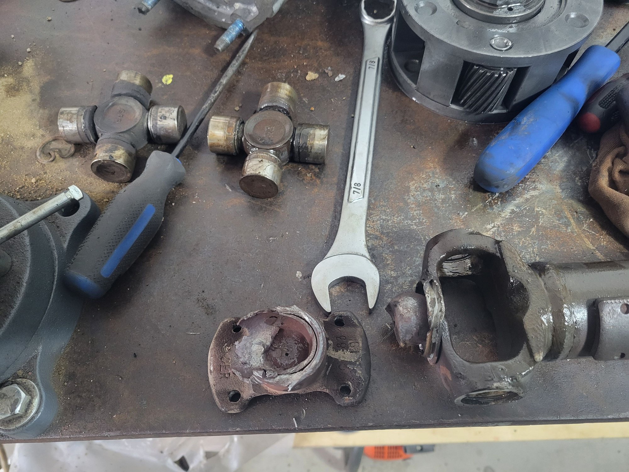

the true culprit I believe....
welp....new driveshaft
Old May 9, 2022 | 09:40 PM
that_guy's Avatar
that_guy
Joined: Jan 2011
Posts: 4,099
Likes: 44
From: Pittsburgh, PA or Columbia, SC
yeah, that's gacked
