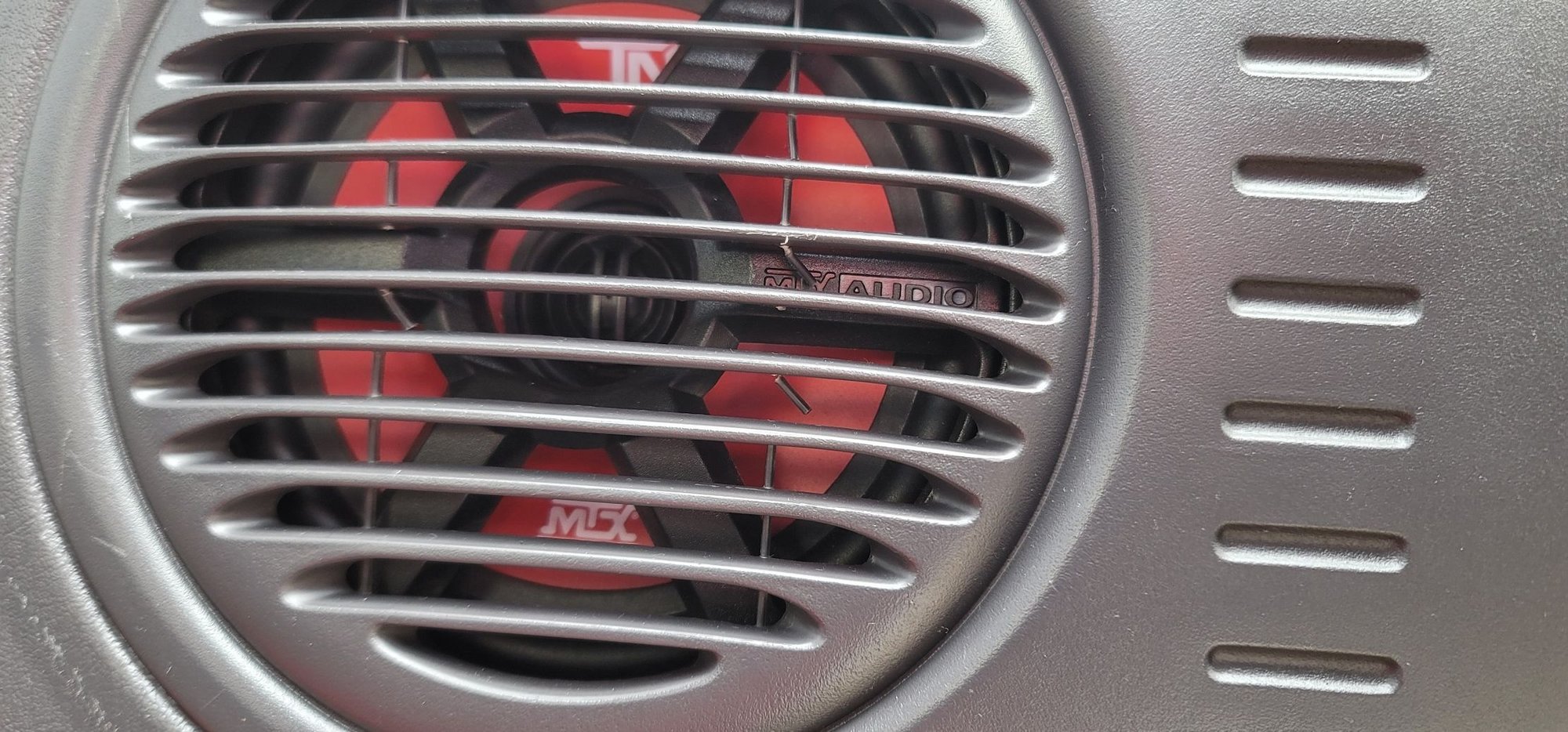

Rear door
front door

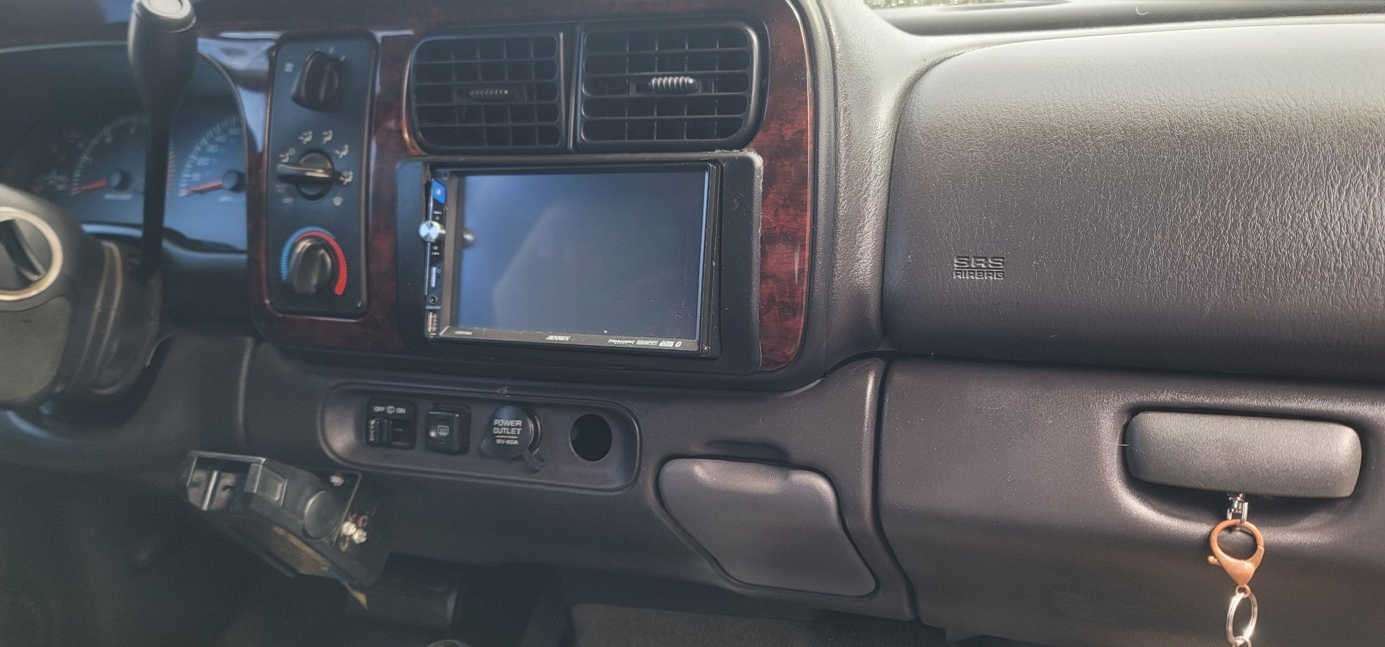

my stock unit a day after installing door speakers display went kaput so I upgraded but still use the Infinity amp for now.

I like these as they are not Hi watt speakers so it works great with the stock amp, early in my audio upgrading days I made the mistake of installing some speakers that handled a high max and i think 125 watt rms without realizing I would not get the great sound or SPL without a amp capable of providing that wattage . I learned my lesson quickly

Thanks for the recommendations. I'm currently rocking the Kenwoods. They do work and much better than the blown out stockers they replaced. However, not much depth to them. I may try these MTX speakers in the future. I do like that they are Red. They'd accent my red Durango well. They are bookmarked.
