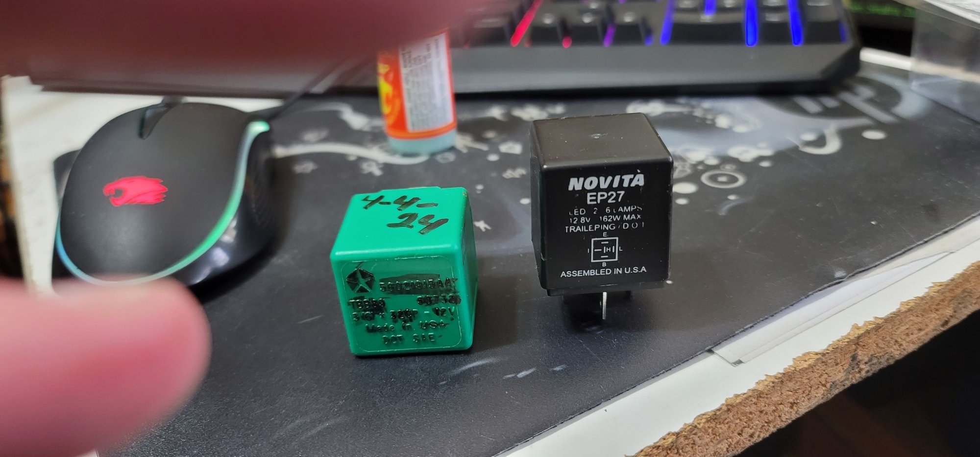

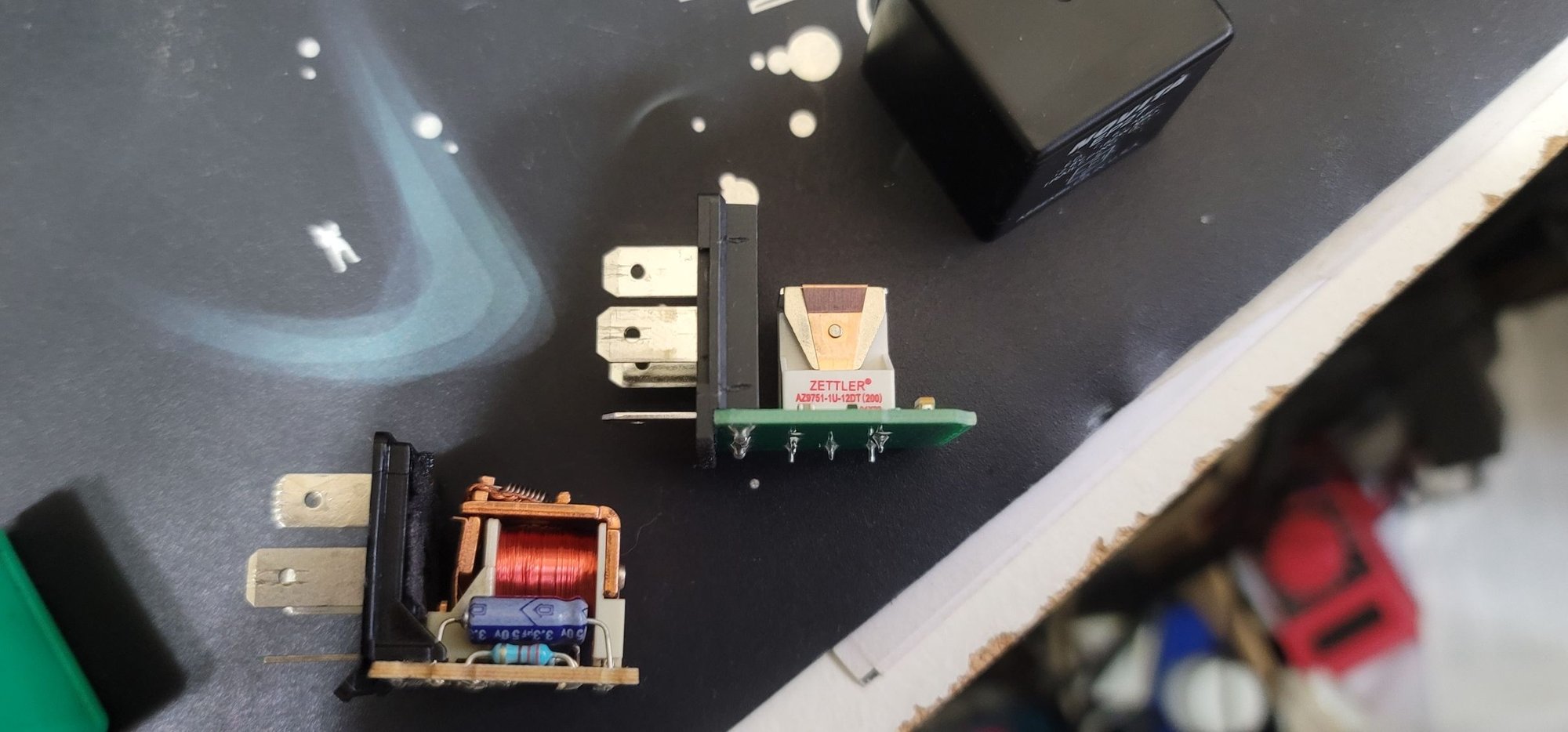

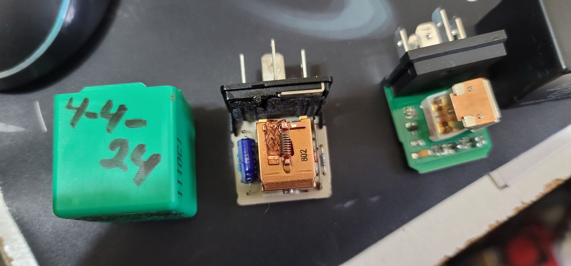

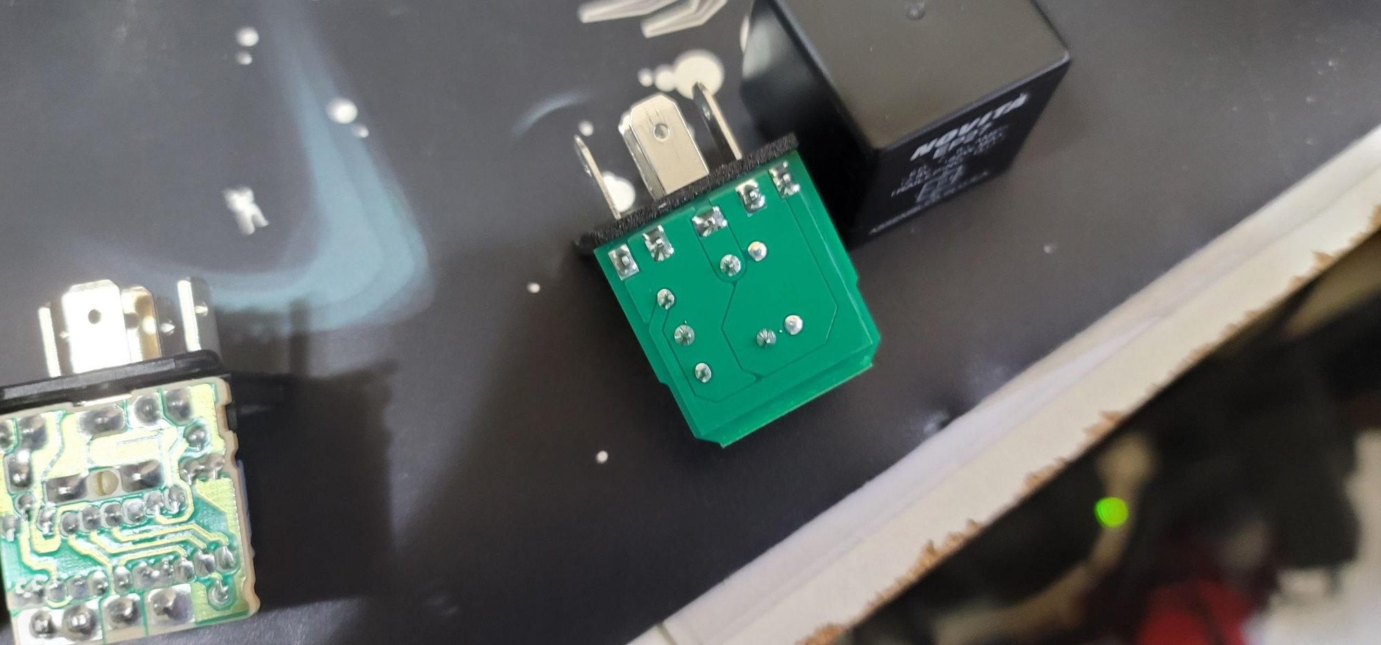

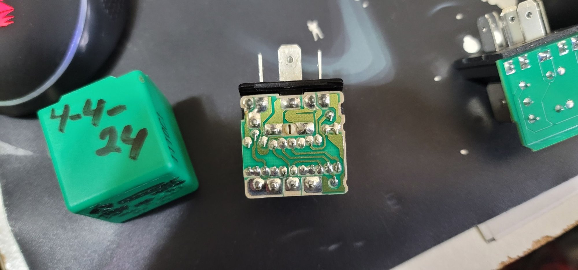

Since I have been unable to find a reason why there are 2 units at such great difference in price I decided to open up the new one and it is Obvious now.
The pictures show exactly why, The green one looks to be extremely HD while the black one to me looks like it is the bare min of what is needed to allow the hazards and turn signals to function.
Though the New (Black one EP27 does state it is LED compatible where it does not state that on the green one.
Not only that but if you look at the bottom pic the Green (EFL17) has an immense amount of electronics in it and HQ Traces as well as solder joints where again the Black (EP27) minimal of both as well as about 1/2 the thickness of the PCB
I would not doubt if the Green one (EFL17) with the Mopar Pentastar thingy is the original unit from the factory. making it 24 years old.
I assume these are what is considered a Hybrid or Electro/Mechanical unit?

That's for sure, here is a great example of you get what you pay for, I am not expecting the EP27 to last that long to be honest, I could not get in a Picture but the contacts are easily 3X larger on the green one as well.
