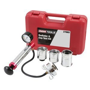

I'd wanna be sure before going the difficult route. I'd rent a radiator pressure tester (free when you return it) from an auto parts store, then pump it up to the max pressure marked on the radiator cap. This allows you to pinpoint the leak without the distraction of heat, moving parts and noise. Just pump it up, get under and wait for the drips.
good idea, is there any way to peak inside the bellhousing without dropping the trans?

Its official… rear freeze plug leaking. How difficult is it to pull the 5.2 in a 4x4 durango? Probably gonna do a light rebuild on it and just replace all gaskets
