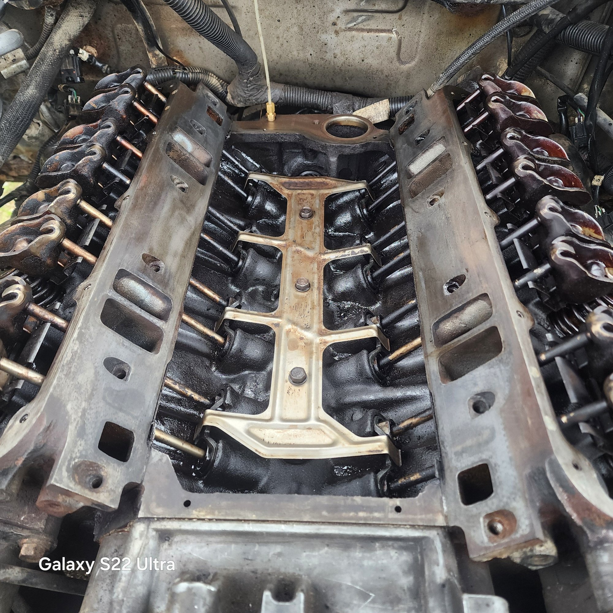

Well the plenum had one bolt broken on the frontleft or right sitting in the truck. But it had been able to seep air. And now the aluminum is rotted by the hole I'll include pictures the engine has so much carbon build up in it and doing a diesel flush just broke it all loose.
That is definitely sludged up. Have you dropped and cleaned the oil pan? Your pick up tube might have sludge blocking it. The 5.9 in truck didn't look anything like yours. Granted, it did have a flattened can of Schlitz beer and several oil soaked cigarette butts, but not much sludge.

I've had the pan off twice once just to clean crap out didn't realize I needed to start on top, then again cause I thought it was the oil pump but ur right it just might be the pick up screen and I put that maple syrup oil in it thinking that was the issue being worn.

All better
All better
Now i could use some torq specs if there out there for the intake i found most of em and also for that plate u see in the picture that hold the cam rollers in had to clean it also
I dug my manual out.
Intake plenum to intake is three steps. 24 INCH pounds, then 48 in-lbs, then 84 in-lbs. The intake is rather involved. Start in the middle and do bolt numbers 1 through 4 in increments to 72 inch pounds. Then 5 through to 72 in-lbs. Double check all bolts are 72 in-lbs. Then in order torque to 144 in-lbs. It's raather time consuming, but two years later, my intake is just fine.

Awsome i couldnt find the right process and when id find one it was for the 6 cyl. Ill update if it starts tonight ..
