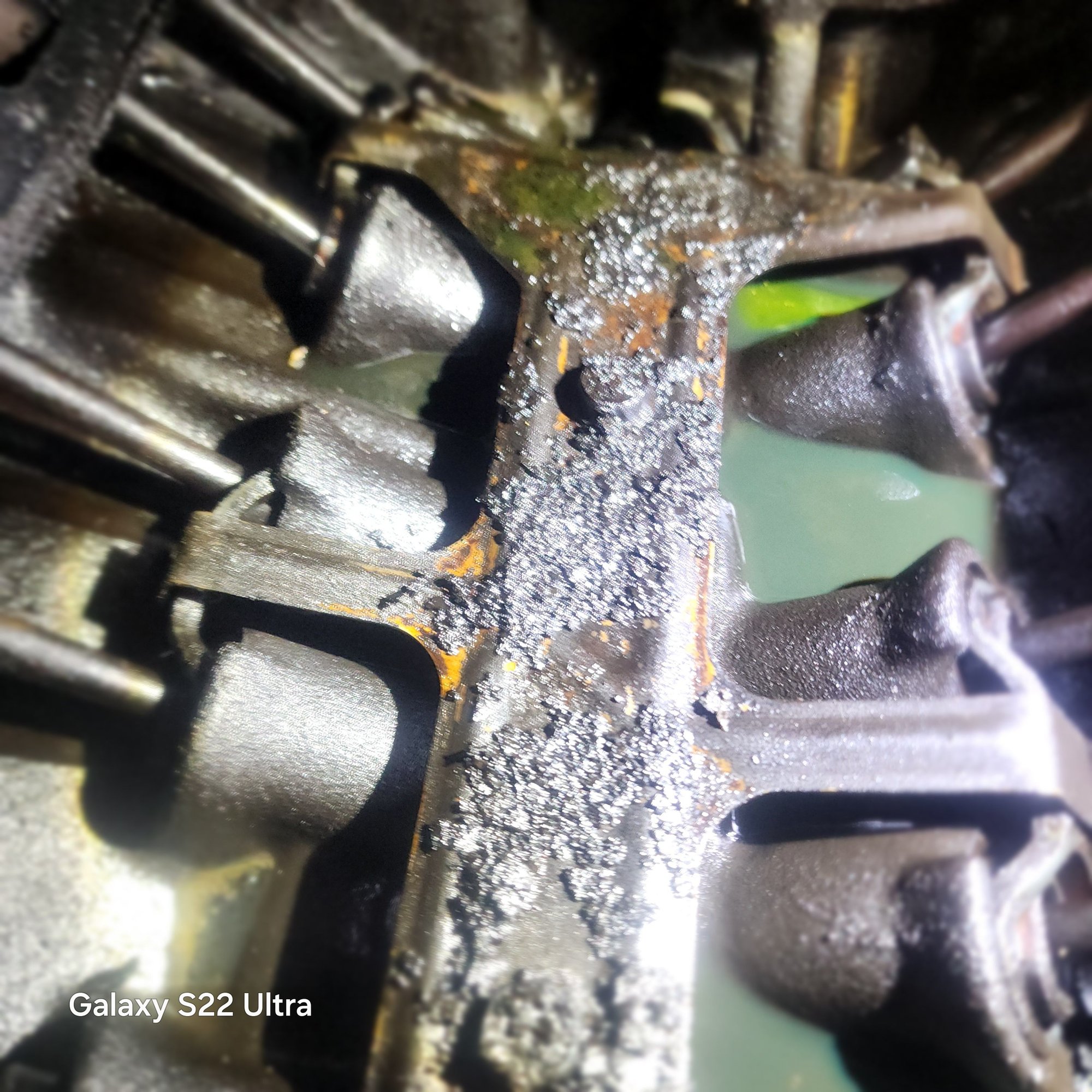

Well the plenum had one bolt broken on the frontleft or right sitting in the truck. But it had been able to seep air. And now the aluminum is rotted by the hole I'll include pictures the engine has so much carbon build up in it and doing a diesel flush just broke it all loose.

40 psi at start up and with throttles jumping to 60 and after the thermostat would open and water circulated pressure would drop to 5psi to low for the electric sender to read. It never chattered with valve noise could the oil have gotten stuck in the top of the engine from all the build up

I checked the dipstick prior to starting it and then I cranked the engine over and it wasn't starting but I grabbed the lipstick again and the oil level had dropped to about half way point between add line and tip of stick. So it's not returning as it should I think so engine running warms the oil and it flows better... idk it's got me totally frustrated. I have valve covers off is there anything I should do in there. Besides seals .

With that amount of stuff up top I would drop the pan and see what the pick up screen looks like. Bet you will find crud in it.
