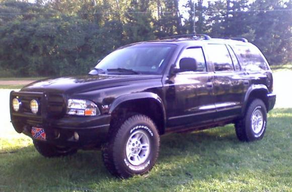

Here are a few pictures of my dingo (referred to as "the Durangho") after the 2"shackle lift and 33X10.50R15 BFG All-Terrians
Old Feb 13, 2011 | 02:10 PM
  #104
DirtyDurango's Avatar
DirtyDurango
Joined: Dec 2009
Posts: 4
From: Oxford, MI
oh and by they way... in the third picture the rear tire is touching the ground. just shows how much articulation is available without much modification haha
