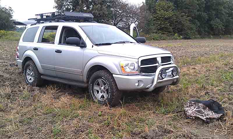

Default Torsion Bars
Just thought I'd attach a pick of my D after I raised the torsion bars. After I did it I was able to fit 32½" tires with no rubbing.

Nice looking rig man ! Do the Gen2 get the same shackle lift as well?
My shackles will be here today, but I can't work on it till Friday Arrgh ..
