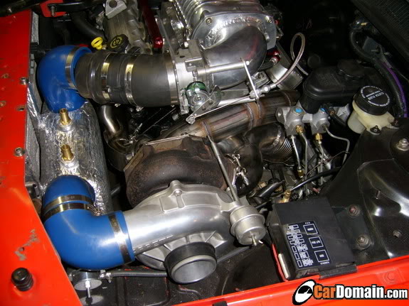

There are alot of diff ways to twincharge. Easiest is the turbo blowing through the IC then blower.
You would still need to rig up an electric clutch to dis-engage the blower because it will over-rev and start causing a parasitic drag on the motor via the crank
^It however is a BIG waste of money, I looked into it. People twincharge to get a nice linear powerband and on a FWD car such an initial jump in torque down low is all but pointless if you cant get the power to the ground. In the end the only real cool side to being twincharged would be saying (my cars twincharged)......
Heres a cool pic of a twincharged set-up
Iam already fighting for traction from the big torque gain down low from this charger. "Roots" type blowers are a possitive displacement blower, meaning theyr torquey lil ****'s lol
