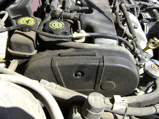

I have the same thing only for a couple of seconds on cold starts. And as the previous person I had all belte replaced along with timing. Also is that hole in the top of the timing belt cover supposed to have a plug in it or is it supposed to stay open?

pic of timing belt cover. It should have an inspectionplate that you can take off,no sure if you would call that a plug.

over time if the belt is slipping alot it will start to loose rubber thus causing it to slip more. sometime you can see pices of rubber by the pullys
EDIT if your timing belt was sliping you would have much bigger problems. Such as car running rough or not at all and in some cases bent valves.

mine is a 97 with SOHC and the timing cover looks different from that one pictured. However looking at the pic you have , the open hole looks about the size of the round part to the far right of the cover pictured. This one is also more laterally oval and mine is moe rounded straight up.
yes the one in the pic is from a DOHC, SOHC also has a inspection plate that can be removed. Its not needed but does help keep things clean inside and that canhelp the time belt last longer.
