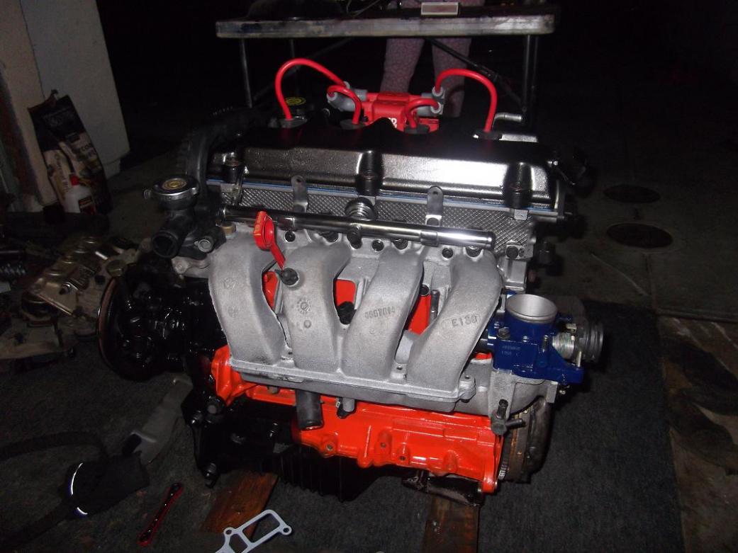

ok so first off i need to know if a dohc head will bolt and work on a sohc block but the tricky part is the sohc block is from a 2001 r/t and the dohc head is from a 98 r/t the only thing im doubting is the piston clearence. and also if i can use my old head bolts or i should get new ones. i know all the blocks are identical but still want to get others opinions.....thanx

yeah, everything should line up bolt-wise. not sure about how it would run though. as far as new or old bolts, you can never go wrong with new ones

today went and bolted the head up to the block timmed it and ran it through a cycle and good to go no interferance with valves so everything is good on that part and yes new head bolts will be in my near future

you can use the head bolts once after you remove them after that they should be discarded.

engine is done

its all together and runnin like a champ good to go
