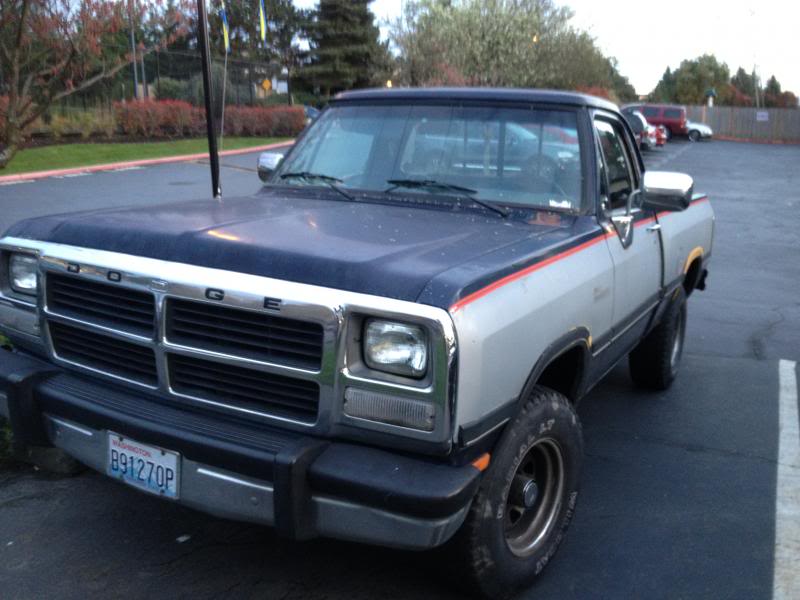

So I just got back from buying it. It pretty rough shape but runs good and amazingly the AC works. I wish it did in my truck haha. The key wont start the truck, something wrong with the ignition switch so there is a push button wired to start it. Couldnt find the ID tag on the trans but its gotta be the nv4500. Im gonna trust the manual on this one. All gears seem to shift fine, maybe a little rough. Reminds me of driving my dads truck. (1992 d150 5speed). Ive got two 92s now. Crazy enough, they even have the same mileage on them
Ended up paying 900 for it. Id say its a great deal even if I wasnt going to do a swap.

from the pictures i am looking at that thing looks like a solid truck to me. looks like it even has all the options that were offer.
i don't know if it will work or not but i think you might be able to take the a/c parts and heater box out of the parts truck and put it in your truck without discharging the system if you are careful. i am pretty sure the hole in the firewall should be large enough fit the pump and hoses through.
