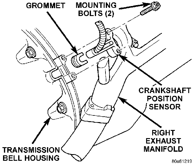

Default cant get to crank sensor its behind distributer cap at base of tranny and motor
i have no idea how to get to it and get off

It's behind the passenger head, Two bolts hold it in. You usually can get to them from the top of the motor. But sometime you have to go underneath to reach them.

Default ty for diagram
Its a pain in you know what to get to
