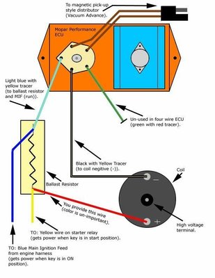

This is what Mancini Racing is selling today.... its cool they still sell it. I did a couple of those conversions back in the 90s, good to know the aftermarket is still strong... Like I said, you can assemble your own out of used parts on the cheap, but its nice that someone offers brand new stuff in a nice package. Links, pics and instructions below!
https://www.manciniracing.com/ma27331834033.html

^^^ Yep. That's all you need and it will run just fine. Slap in some new plugs and plug wires and you won't need to worry about ignition.

Summit had that same kit, used it on my 360 magnum swap in my 91. Pro-form makes it, but it's licenced by Mopar. No problems from mine. Easy install.
