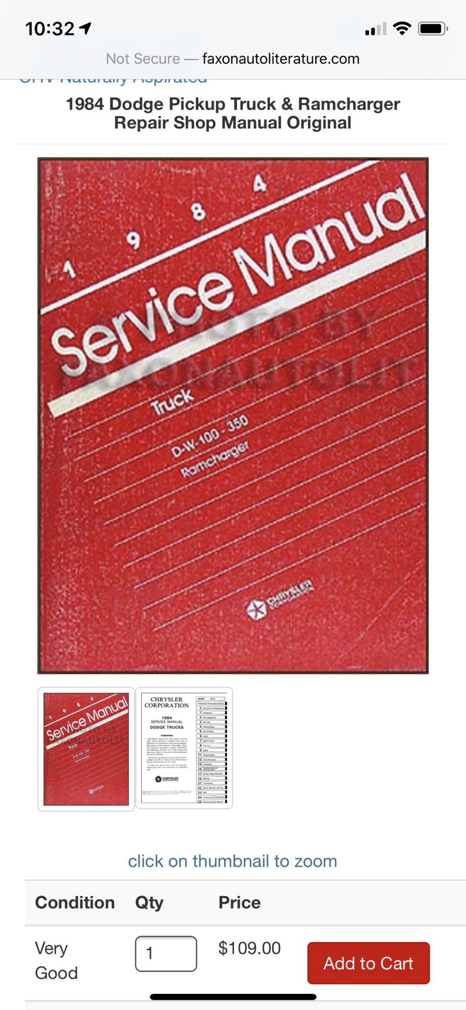

Here is a factory service manual for sale. Pricey but useful!
http://www.faxonautoliterature.com/1...al-P15858.aspx

yup they are not cheap which is why i have never bought one. i think you can buy a digital copy online for about $30 but never needed one enough to justify buying one. most of the time the 87 and older ones are so simple that you really don't need them.
