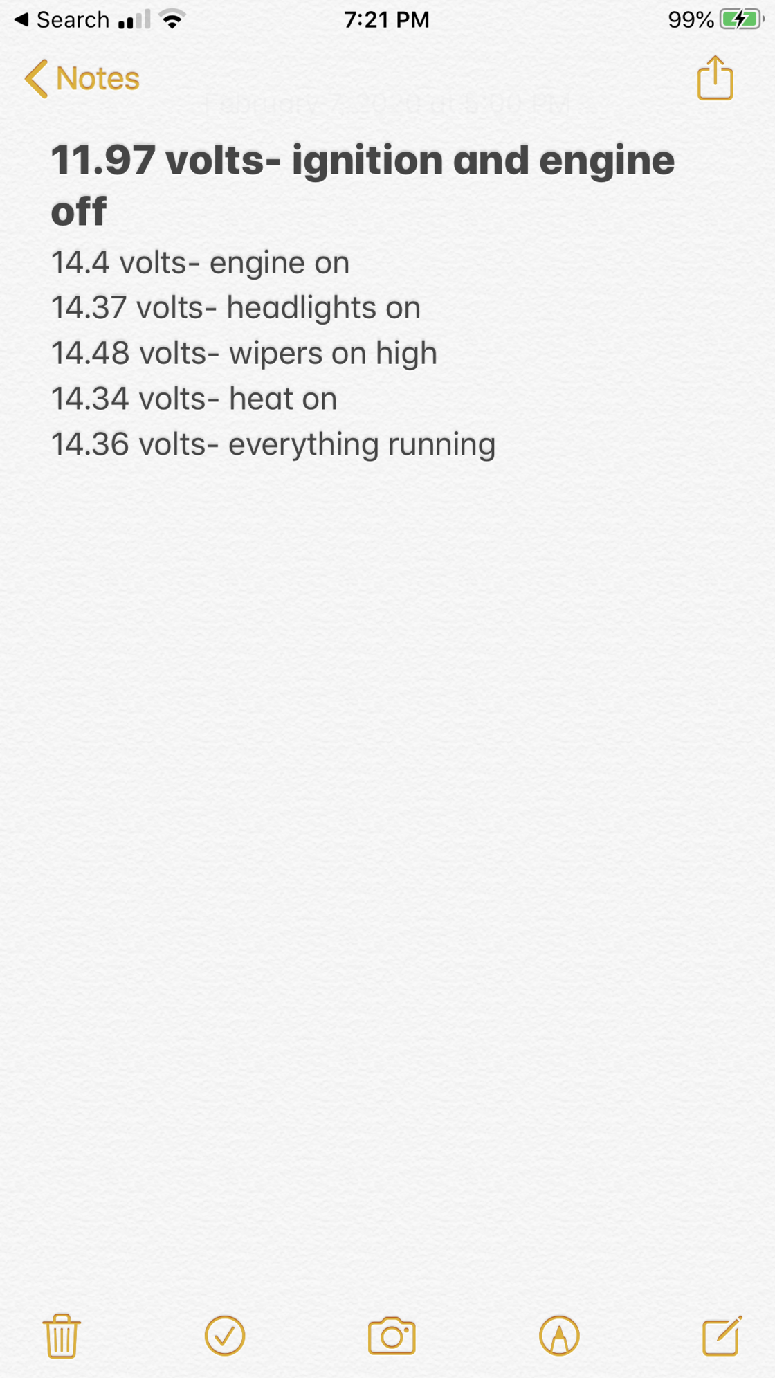

Maybe if the alternator is getting weak...... Would be interesting to see what system voltage was, as more things were turned on.
Do you suppose this looks alright?
Old Feb 10, 2020 | 07:26 PM
Posts: 87,480
Yeah, that looks just fine. Does the engine idle lower as you increase demand on the alternator?
