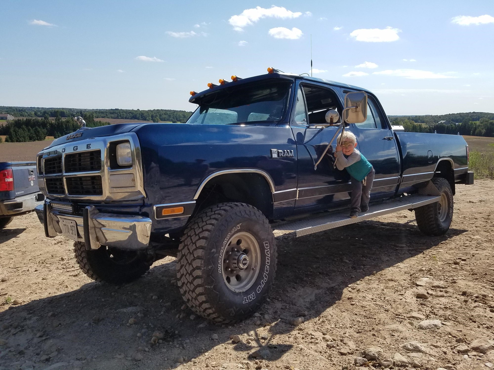

This is my summer runner.... '82 1-ton with Cummins swap...

So tell me, do you let him drive? He looks to be a year or two younger than my son was when I taught him. And yes, it was on a manual trans truck.
