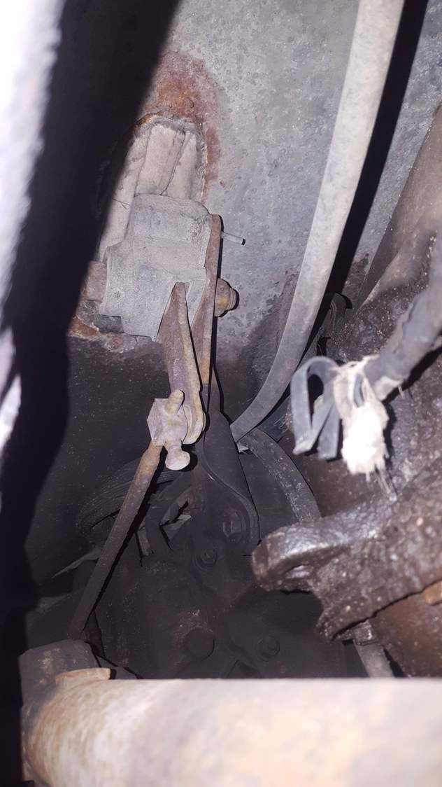

what about using the brackets that came off the 727? the 727 and 518 should be close enough to the same that they should work. maybe the bracket that came with the 518 was damaged or bent while sitting. i don't know if these will help you or not but some pics of how the 241 on my 89 is hooked up

do you know what transfer case you have? i would guess the support plate may not be work because it is meant for the newer transfer case and you are using a older one.
does your shifter bracket look like they ones i posted? i do got another picture of ones from a diesel with 518 but i know it has a different transfer case.
