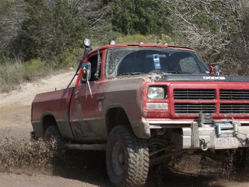

Old Dec 22, 2020 | 04:30 PM
crazzywolfie's Avatar
crazzywolfie
Posts: 8,025
Likes: 72
From: orangeville ontario
sixgun
