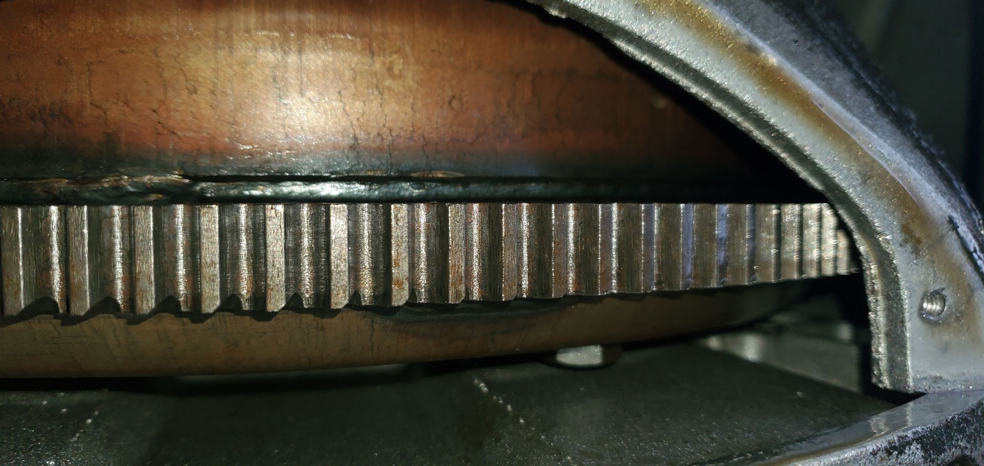

Hey guys any transmission experts here? So I'm not to familiar with transmissions at all. I took the inspection cover off for the flexplate just out of curiosity I wanted to see how it looks. My 46rh is mated to a 12 valve Cummins are these flexplates prone to failure because of performance mods that most people do to the Cummins? Everything looks good behind the cover at least as far I can tell I rotated the engine then looked and rotated it and looked and so on. I took a picture too so I'll see if I can get it to attach.

Old Oct 3, 2022 | 05:31 PM
Posts: 87,409
Likes: 4,214
46RH never came behind a diesel, likely a 47. They are fairly stout, and I don't think the flexplate is the weakest link.
Yea it's an a518/46rh non lockup. the a618/47rh didnt come out until 95 and was the first lockup tc transmission behind the 5.9 Cummins. The a518/46rh only had lockup behind the gassers. I'm familiar with their applications, but not the internals.

Given that the gas engines don't seem to have much trouble blowing them up, the diesel is likely quite capable of making extremely short work of one.....
Wonder how much work it would be to install a 47RH.....
Yea I would like to get it rebuilt, but brokey broke lol. Winter is coming up too so will be very limited to doing anything for my trucks. Trying to get everything done before it gets here, but limited on funds. A lot of guys use 47rh internals for the 46rh because they're 90% compatible. One just has a lockup TC of course I'm not very familiar with the internals other than I know the flexplate on the 46rh sucks and just about all the TCs suck.

I had 200K on mine when I sold it. Of course, that was behind a 5.9 gas..... It can last, if you take care of it, and don't abuse it too badly. Some nice upgrades available as well, but, spendy....... I wouldn't think it would be too hard to rig something for TCC...... maybe the third gear pressure test port, with a pressure switch.... Or something similar.
