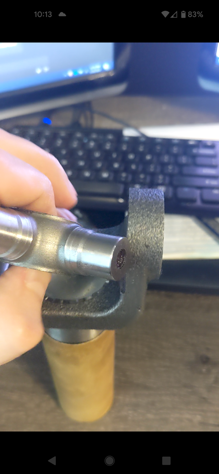

Yep no caps, best case scenario the joint body overlaps by maybe 2mm. But even with that small an overlap there's no overlap so any attempt to "force" the issue causes the valve to start gauging the surface of the yoke and bind up before even getting close...
I don't have the parts with me at the moment however I took a video which I can't upload of course but grabbed a still from that showing roughly how close it is

Try putting the u joint in from the top of the slip yoke and moving it around in different positions.

I've tried every direction I can think of, just didn't appear that way in the screen shot...sorry. I finally got the video converted to a supported format, I promise I try much harder with two hands just doing it one handed for the video to show the different directions I've tried.
