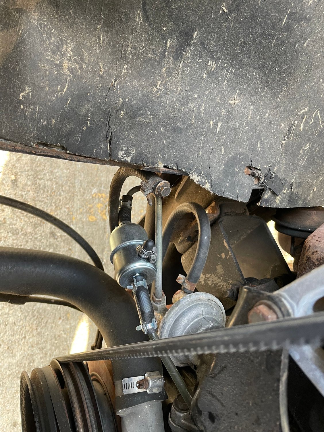

Think I figured it out!
I chased a few vacuum leaks, adjusted the carb with a vacuum gauge and set the idle with a tach, he’d idle beautifully but when I put it in gear, he’d stall and die. Started right back up every time.
I pulled the #1 and #2 plugs and was super happy to see their condition.
Convinced it was a fuel issue, I changed the fuel filter - again. Thought maybe I was pumping debris from the tank.
The I decided to see if the fuel was taking the path of least resistance and flowing back to the tank in the return line instead of pushing up to the carb.
I pinched off the return line with a vise grip and it didn’t die around the block.
so I disconnected the return line and capped the outlet on the fuel filter. This actually seams to have worked!

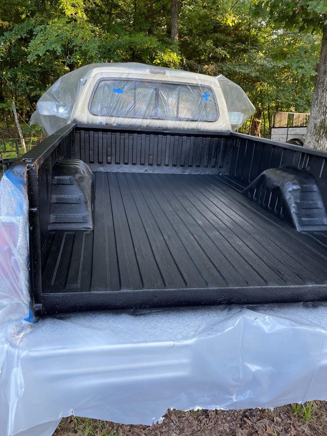

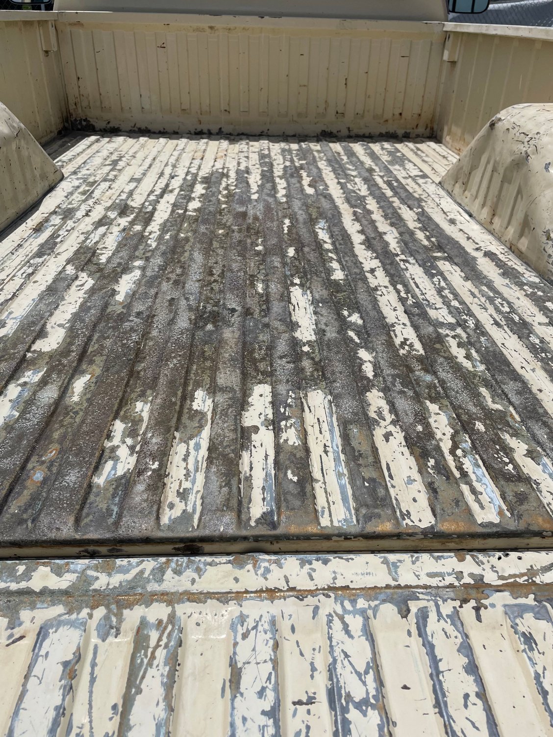

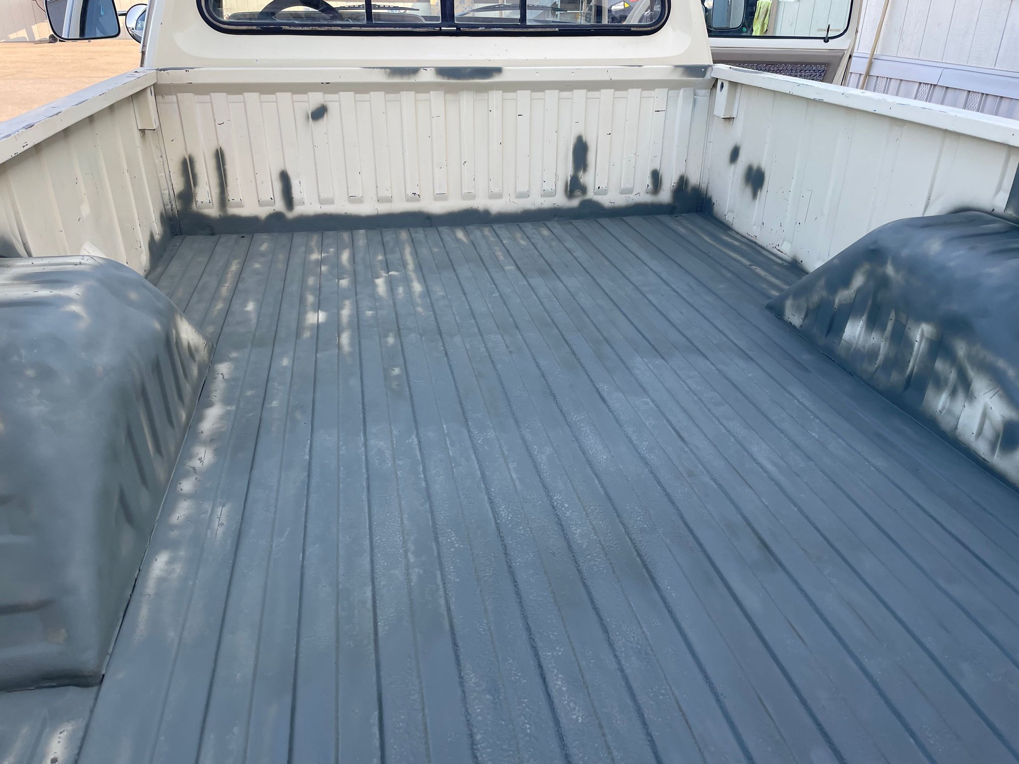

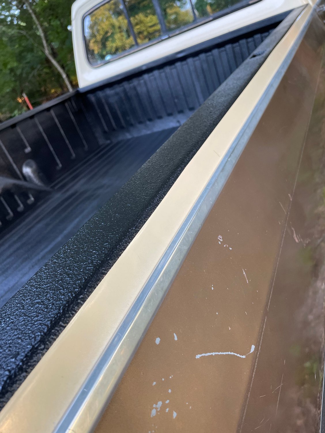

Next I decided to tackle the bed rust that can been in the previous pics.
I wire brushed it, and brushed on some Ospho. If you aren’t aware of Ospho - it’s awesome.
I primed the now clean metal and hand sanded the whole bed to prep for the Raptor Liner.
Really happy with the results. I used the 4qt kit and is was enough, but really would have liked to have one more quart for a little heavier coverage. I went over the rails and used a tape from Amazon with a little wire in one side for a clean edge.
Progress pics and finished bed.
