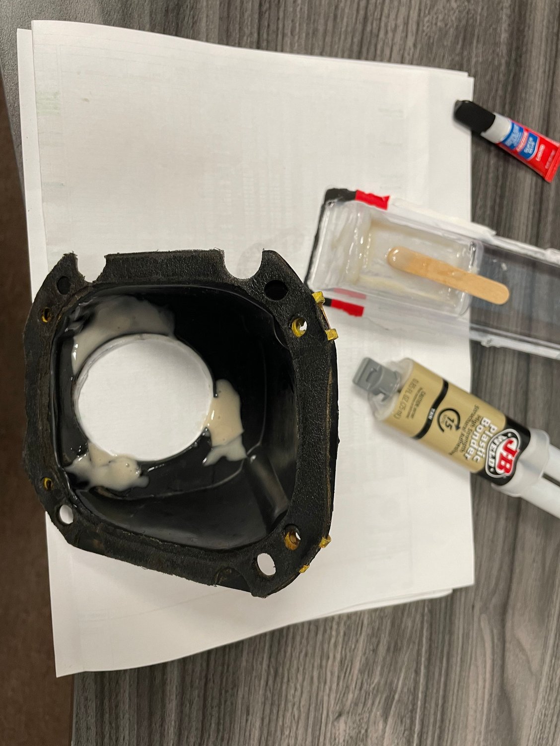

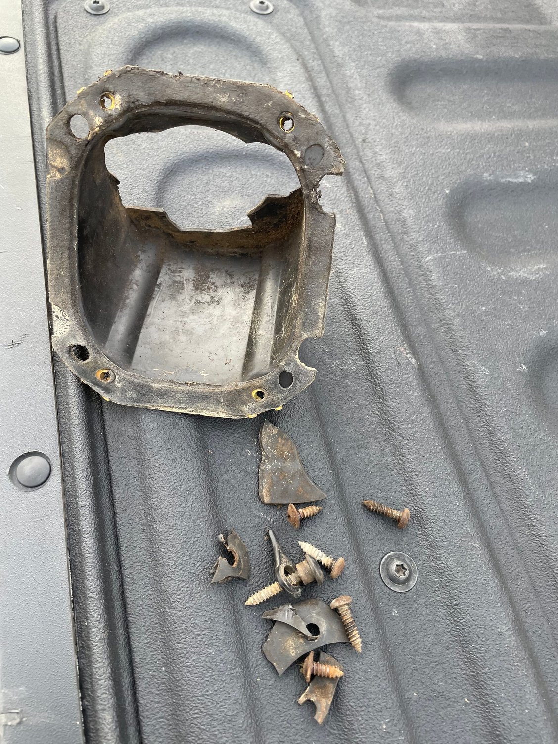

When I went to fill up Gus’s tank, the filler neck was just flopping around under a broken neck bezel. So today I was able to get what was left of it out and started attempting to reconstruct it. I cut a piece of a bucket lid for a backing plate and super glued what pieces were there back together. Then I filled the holes with some two part plastic. I then ran a full bead on the JB plastic around the hole and let it set until tomorrow. We’ll see if that works…

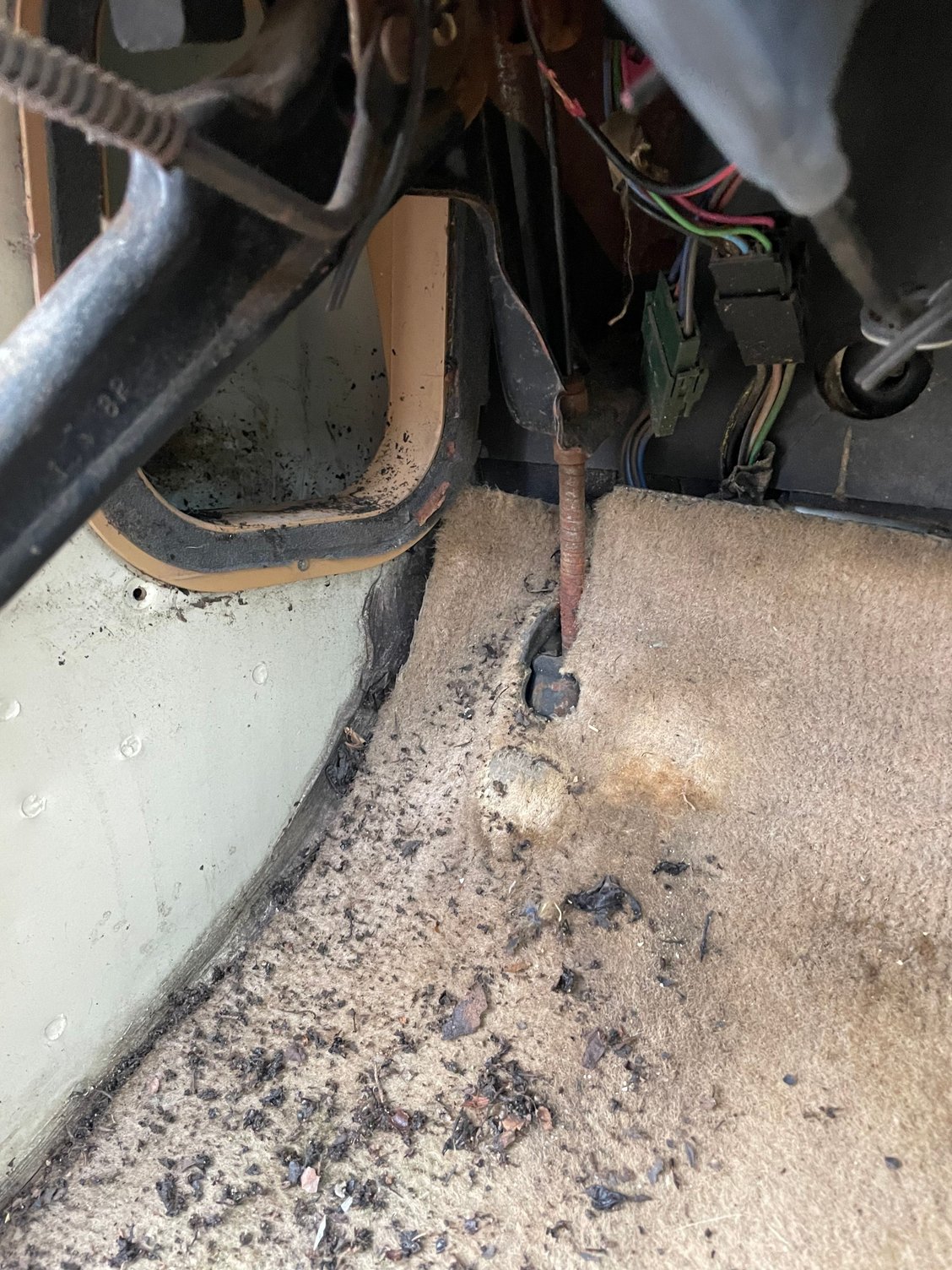

Started on the interior cleanup and found this … in the driver’s side vent
Three FULL handfulls of debris, and one hornets nest.

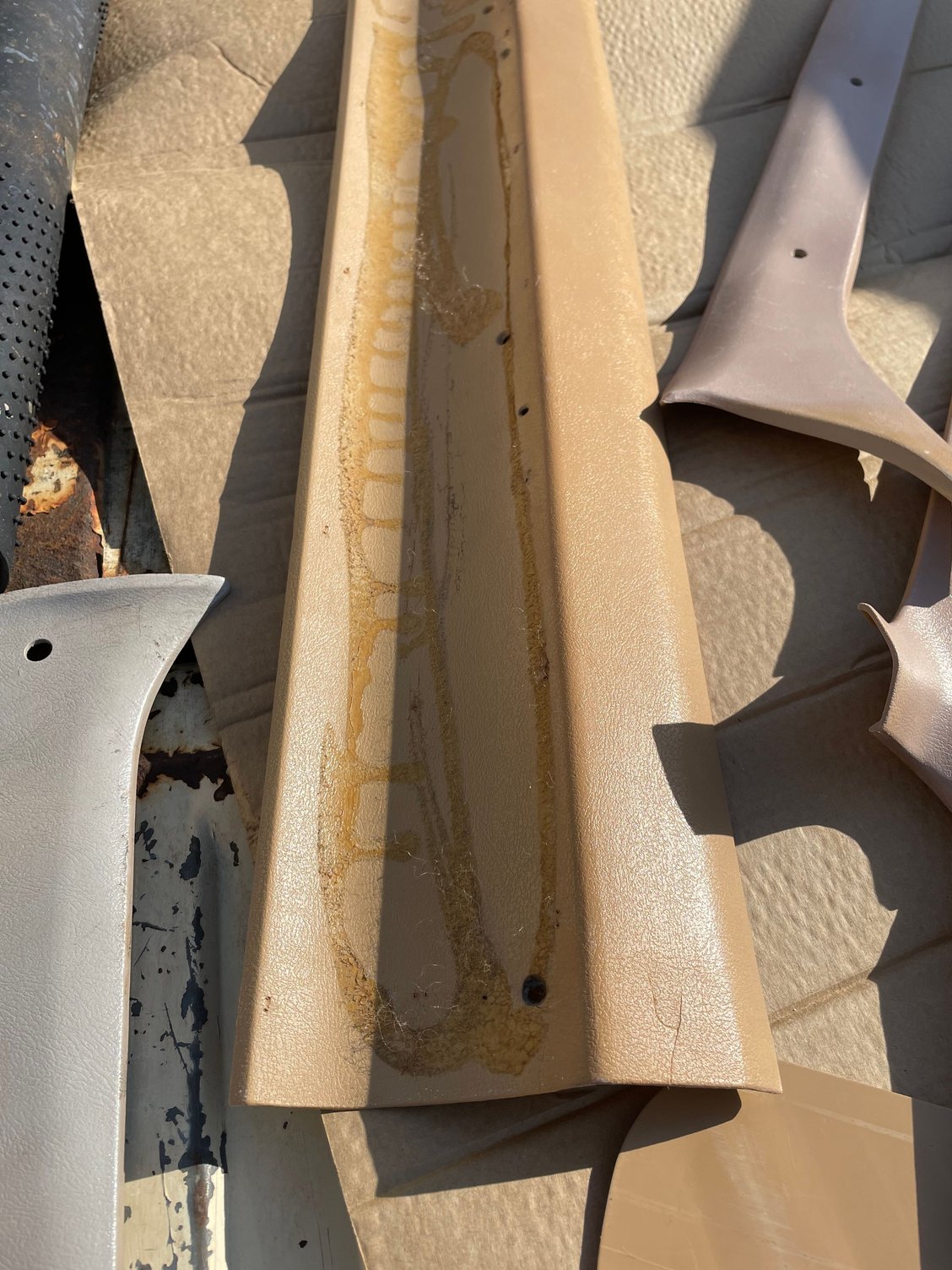

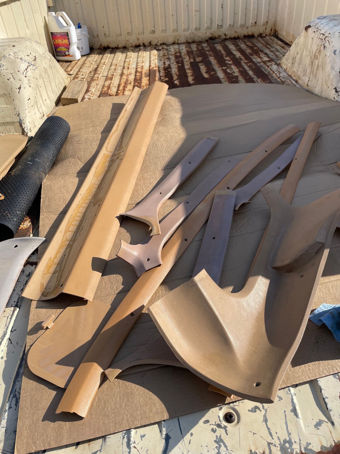

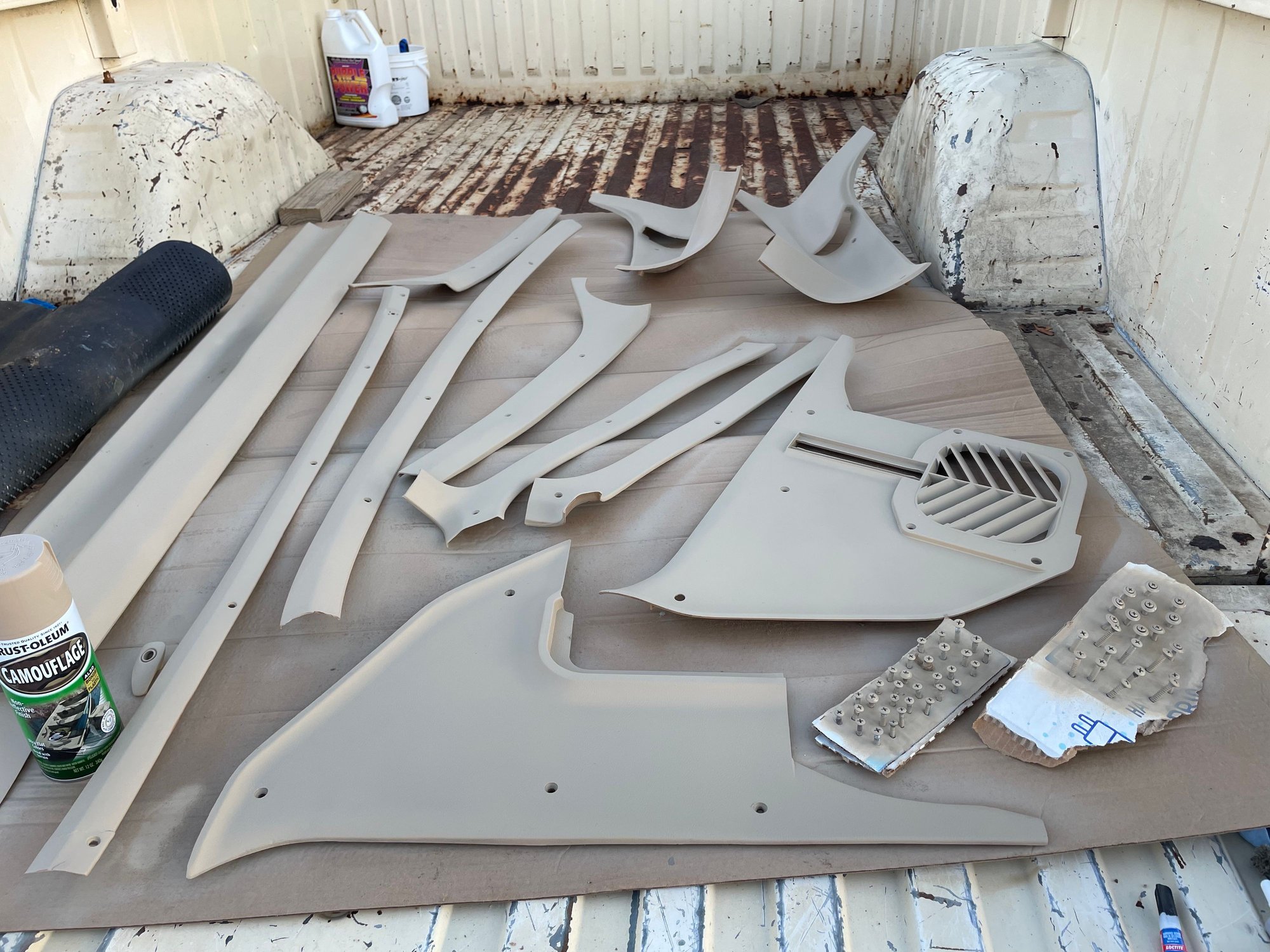

I didn’t take any “before” pics of the headliner but boy was it bad. Kind of a weird orange, brown foam dustish stuff.
the pic below shows the interior plastic trim and how some of pieces really faded while others actually look like they darkened from front to back. The piece under the rear window, behind the seat, had a piece of carpet type stuff glued to it.
Cleaned with Brake cleaner and a brush, then painted with plastic adhesion promoter and some Rustoleum camo paint in desert tan.
Very happy withe the results.
