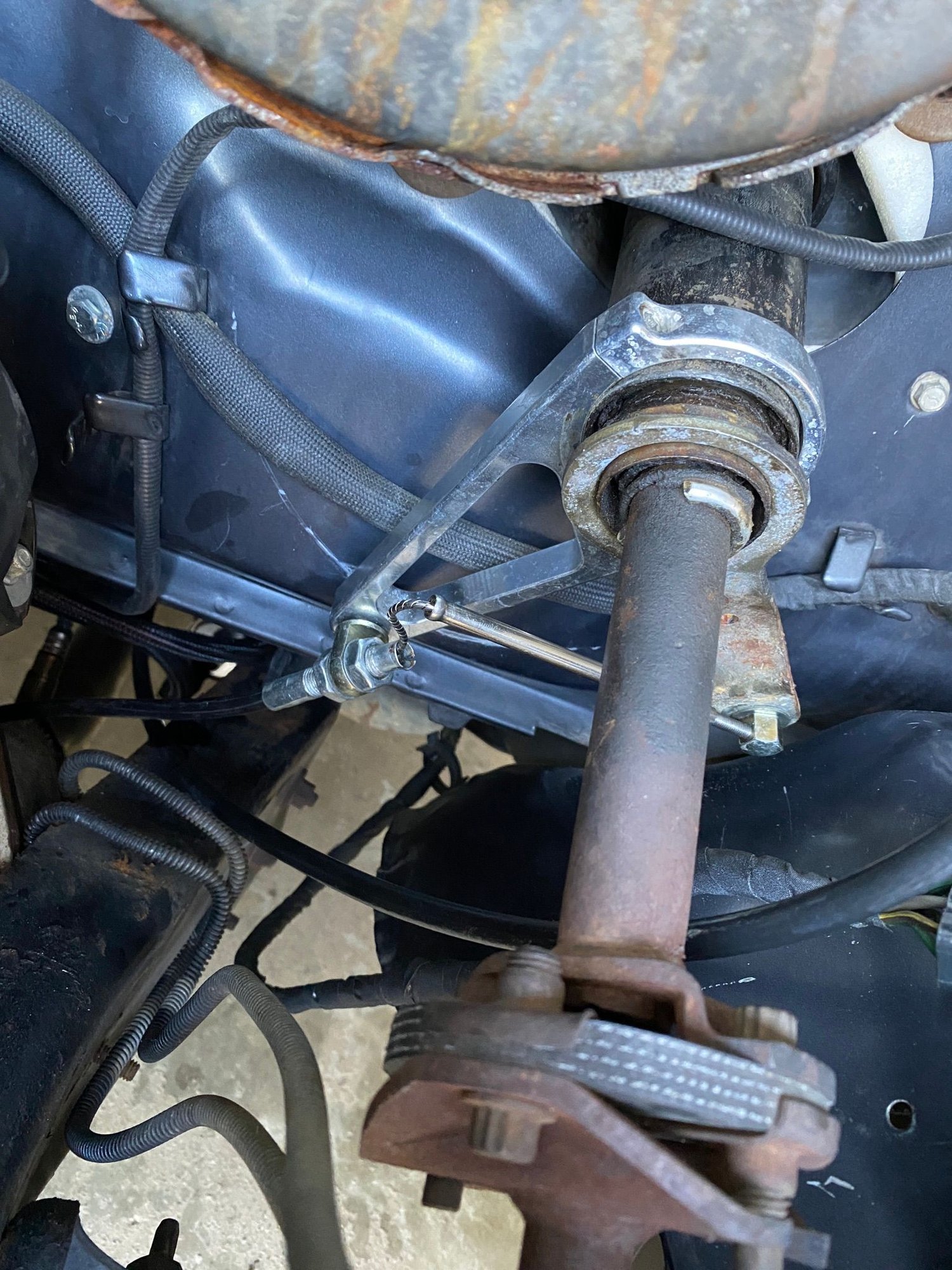

Yeah , it will be turned off in summer to help AC temps mainly was the idea. I was shocked at how much heat was reduced from the heater with the cold weather when it’s closed. Cabin controls still operate the “mix” with the blend door like factory. I really dislike the cable operated valves ones as well since they just add more junk under the hood. Yup that exhaust got me too. The brake lines I was able to move them over to clear and it actually was rubbing frame previously on the last motor mount position but has some clearance now. The previous pics show before it settled more. Of course I’m in a rush to get the truck backup and running so I put the old fans back on and got it up and running. Starter snapped off a post so had to get a new one. Setup my crazy shifter cable again and it must have dropped down and melted to the exhaust. Was having difficulties with shifting and couldn’t figure out why -then cable finally busted.
Busted shifter cable.
Replacement part.
Replacement part.
Called lokar and got a replacement cable. Should have checked eBay since the whole kit (probably a copy) is half the price than just the cable. New one came in and I reworked the cable routing and set up the shifter again / also header wrapped the exhaust in that area to prevent any more melting. Shifting is really smooth now with positive clicks through P,N,D,1,2 . Finished up the AN lines for the trans too and they came out super nice.

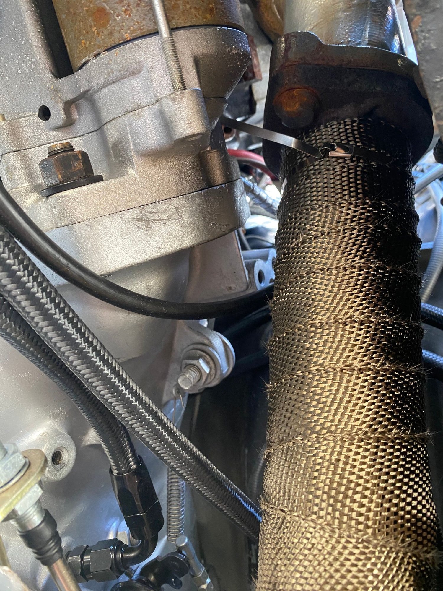

The blasted shifter cable was laying on the exhaust and even with it wrapped it had started melting it again, at least not to the point of failure.
Ended up wrapping it in some starter heat shield from the parts bin and secured with a couple of metal zip ties on it since it obviously wants to live on the exhaust.

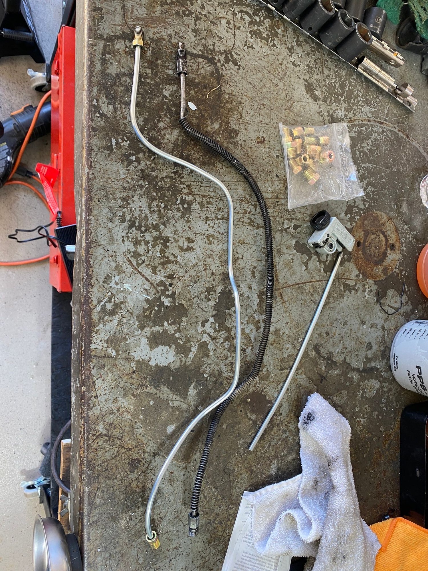

Something that has bothered me for the longest time was the sound in the cab. It’s not like drone but it is still very loud even with all the sound deadening I have done. Dumping the exhaust right behind the cab was always meant to be a temp situation anyways. First off tho I have a brake leak to deal with. Keep having to fill up the master cylinder and can now see clearly both rear wheel cylinders are leaking. No big deal easy swap right… until a brake line twists off like a twizzler. I ordered some line and fittings off Amazon and figured I would make a replacement easy enough.
I’ve never made brake lines before so wanted to give it a shot. Bent and flared using the correct size new fittings no problem but when attaching it to the truck I noticed I couldn’t tighten down the hose to the connection on the rear end. The new fittings didn’t have enough thread to clamp the hose so I cut the one end off and used the old fitting and re flared the end. Success except now the other end on the wheel cylinder (I thought was tight) is now leaking. I didn’t have enough hose to cut it again and use the other old fitting so went to plan B. Found a truck in a local yard and snagged its line to replace mine. Now no leaks and brakes are working I can get this exhaust sorted.

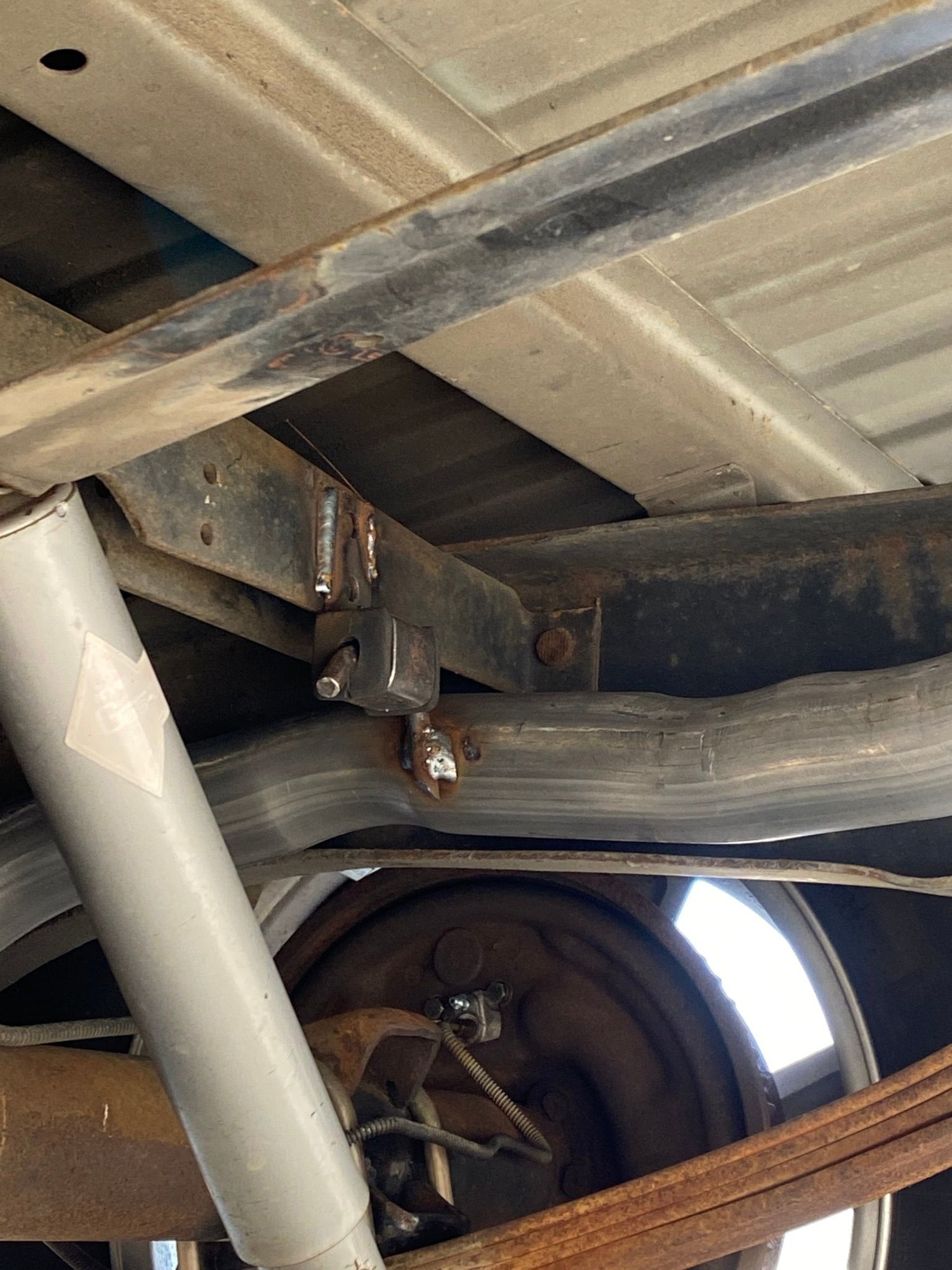

I got the exhaust extended up over the axel. The old hangers were ripping off the muffler so it was definitely a good call to fix it up and get better support. It’s still tucked up high and out of sight from the rear but it did exactly what I wanted in the cab. The sound is so much better in the cab, quieter and less rattle but in a good way. Definitely still sounds like a beast. Should have done that a long time ago.

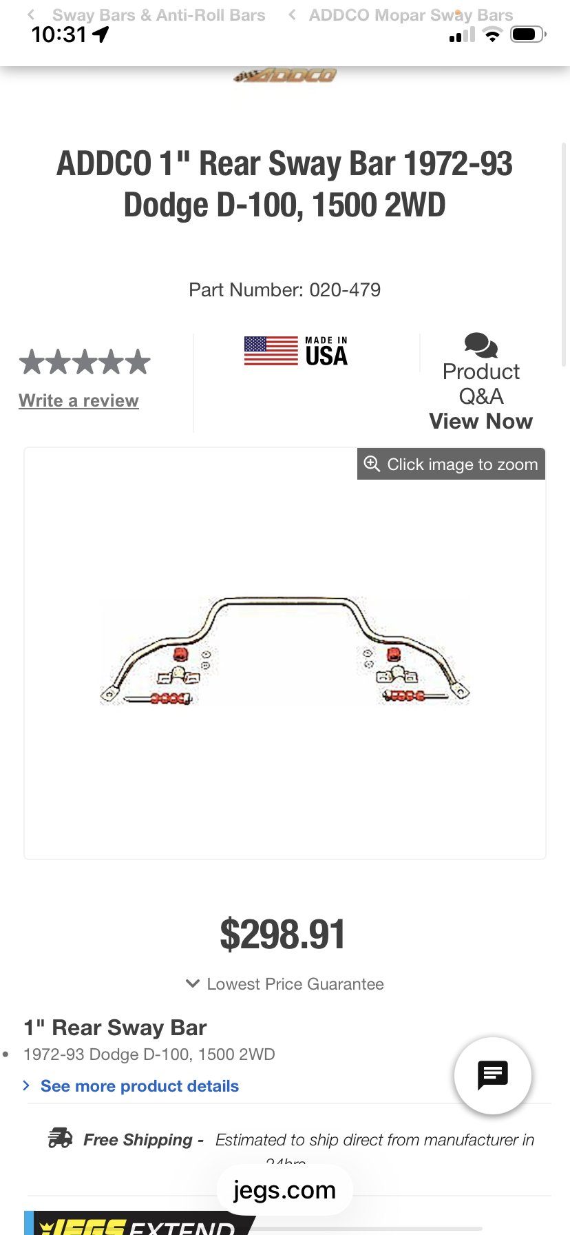

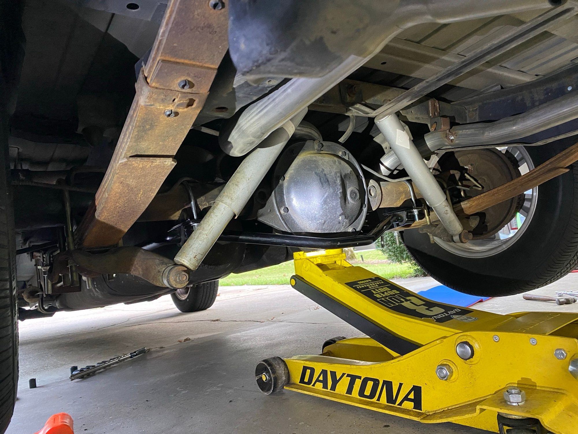

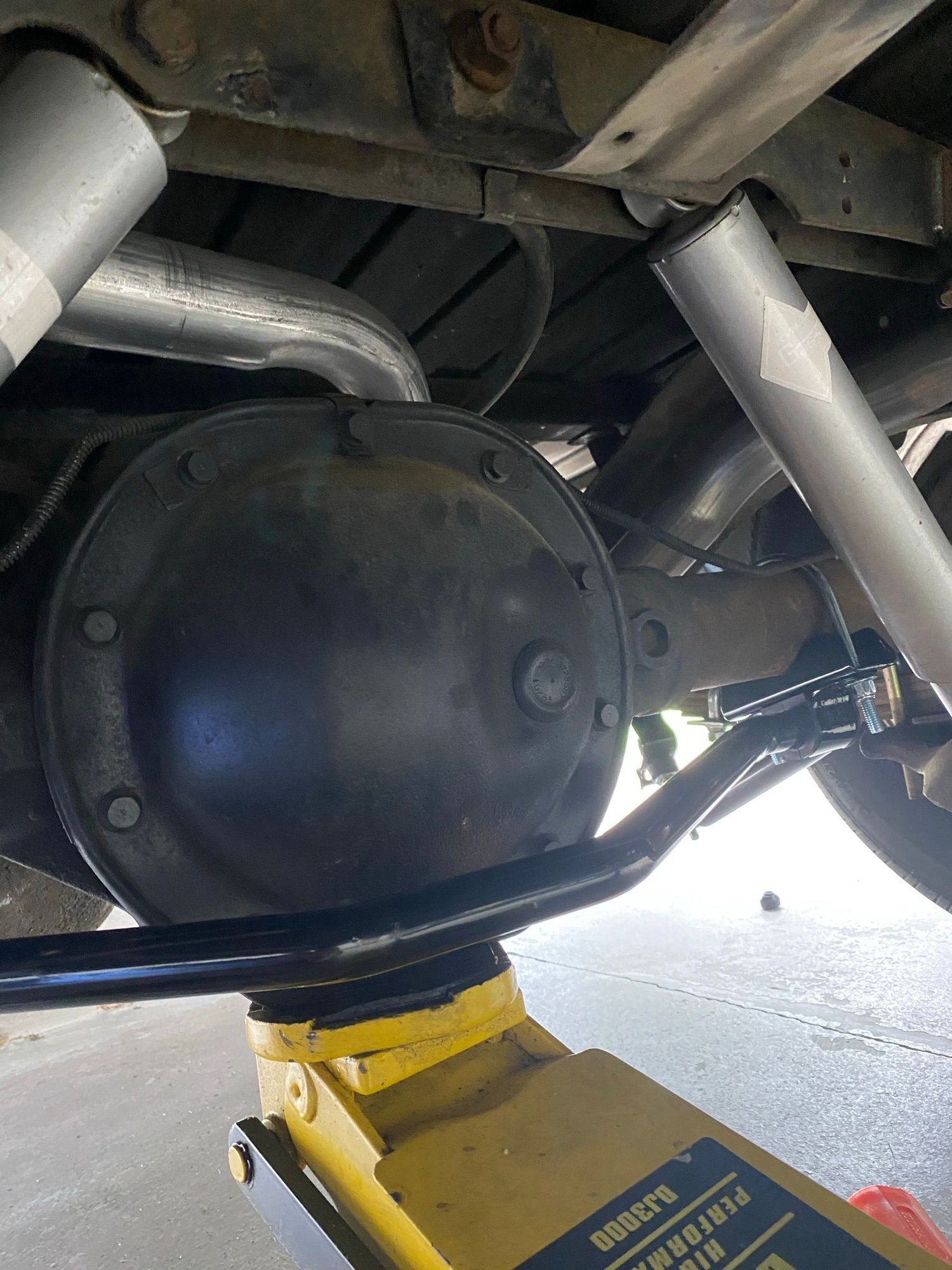

So it’s been a while but I’m not done with this truck yet. When I was under the truck I realized I still had a few things to do. Picked up this rear sway bar.
This will finish off the suspension upgrades and match the front. Install was pretty straightforward although drilling some holes in the bottom of the frame is required.

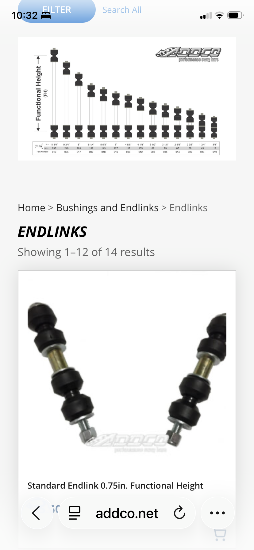

there was lots of mocking up to get everything centered and lined up to see where to drill. Of course since the trucks lowered the supplied end links are not the right size for correct alignment. Luckily addco has a nice selection of end links on there site.

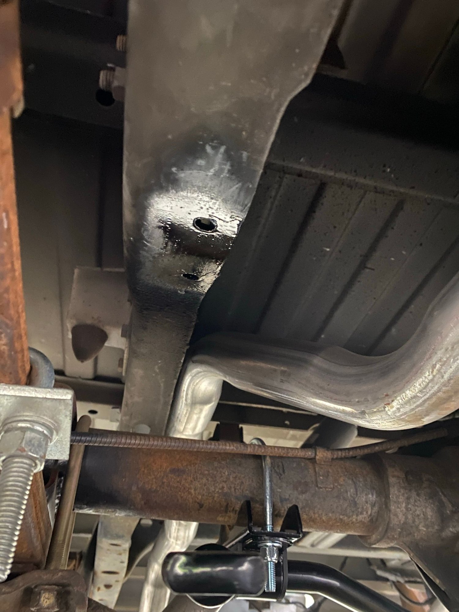

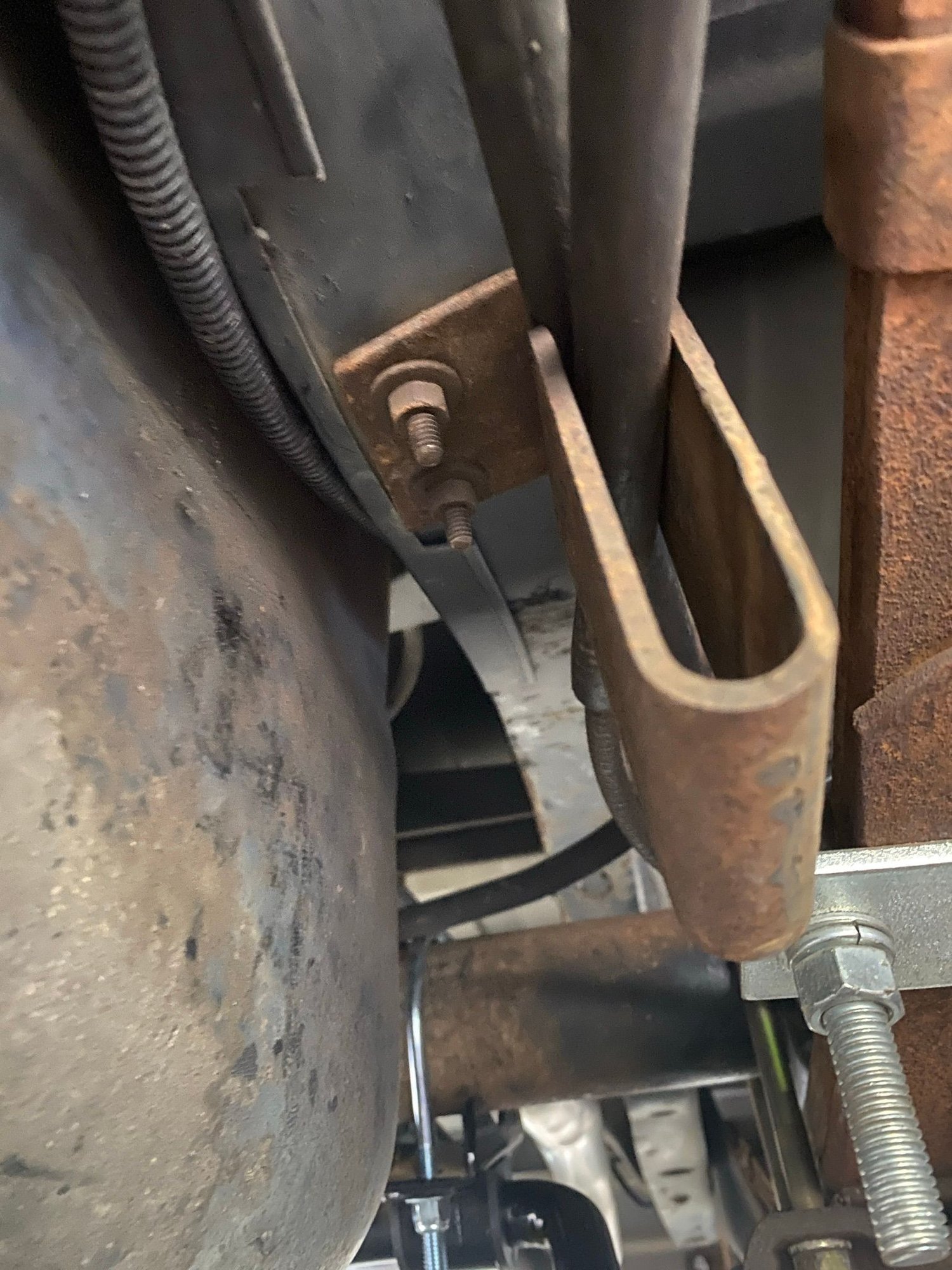

The bar end line up with this bracket on the drivers side so I was able to use one of the bolt holes.
passenger side frame holes painted up to prevent rust.

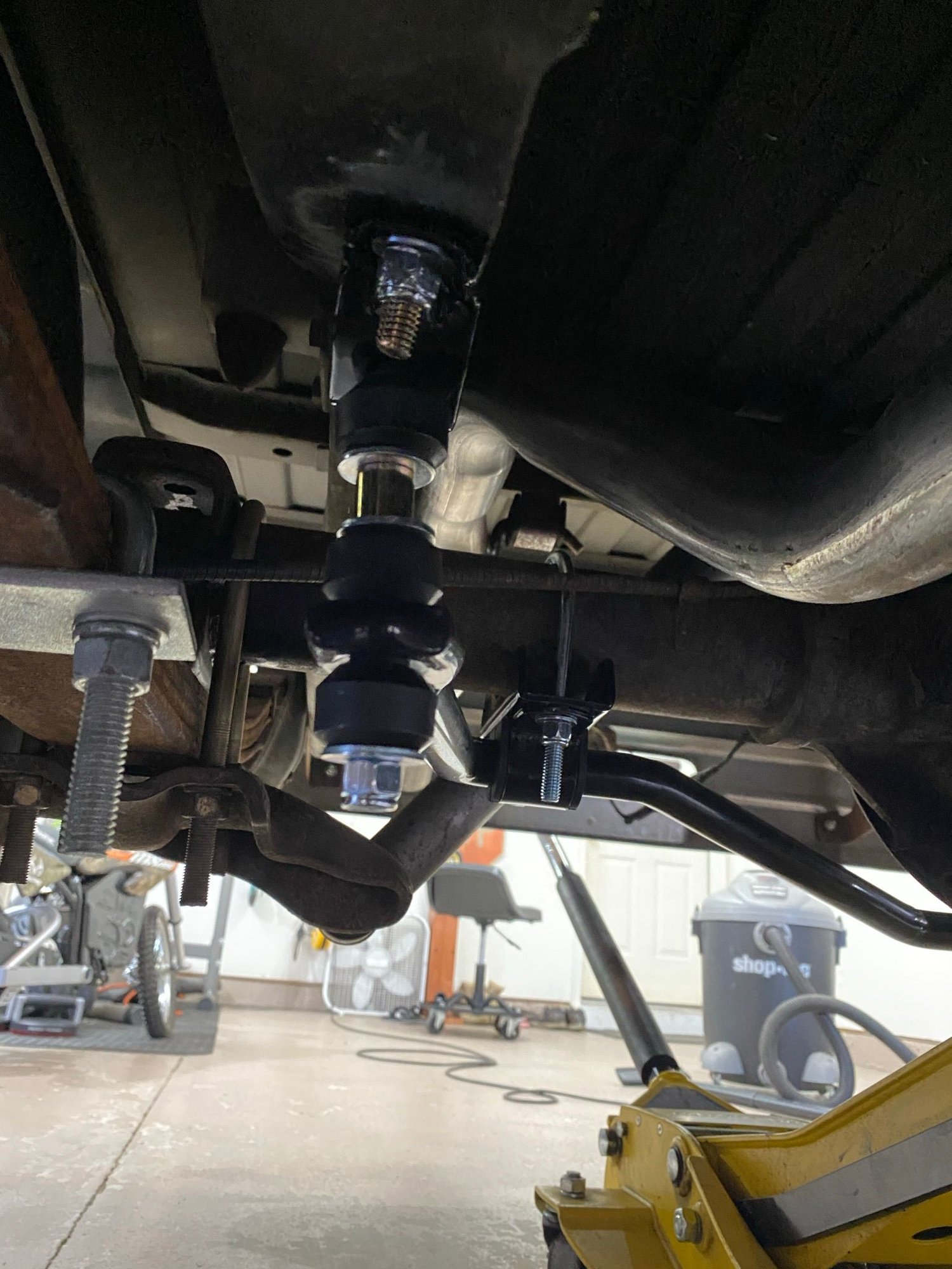

New shorter end links loosely attached.
I ended up using the 2.625” end links but would suggest you measure your own if you are doing this. These put the ends of the sway bar horizontal and parallel to the frame. Handling has improved once again. Definitely a worthy upgrade that I would recommend.
