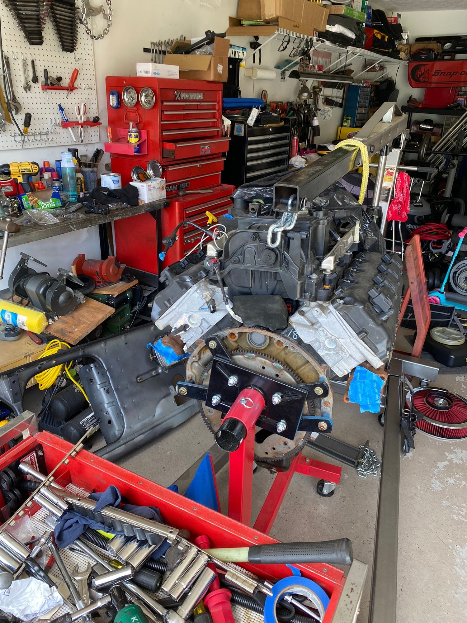

The plan is for a 5.7 hemi . It’s a 2016 motor that I got form a trusted local guy. It was in a truck that got hit from behind and wasn’t running at the time. I know it has an oil leak in the pan but it only had 16k miles on it and they found the leak only from driving it up on the wrecker. I’d love a 6.4 but the only ones I’ve seen were 4.5k with 100k on them vs the 2.5k I spent on this one.
one last look at the magnum cleaned up. I actually sold it for 2.5k as well - so far it will be an even trade 🤣 (not for long). The plan is to use all holley stuff available for the swap and rebuild the 46rh that’s been collecting dust in the garage from the magnum motor as they can bolt right up to the 3rd gen hemis. Even the current setup has desperately needed OD with 3.92 gears. Time to start ordering parts.

I got the 5.7 on the stand and flipped it to put a new pan on.
Drained and flipped.
Damage close up
Pan off
It’s worse than I thought - small piece of metal in the pan and the crank has been dragging on the windage tray part. Seller is covering the pan as well as a new srv actuator as these were the identified damaged parts. It didn’t include power steering (was electric) and no AC comp either so I will have to source those.Plan is to seal it and just send it !

New pan on and fixed the cracked SRV valve on the intake. Ordered holley headers, terminator x max, motor mounts, hemi swap mounts, trans cross member and adapter for the 46rh. New trans mount too. Tore the truck up once again. I learnt from the last swap to drain ALL fluids first 😂. While not absolutely necessary I would always advise to remove the front end. It makes things so much easier especially when adjustments might need to be made or parts don’t fit.
Front end off.
5.7 on the stand still with missing srv actuator.
