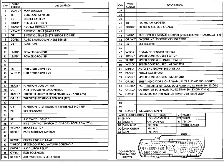

if it truely is a 91 computer it is only firing injector 1 and 2. definitely seems like a fuel related issue if it will fire with gas in the intake.
so the 91 computer only fires injector 1 and 2, and 92 and above fires all of the injectors?

If cam/crank signals were "too wrong", the PCM might toss a code, but, the PCM has no way to know which cylinder is next in firing position, it only really cares about which injector is next. And it only gets a vague notion on that...
However, if the OP has a 91 computer in there, it will NEVER run that engine. The programming is so wrong, it's almost funny. First thing that needs to happen is the correct PCM needs to be installed.

here is the pinout for a 91 computer
and here is the pinout for a 92/93

I guess I'm buying a 92 computer. Hopefully that fixes it.

Do you still have the original pcm? It should have a # on it. That is what you need to get. I'm surprised it ran on 2 cylinders!
