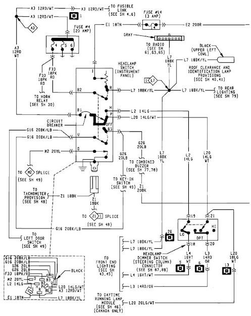

have you also checked the dash light fuse? also test for power at the fuse but make sure the headlight switch is on. this will tell you if power is making it this far or if you possibly have a bad headlight switch.

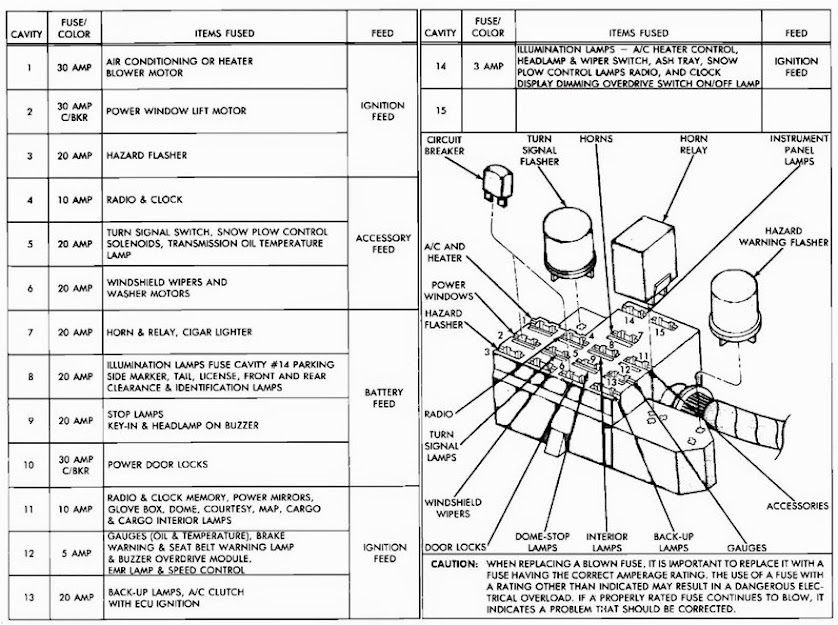

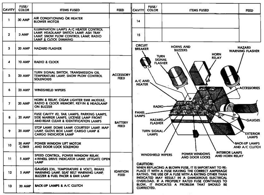

All fuses are good. Looks like Cavity #2?

ya. it should be a 3 amp fuse. power come from the switch to the fuse panel then out to all the lights in the dash. it is possibly the potentiometer has gone bad

It seems I have a Cavity 14 where your diagram shows none. Cavity 2 for me lists Windows and has a 20 AMP fuse.

purple fuse at top. instrument panel lights fuse. looks like 87 they changed that to this. i got this listed as 88/89

Zero volts to the instrument panel fuse!

would that happen to be a broken wire in the picture you posted? if so is there power at it that varies based on the rotation of the headlight switch

Not a wire, just a stranded piece of tape from years gone by. The two wires underneath Cavity 14 look like they’re in the appropriate spot.
