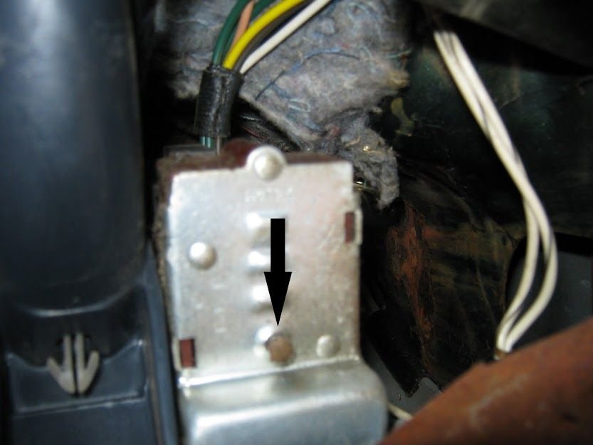

if you have had the dash out that is most of the work there. this button is on the bottom of your dimmer switch is the other tough part. you have to press on it extremely hard to get it to release the **** to turn the lights on. sometimes you got to push the **** in and out while pushing the but it will release eventually. then you can remove the screws and disconnect it.

For anyone else doing this job: give the headlight stalk a little shot of PB Blaster and let it sit a few. Use a nickel on the pad of your thumb to depress the plunger to pull the stalk out.

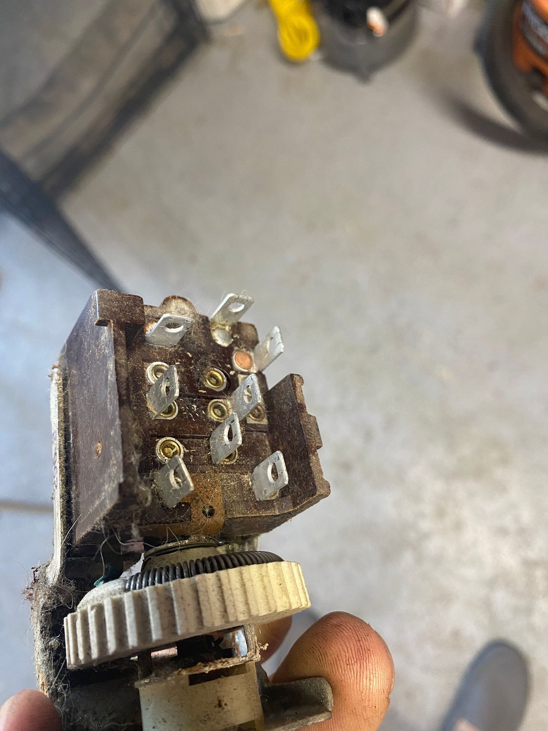

told you the button is hard to push. i almost wonder if a good cleaning might fix that switch. doesn't look too bad other than being very filthy.

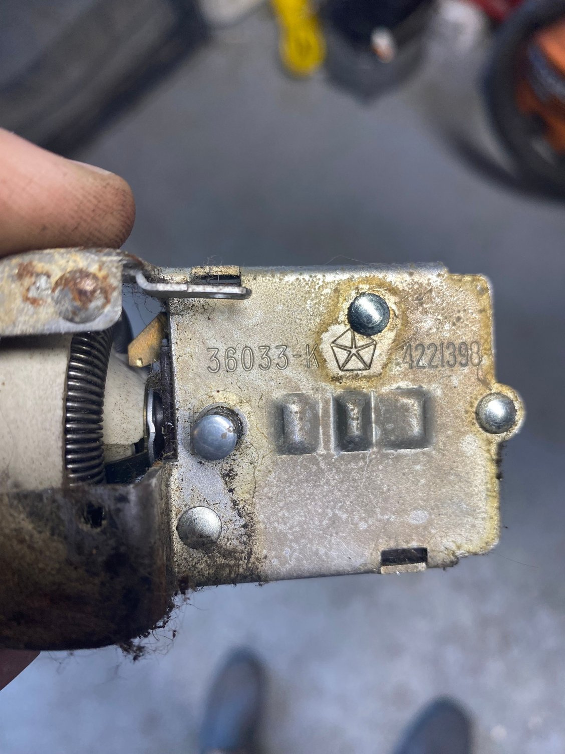

I was thinking the same about the cleaning. The contact for the dimmer looks very corroded. I have a new switch on order ($25). The new switch is a 9 pin, this switch is an 8 pin, but the website says it’s compatible with this part. I wonder what the 9th pin is for and if my current harness will fit!
What’s the connector on the back?
