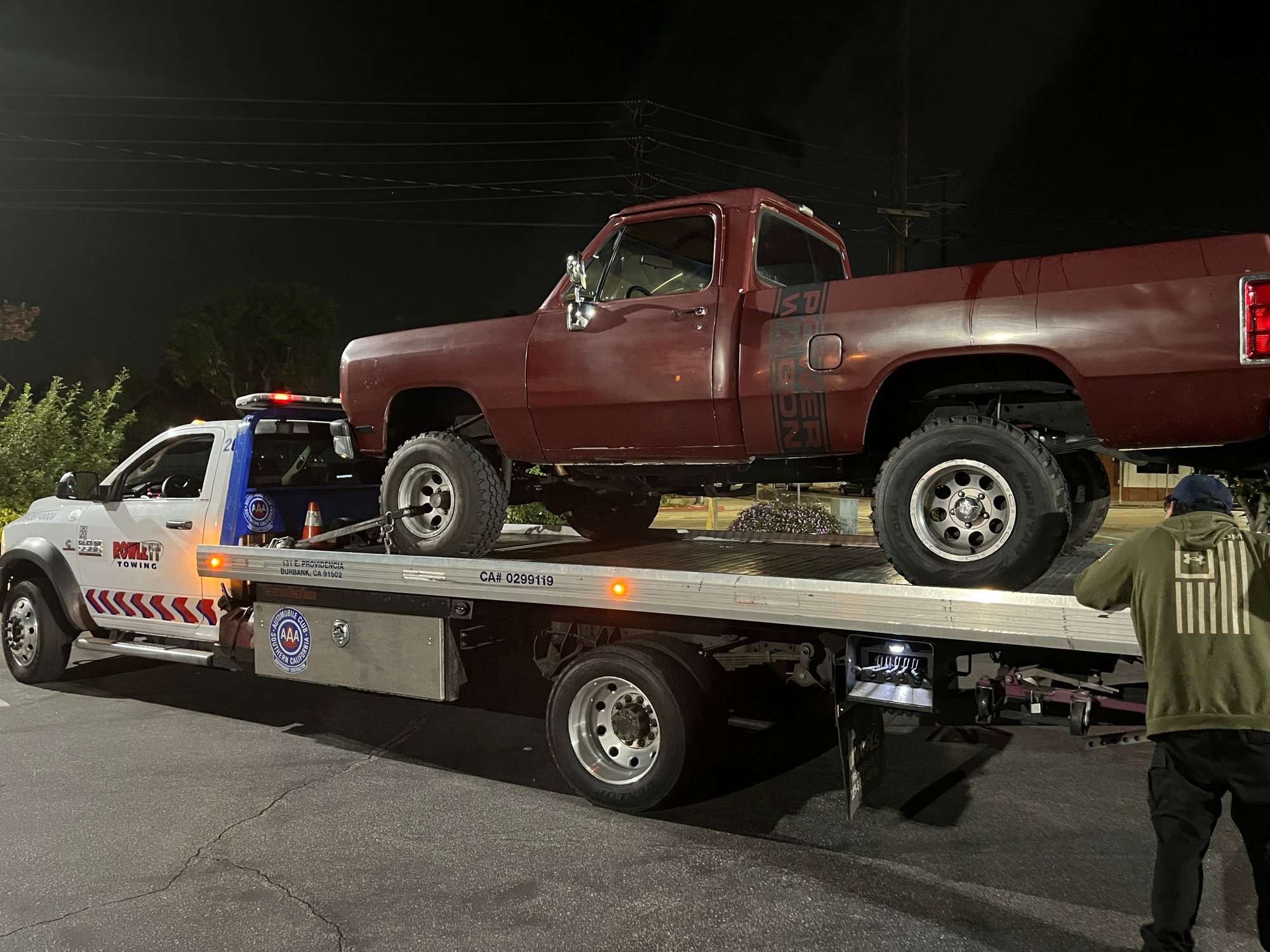

Well that wasn't the problem apparently. It also took AAA 4 hours to get a towtruck to you in Burbank CA. Cranks over, no spark. I checked with a meter and the ignition coil is not getting power with key on or cranking. Anyone with ideas please let me know where to look. Thanks

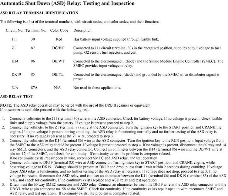

how are you testing for power? have you also checked for power at the asd relay? i would also maybe suggest trying to bypass the asd relay for testing purposes.

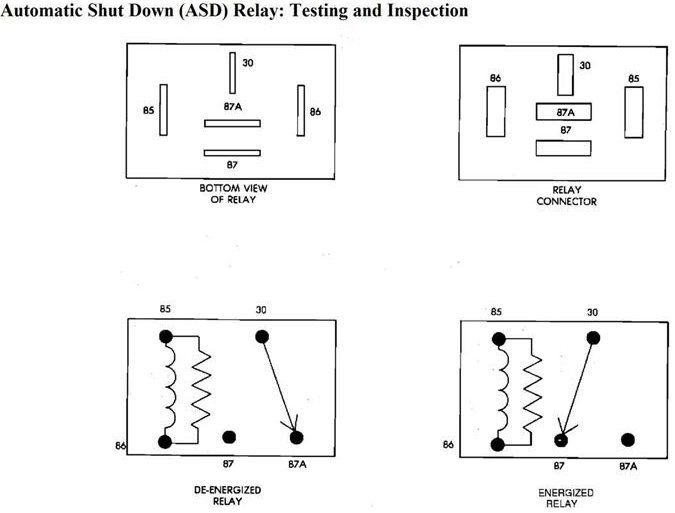

As fas as the ASD, the relay works and gets power with key on for 2 seconds on pin 87, then shuts off .The fuel pump relay has power and works also.

if it was a bad ignition switch you should be able to bypass the asd relay and get it to fire up when you have this issue happen. i would almost wonder if you had a fusible link going bad. it is fine when cool but craps out as it has power flowing through it and warms up.
could also install a couple test lights in the cab connected to the asd relay and see which of the 3 is cutting out.
