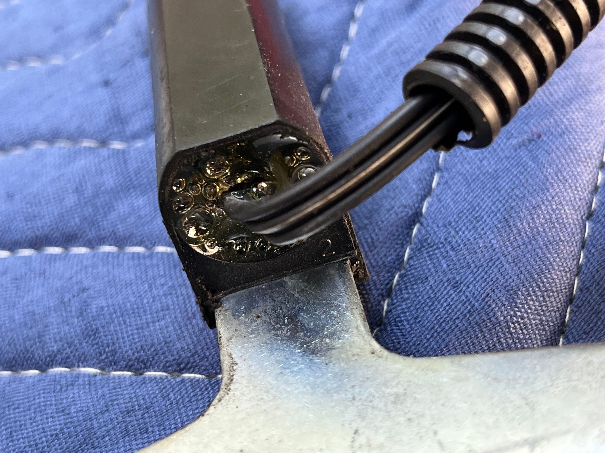

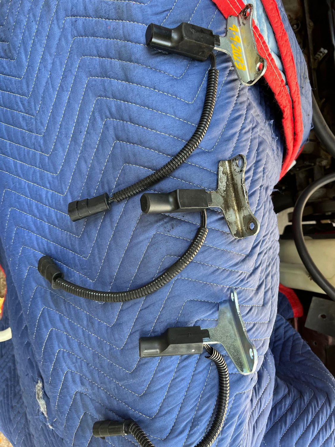

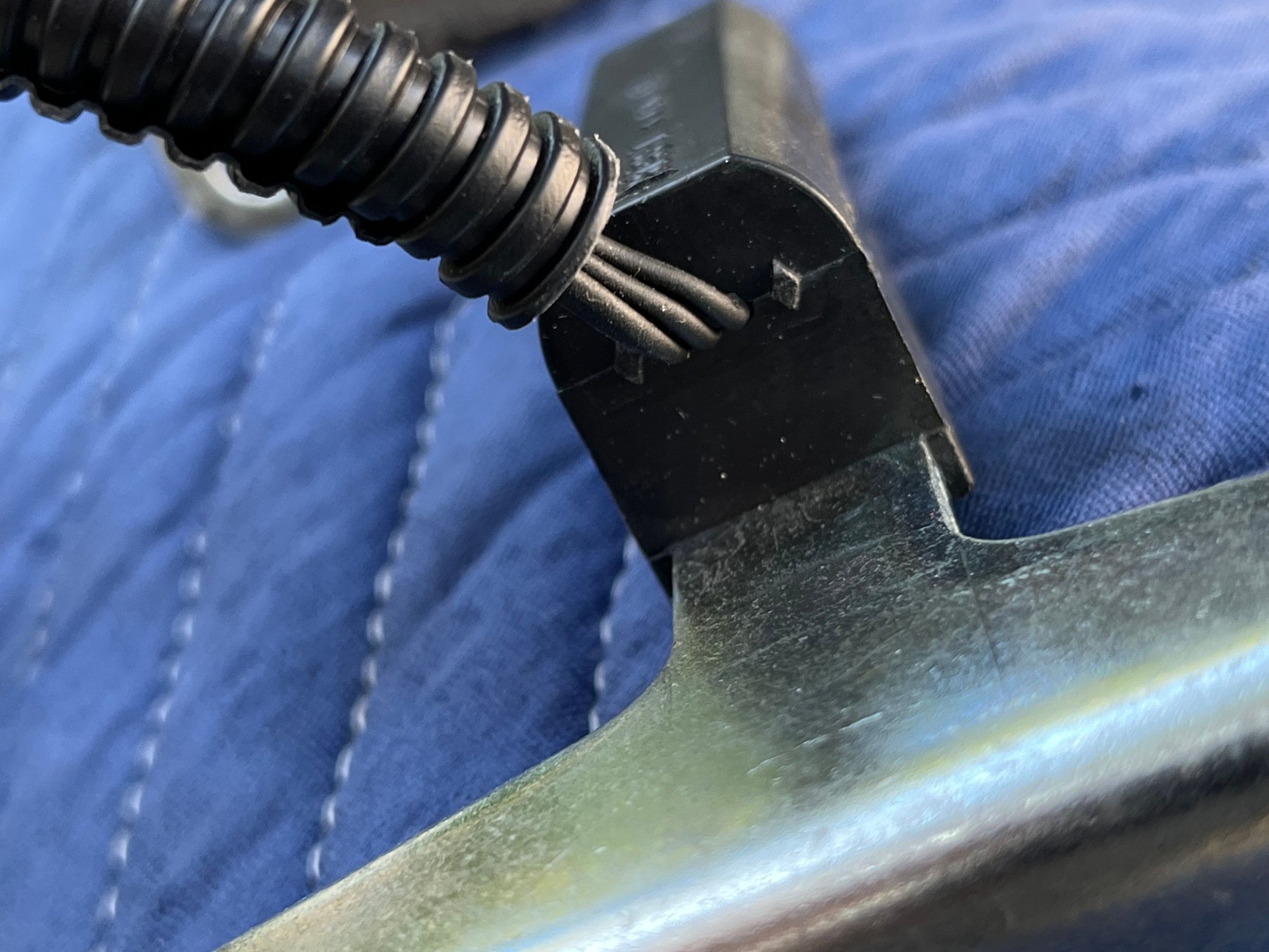

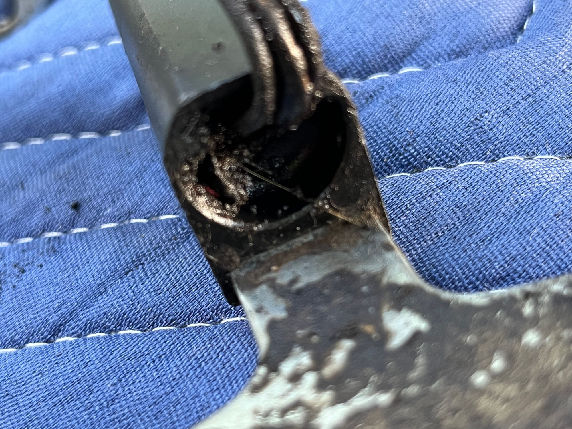

Here are some observations on the sensors. The three sensors top to bottom are: the one from NAPA made by Standard, the one that I took out that intermittently failed, and the factory Mopar part
5602 6701.
The Mopar sensor would pick up a wrench with the magnetism, the other two would not. WAY stronger magnet on the factory pickup, as well as exposed metal on the end of the sensor.
The wires were molded into the plastic on the Mopar sensor, and the other two had epoxy or resin where the wires went into the sensor.
Mopar crankshaft sensor
NAPA (Standard) crankshaft sensor
Other aftermarket sensor

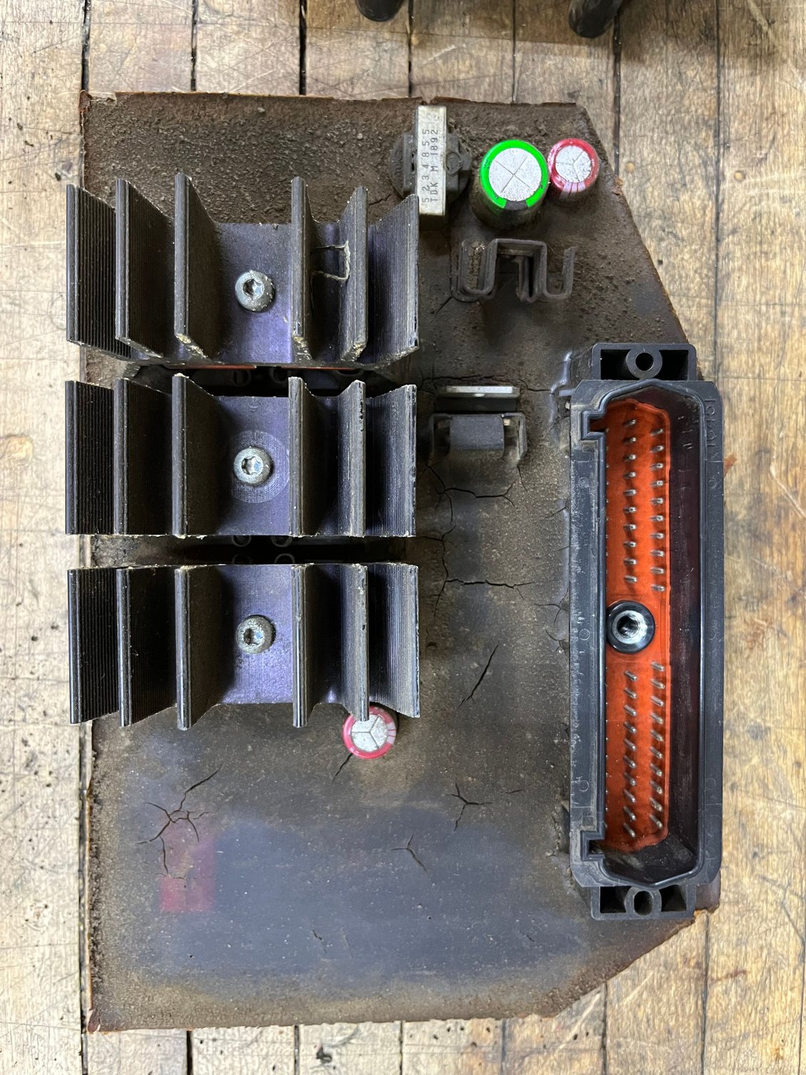

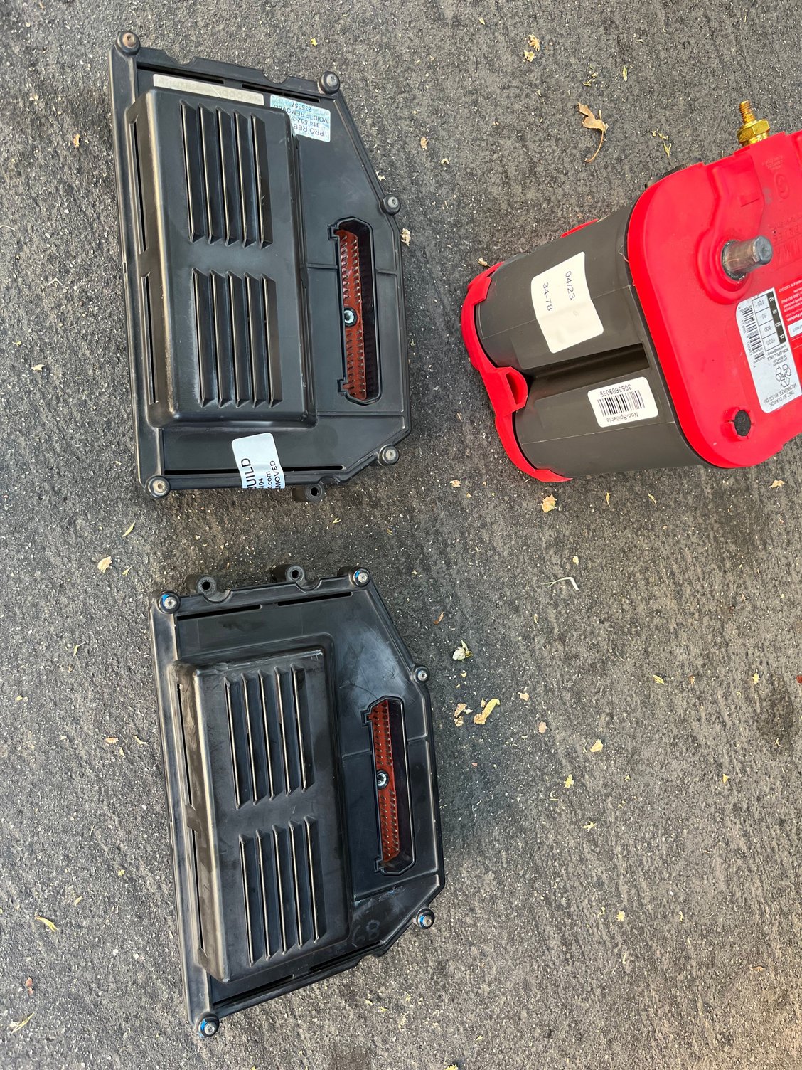

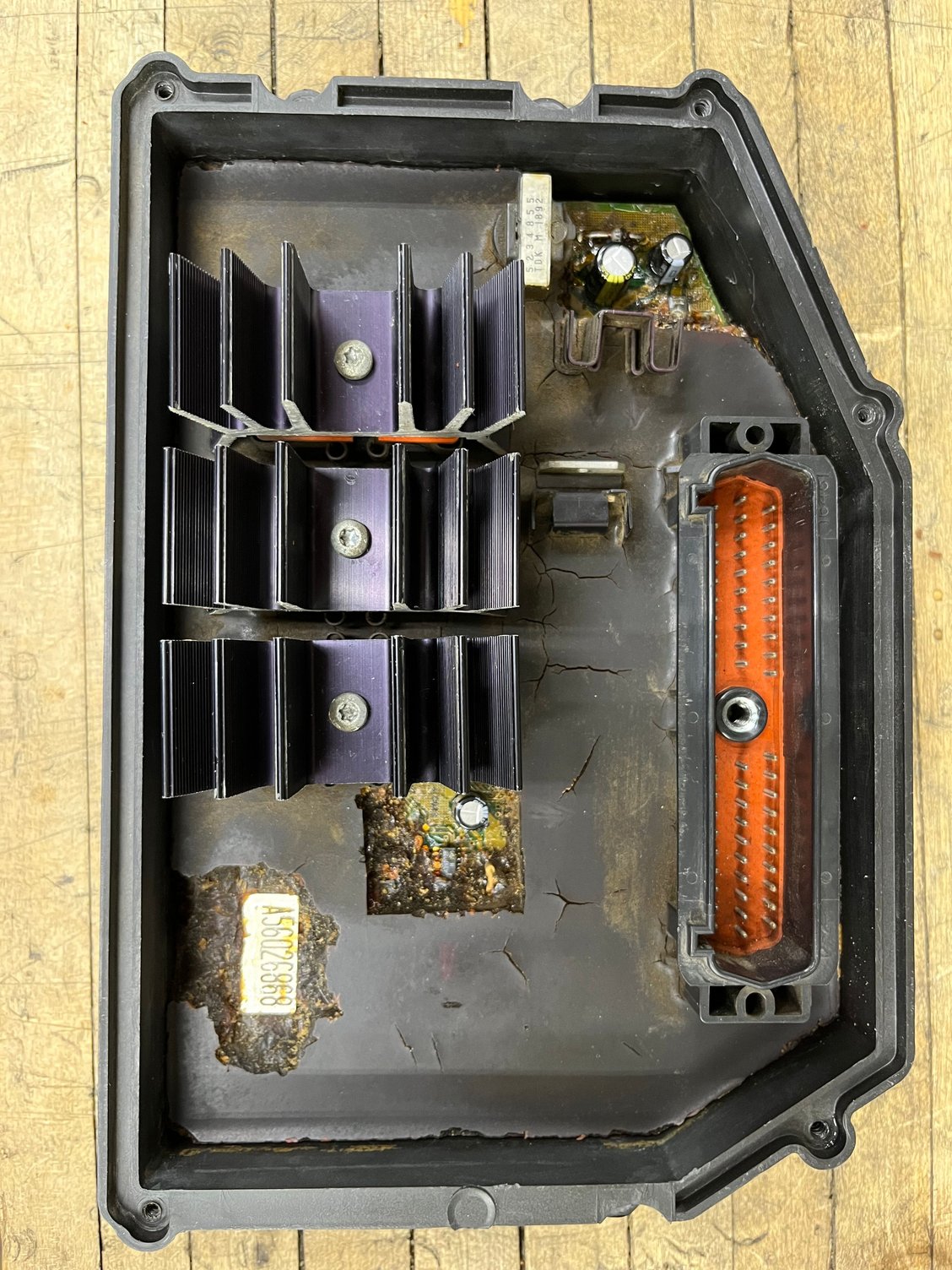

Anyway after idling for 15 min, driving it around, washing it at the car wash, it died once again. I couldn't believe it. I still had the ECU from ebay in there, and it started up again after a few minutes and ran fine. I drove it around for a while more and it died again. Confused, I decided to change the ECU back to the one that came in the truck that I replaced the capacitors in. It is a one year only 1993 California Emissions ECU ( 5602 6868 ) but I the one from ebay is a 50 state compatible ECU 1993 ( 5602 6866 ).
Before capacitor replacement
After
Anyway with the old ECU the truck runs great again, and hasn't died so far. Anyway for anyone who has this problem on a 1992 or 1993, buy a factory crank sensor as it really was a challenge to change it- twice. Thanks for the suggestions, hopefully this crank sensor drama is over.
