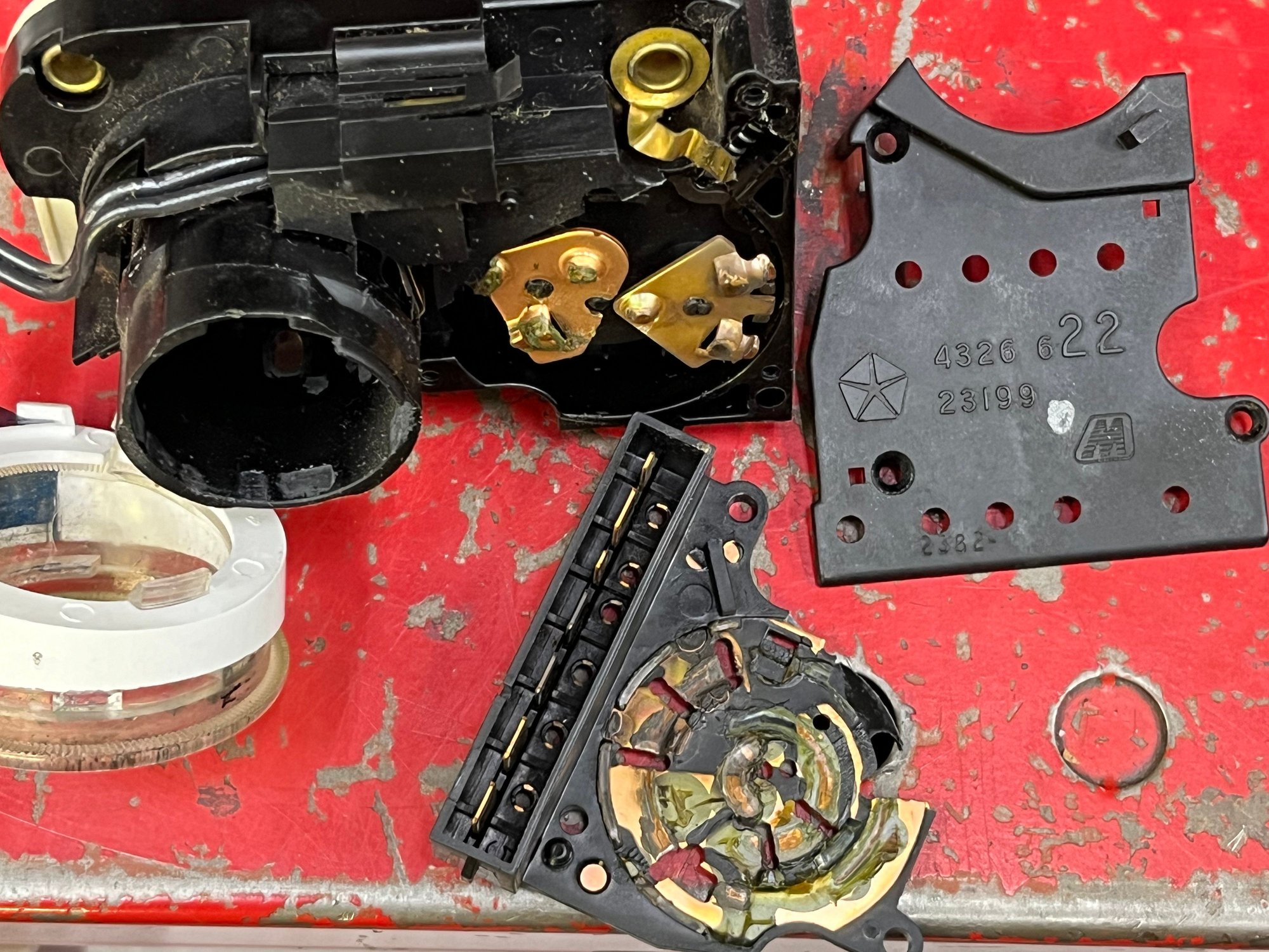

UPDATE: IT RUNS!

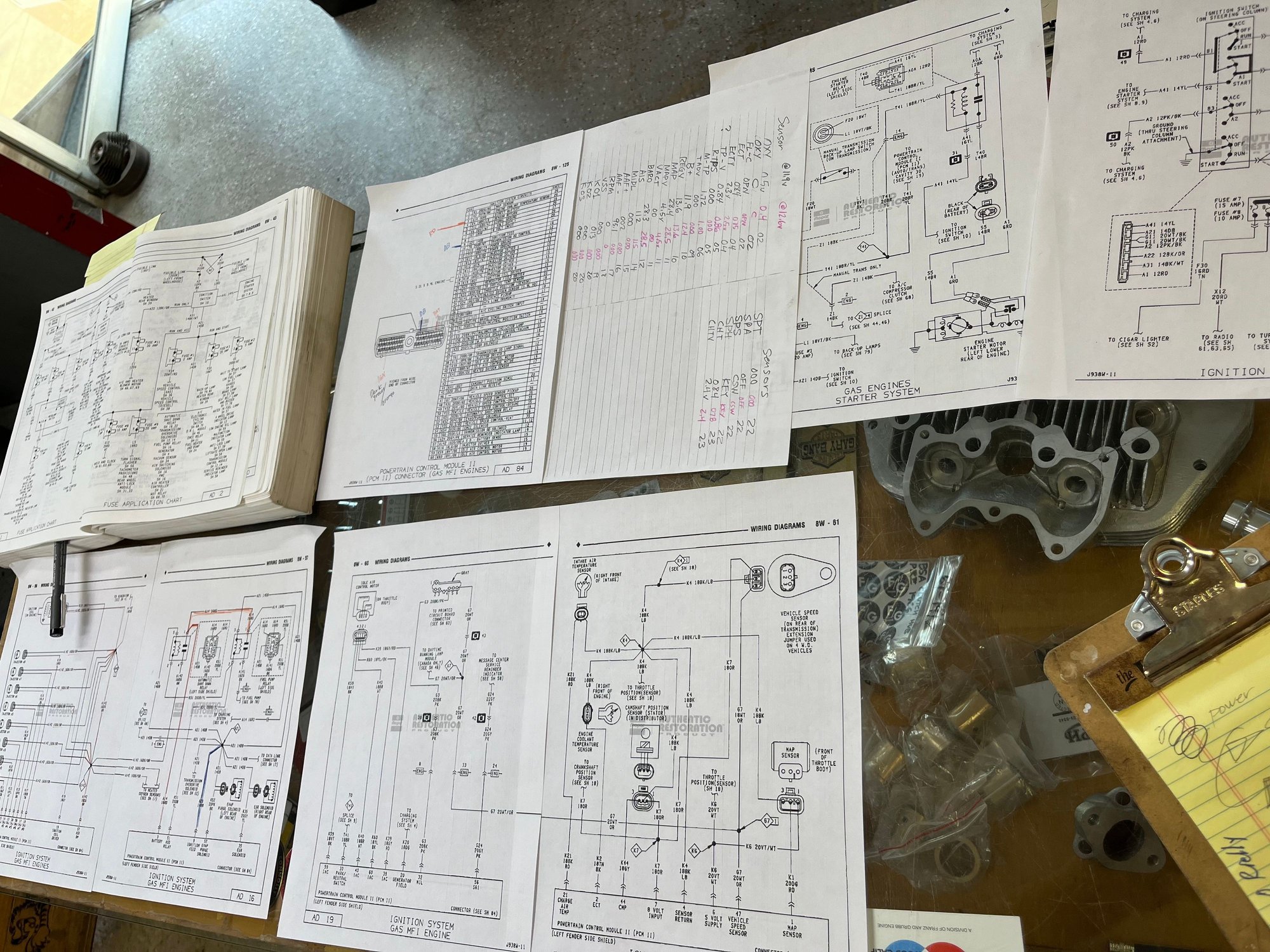

After looking at the schematics and tracing wires with my meter, I realized that the power was getting to the ignition switch but although it was cranking over it was not powering the ASD relay. I got an ignition switch from NAPA and installed it, now the relay has power and it starts and runs perfectly. The switch was original, but a few of the terminals were darker than the others and when I took it apart you can see the copper is oxidized.
The OBD1 has way less information than OBD2, and possibly is harder to troubleshoot than earlier systems. Anyway just for everyone's information-
The OTC scanner can test relays, injectors, and solenoids, but has no test for crank position sensor or cam sensor.
Also the ignition switch cranked over all the time, but the contacts inside were less than great so even though it seemed to work it turned out to be the problem,

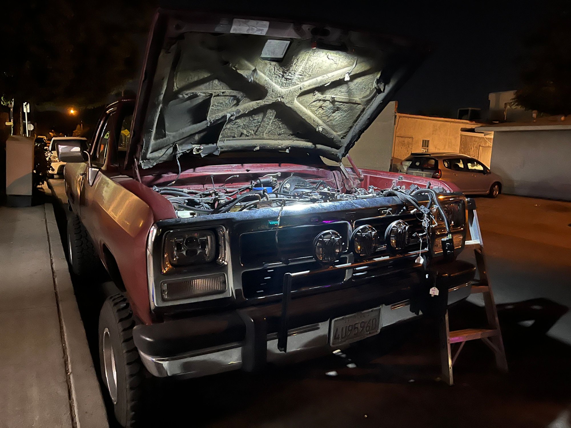

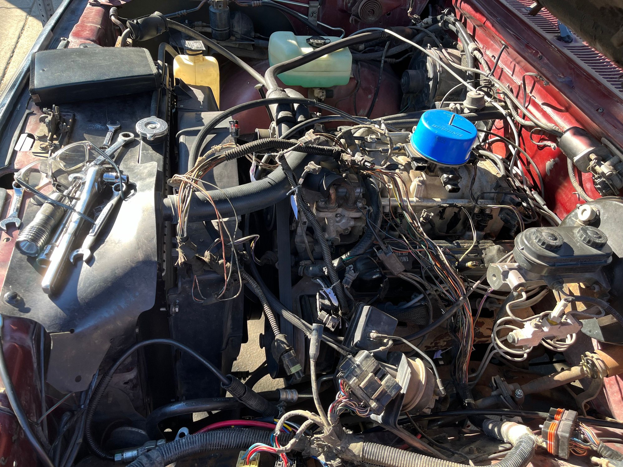

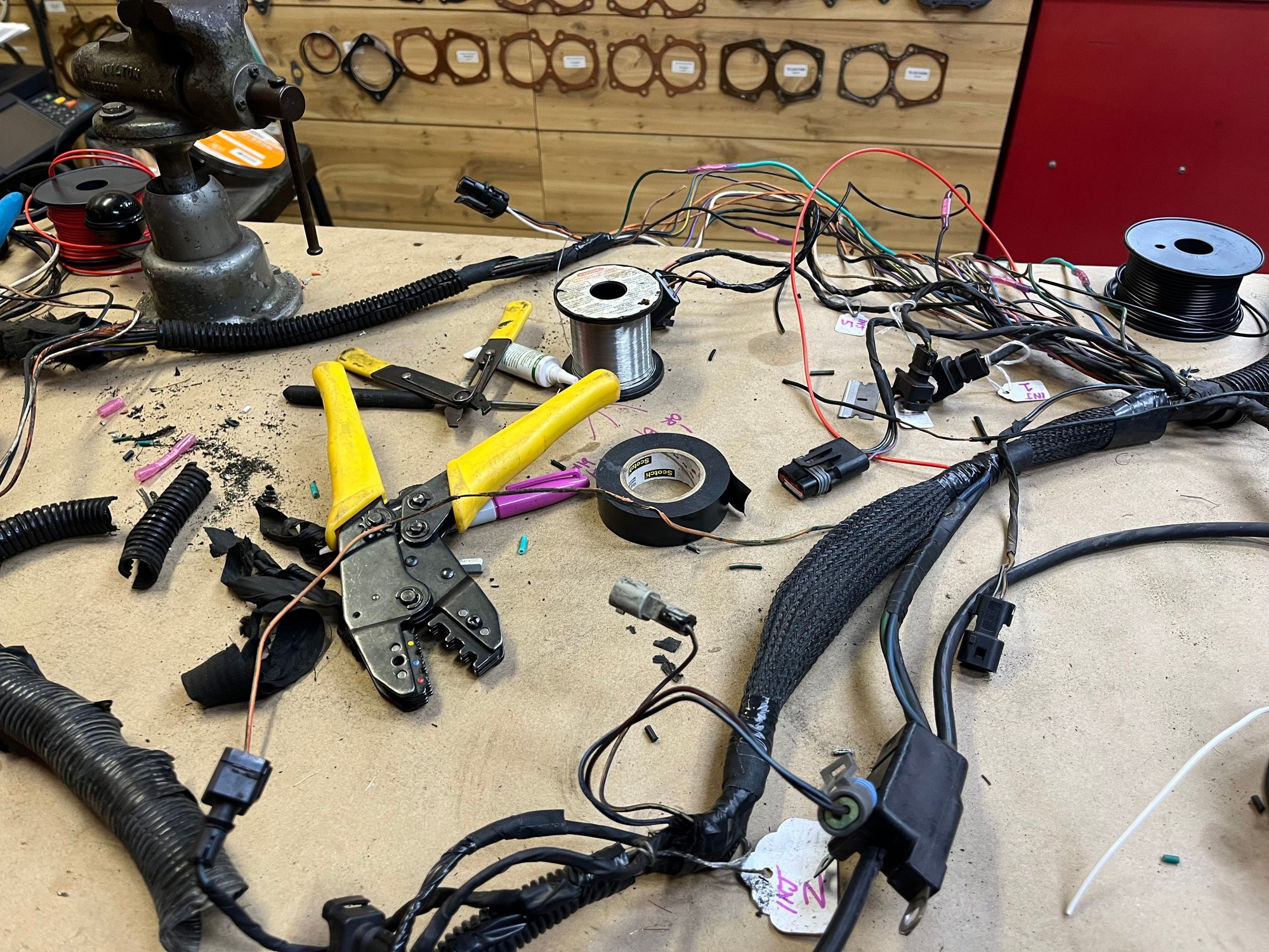

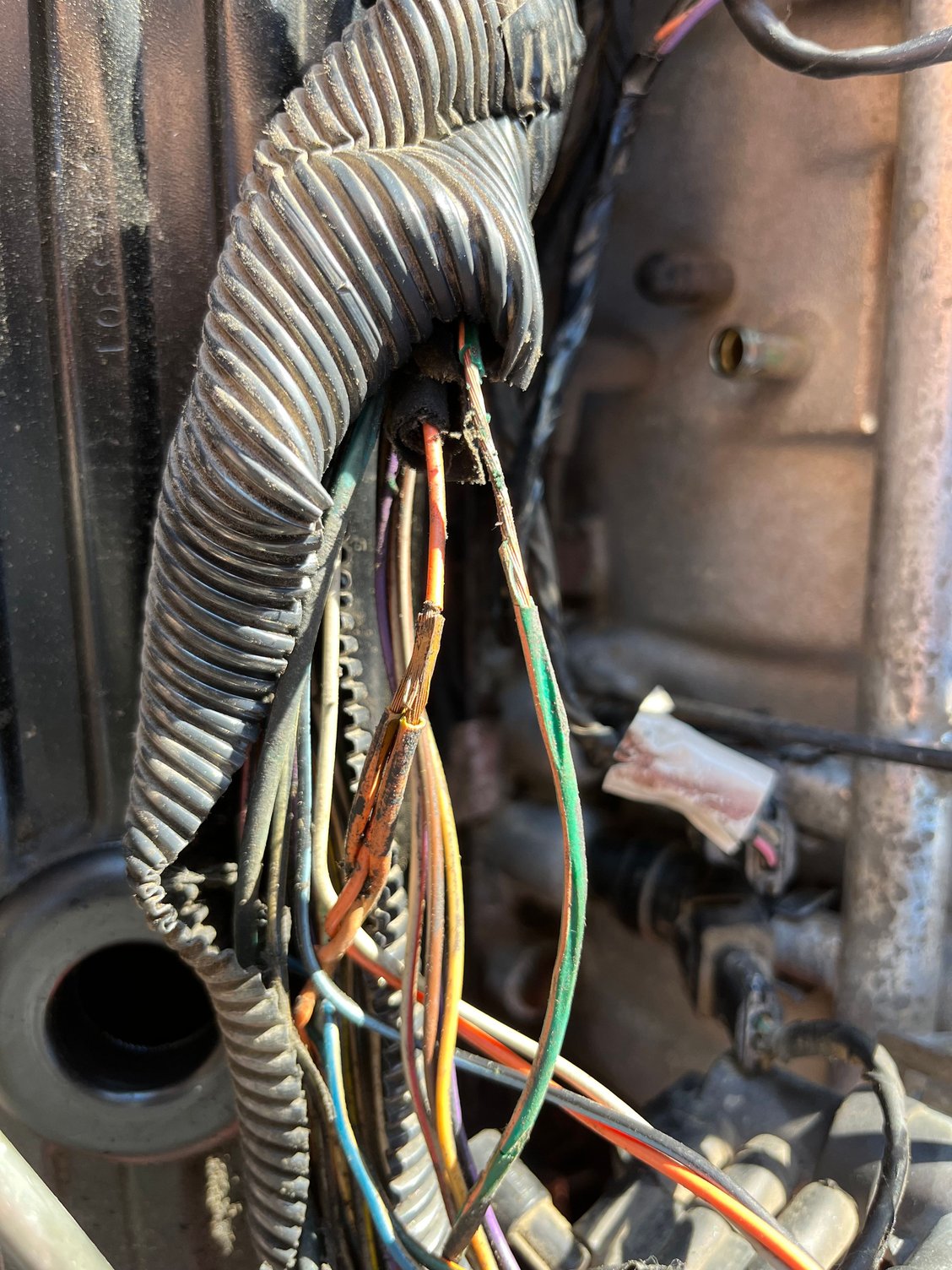

UPDATE: It wasn't fixed! It was the wiring!!!
After driving for a few days everything was great, then drove off a curb and it died. Lights on, everything working, cranking but no start. I shook the wiring near the distributor and it started. It's definitely a wiring issue. I figured I needed to be sure everything was good so I completely removed the wiring harness from the engine/trans.
It was shocking how many bad wires were in that harness!

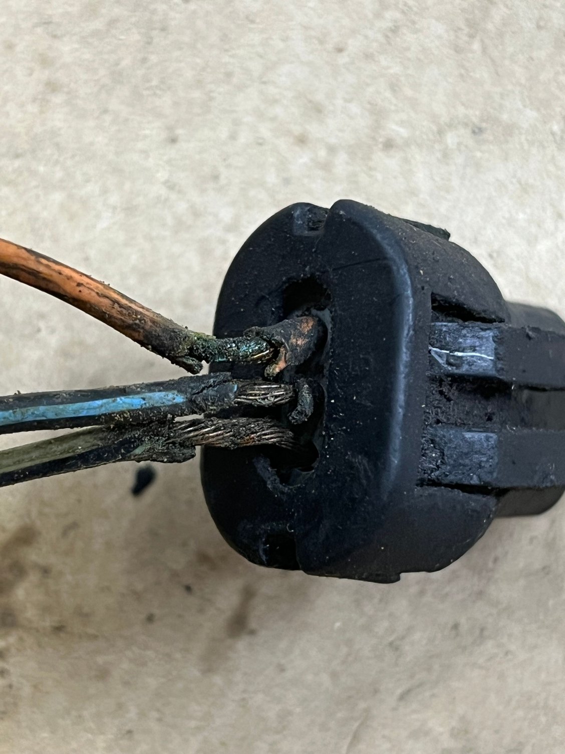

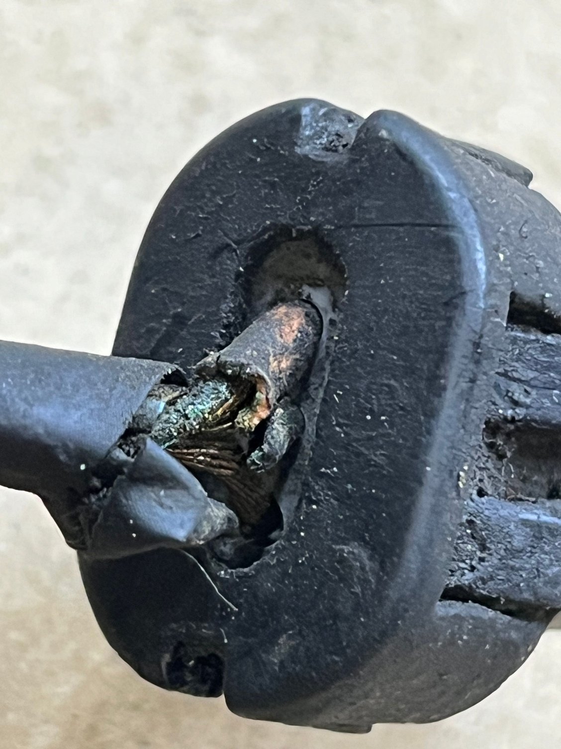

Anyway since my chance of finding a new one is zero, I decided to fix this one. The crank position sensor connector is not visible when installed (you have to plug it in with one hand reaching up from underneath), but it was totally corroded and shorting from being twisted around.
Here are some photos
Anyway I wish I had done this sooner. The insulation on some of these wires had degraded, and I cut out sections and soldered in new wire. I reused the factory connectors and soldered new wire on to the terminals. Some of the damage I would have never been able to see if I had not taken the wiring harness out. Most of the destroyed wire was on the drivers side of the engine, close to the fuel rail test port...maybe gasoline got on the wires, who knows.
If you are having the same type of problems with this era Dodge, I highly suggest looking into the wiring in this area. Even though it was time consuming and a pain to reinstall, I am very happy I found the problem and the truck runs great once again.
I ended up replacing about ten sections of wire, about a foot long each. Most is 18ga but some is 16ga.
Hope this helps someone and be careful pulling the harness out, there are LOTS of connectors,
