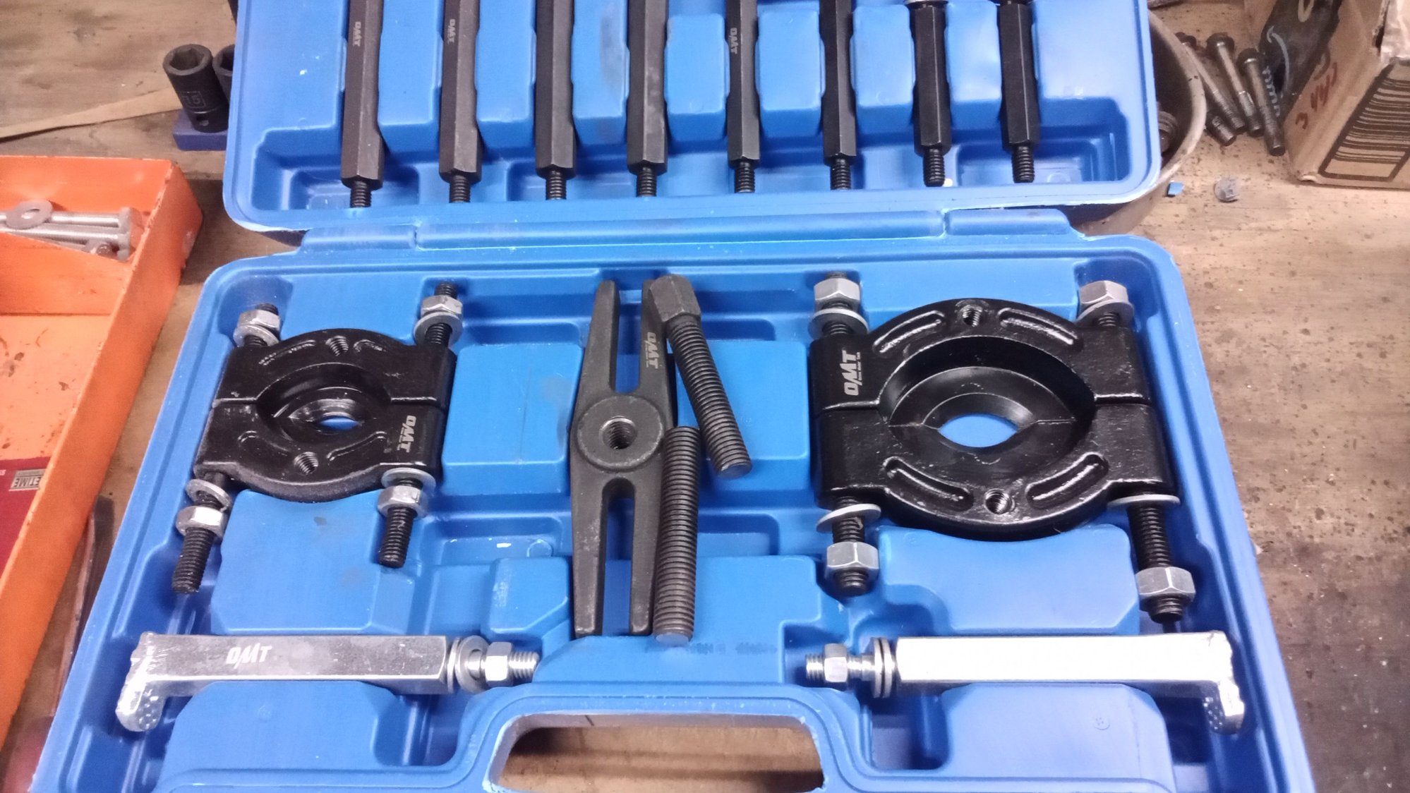

I saved ya all from the fiasco of removing the steering wheel .... The bearing splitter pulled it easily.
Just one itsy bitsy goof I made .... The column is hollow for the horn wire to pass through .... The shaft of the bearing splitter was just the right size to go into the hole but not come out.
I tried everything to remove the tool and got nowhere.... I spent about 4 days trying different things to get it out. ..... This was my final try and it failed.
This is where I threw in the towel and cut the tool, got the wheel out of the way then cut the threaded shaft flush and ground it out using a carbide bit on a Dremel. Hardened steel I could not drill it.
All said and done, only thing damaged was the tool and can repair it.
Your steering wheel should have a couple of holes for a puller to work with. I never use a bearing splitter as it can damage the lower part of a steering wheel. I keep small pieces of scrap metal to use for the puller bushing to work on.

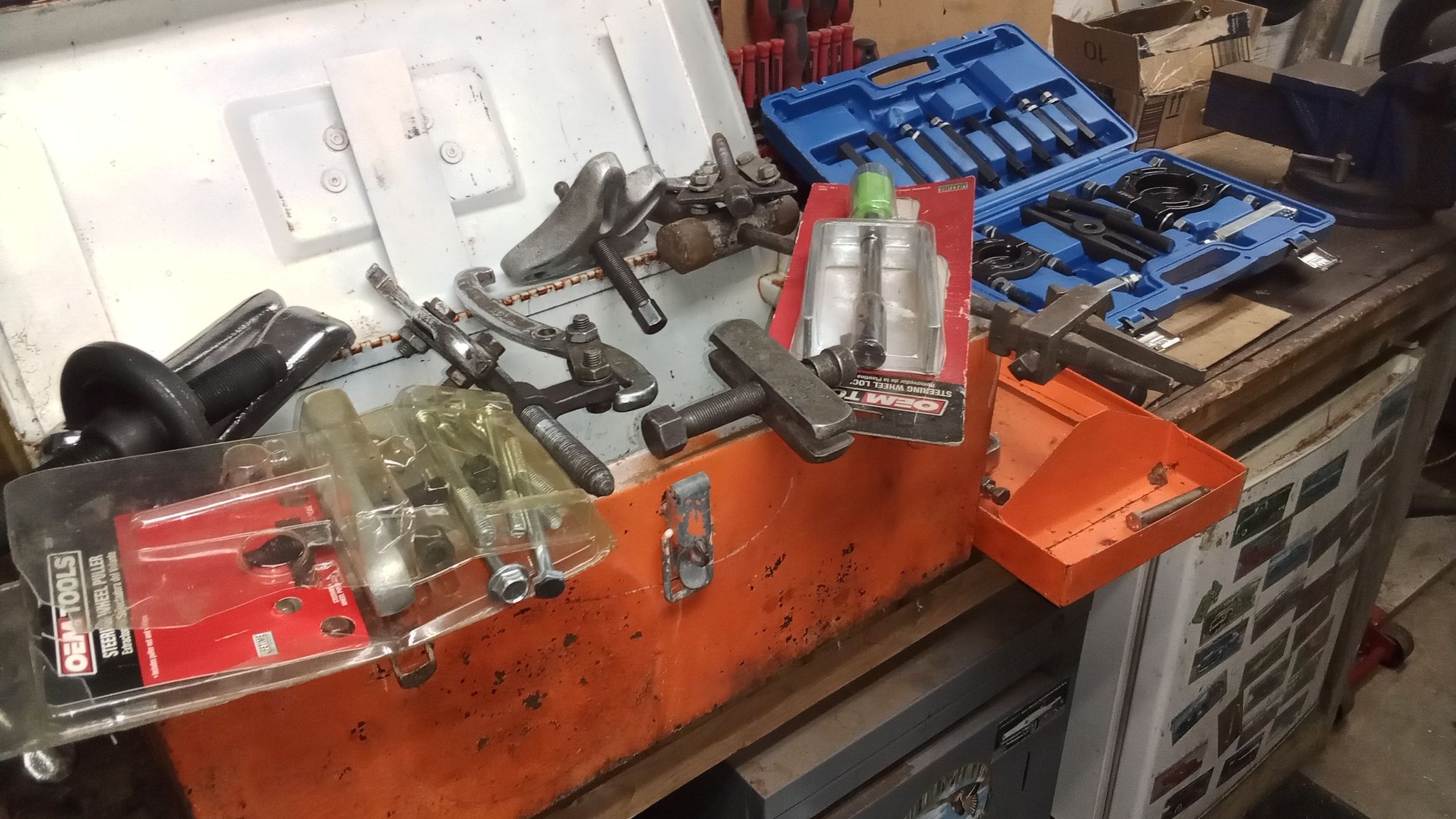

Thats the way it always goes ..... Honestly the bearing splitter is actually the preferred tool and works fine. What pisses me off is I purchased the bearing splitter 2 years ago just for this job, this is the first time I have used it
I had to cut the bolt, I think I can take the cross bar to Ace hardware and find a new bolt for it .... I hope.
I have several other pullers, I might have the piece needed already .....
@ol' grouch There is no holes for a puller to connect to, you need to pull the wheel from the bottom.
Just me ruining my new tool because I used it improperly .... I was thinking I could put a washer under it to protect the shaft ..... I decided it would be fine as is.

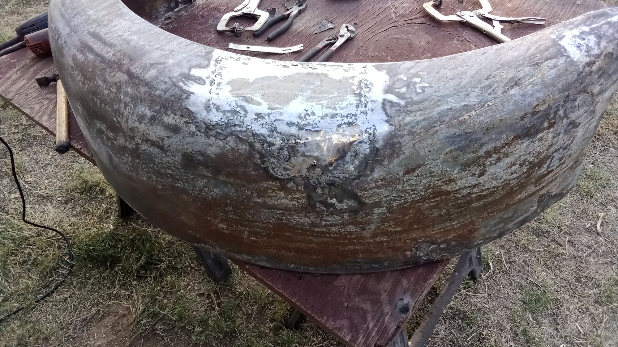

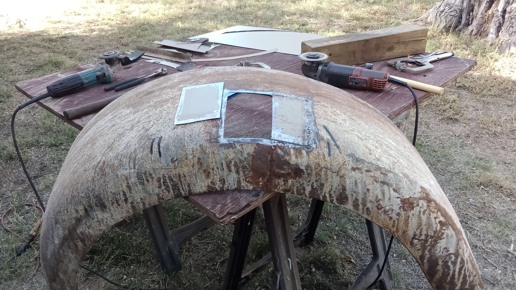

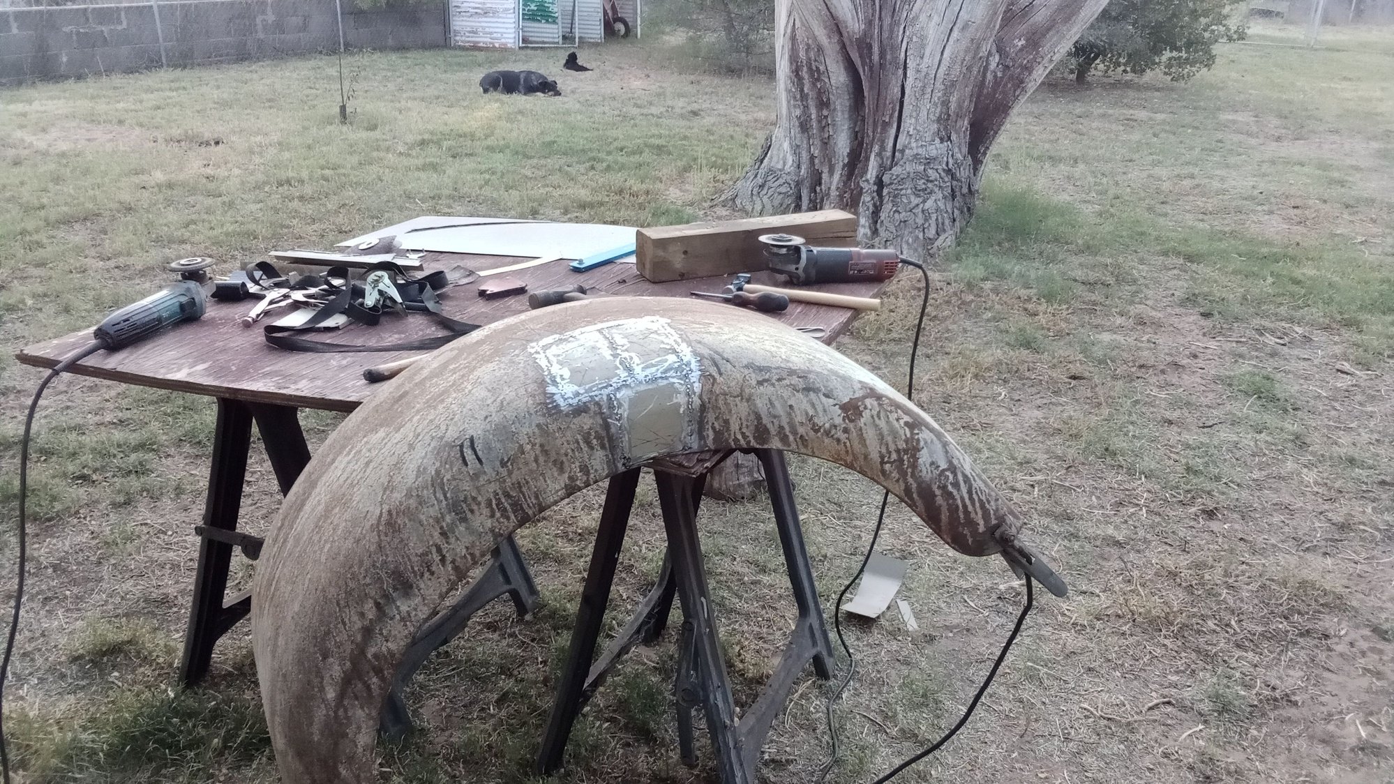

All I can say, this fender been kicking my butt for 2 days now .... No where near finished, but is roughed in and will need a lot of tap tap tap then weld weld weld ... grind grind grind.
Just as a self taught welder that has only welded in a few different simple patches before, dealing with the multiple curves was a challenge.
I made one patch panel that I ended up installing in 3 pieces, then I needed 3 different pie cuts to the metal to get it to conform to shape. .... It was interesting.
Basic shape is there, just going to take a lot of patience with a hammer/dolly, welder, grinder to finish it.
Now I'm ready to move on to this one, try to get it roughed in and to the same level of repair ... then I will strip them both down to bare metal and final body work before paint.
I did a little work on this one already, my goal was to secure it enough that it would not fold in 1/2 while moving it around. A couple years ago.
Will be interesting to see this one in a few days and see what I settle for as "good enough" This fender was really beat up and will be very difficult for me to get the proper curve back into the original metal.
Same time a friend reached out to me the other day on a different forum, said he had a couple extra fenders he would sell me. ... needed a little work but not bad.
A smart man would take him up on the offer .... I was never accused of being smart .....
Right now after looking at these fenders for 5 years, I'm taking it as a personal challenge to see if I can bring them back to some sort of life.
This was a old construction truck, there is much body damage on it from being hit by heavy equipment ... the dent in the cab corner I believe was done by a fork on a fork lift.
Both fenders ripped and smashed while loading & unloading, the drivers side bed rail is tweaked so bad at a awkward place ... a fork lift again.
The running boards on these trucks are very stout .... mine are all wavy from machinery .... I will never make this truck perfect, just good enough.

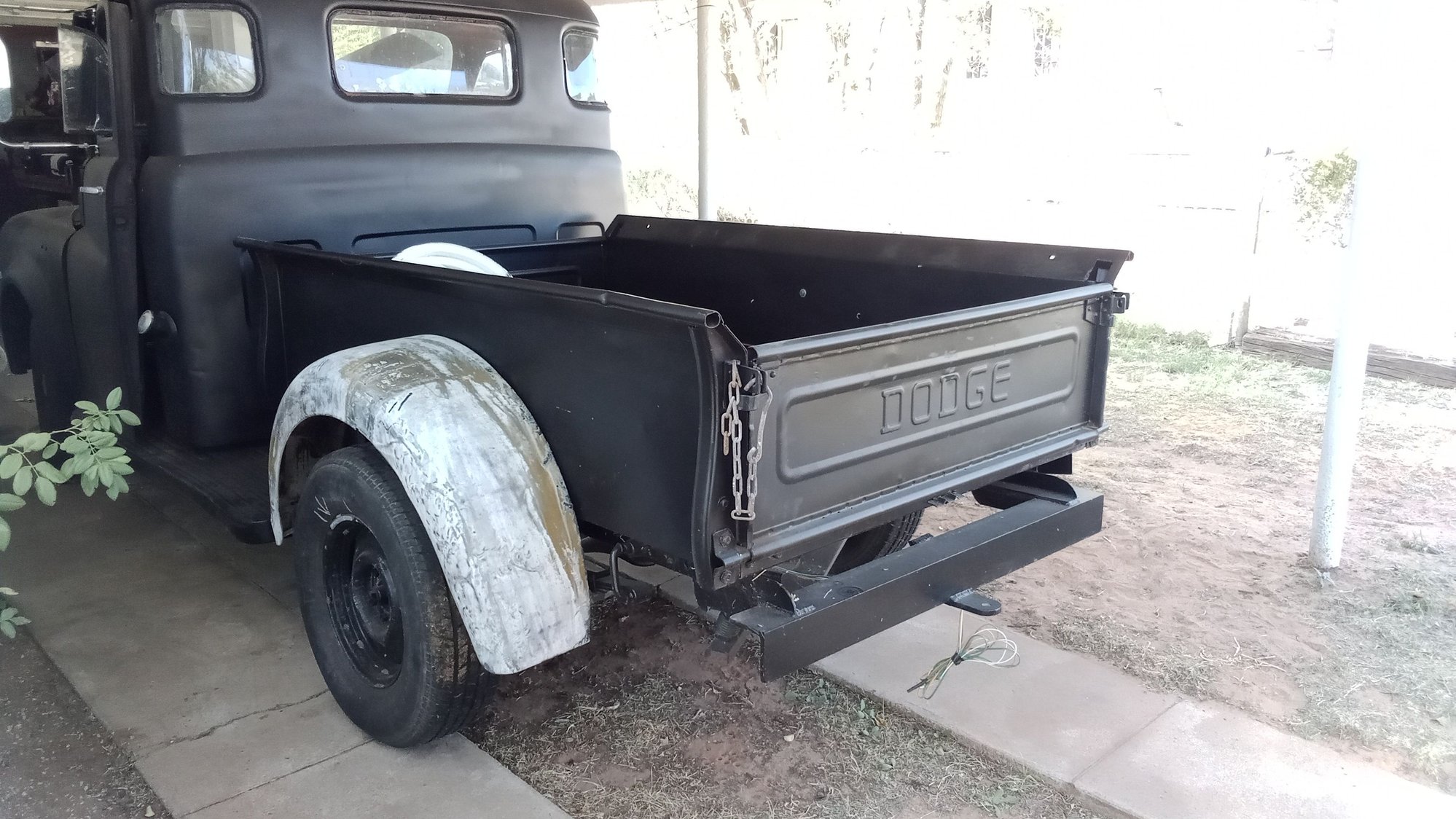

Well I have to say the driver side went better then the passenger side ..... I feel I did the passenger side wrong and created more work for myself.
Hey it is metal and all comes out the same in the end.
This is how I did the driver side, no fuss or stress .... just multiple easy patches to make one big one.
Still a lot of work to do with them, but they are both at least solid, rust repaired and will get painted someday soon when I finish all the hammer and dolly work and final welding.
Just nice to see them back on the truck, and know that I can finish them to "good enough" for a beater with a heater.

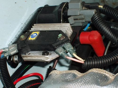

I was surprised at the next step ... I need to order the ICM and a electrical pig tail to connect it .... Almost had a heart attack when I saw they want $130 for the pig tail.
So I did a little more research, found out all the Kool Chrysler kids are running the GM HEI ICM on their mopars.
So I have decided I would go this direction and get rid of the mopar ignition to control the distributor .... pretty simple setup and a AC DELCO ICM is made in USA and dependable.
If I use the GM coil, they have a nice mounting bracket with a heat sync for the ICM, makes for a clean installation.

Gm on a mopar?
I'm proud to say I'm not a cool kid because I run MSD6A! You can use the existing wiring to the pick up, Two connections to the battery(positive, negative) coil and a ignition on wires and that's it. You have to use constant 12V coil with it, I opted for a Accel super coil.
