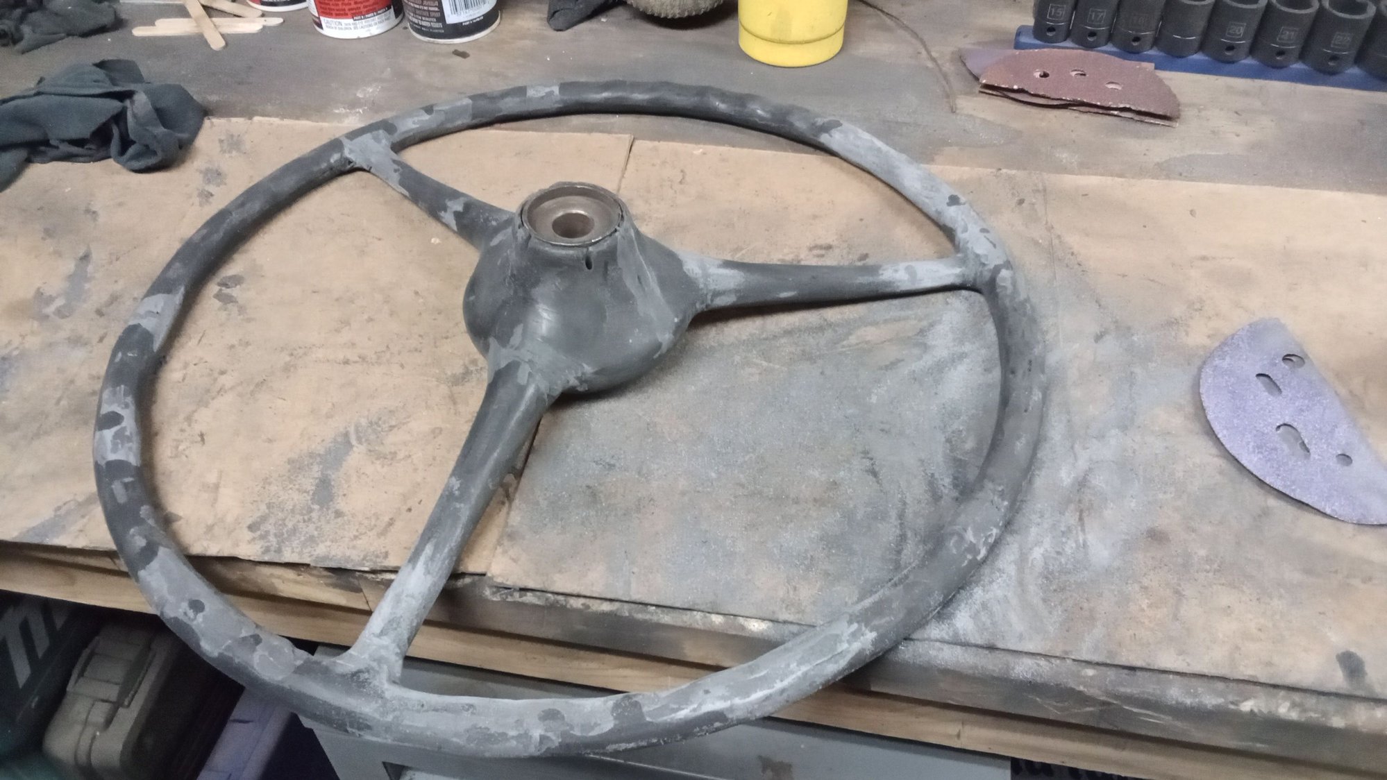

Did bundle up and do some sanding today .... recreating the finger profiles on the bottom of the wheel will be fun
But it is coming along OK .... time to dig out the horn button and see if it needs work.

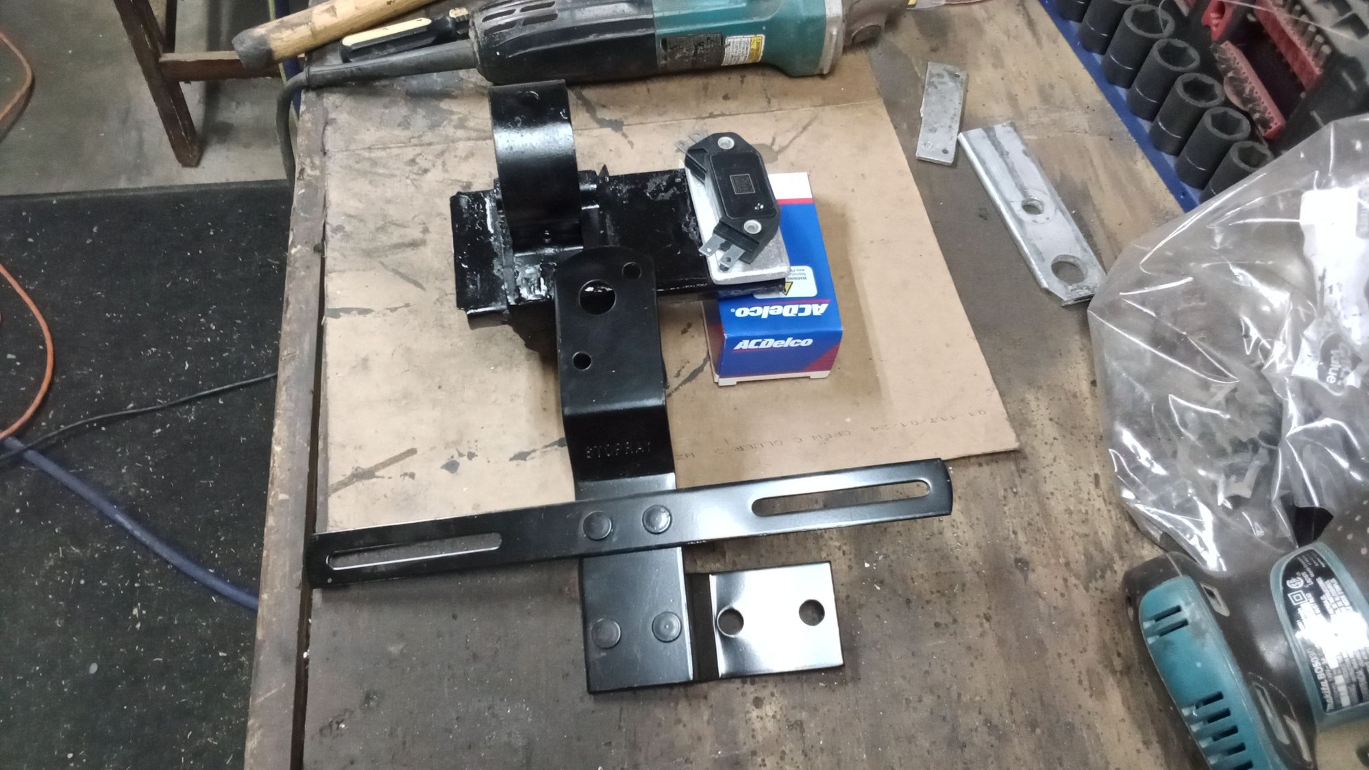

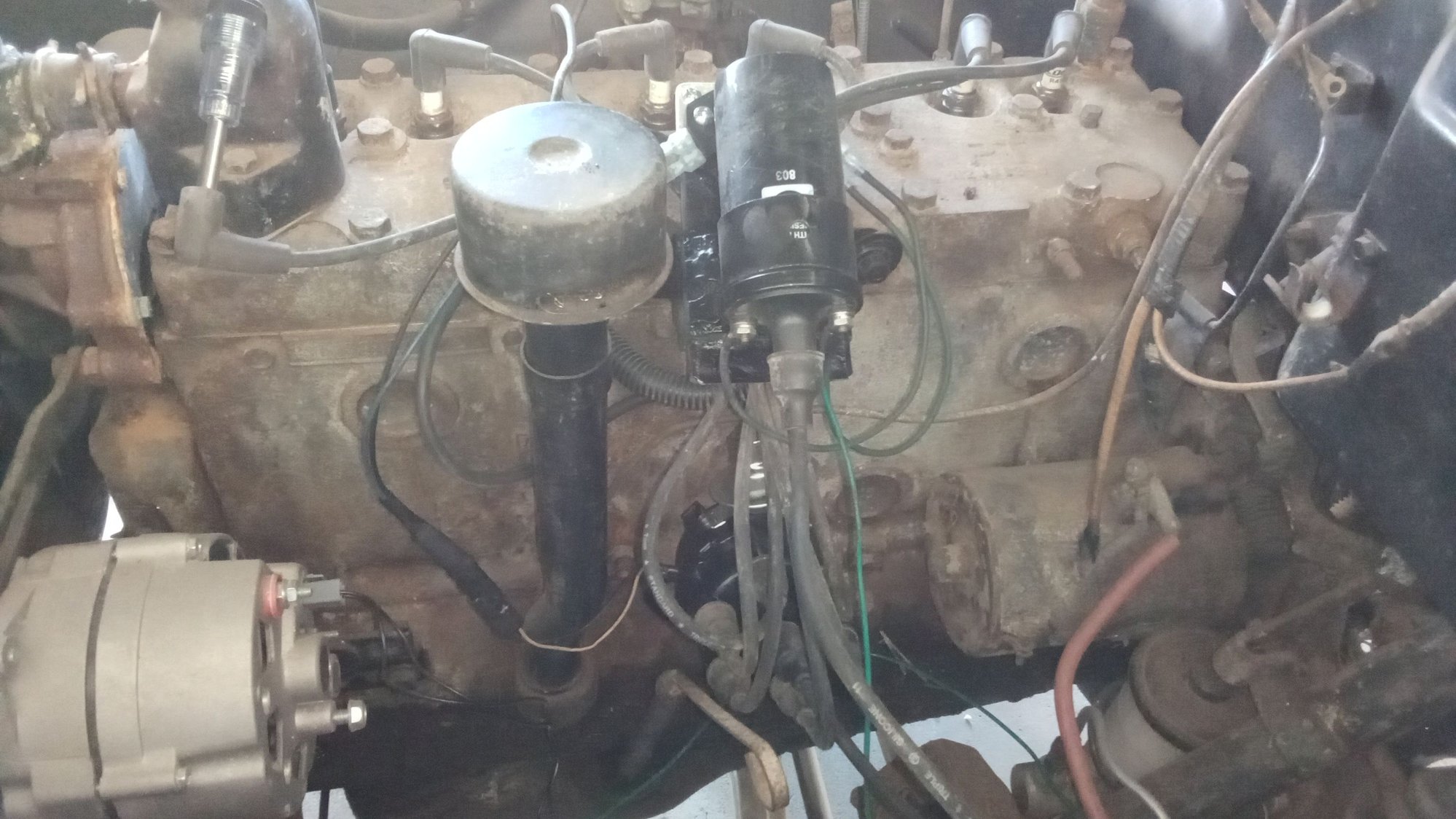

Well that was fun, I was working on the ignition today .... The HEI should have a heat sync under it and I had a chunk of 3/16" aluminum so I made one.
I mounted it on the coil bracket .... kinda buried under the coil.
The wiring is made to be permanent but will be cleaned up as I finish building the rest of the wiring harness.
Once I had it wired up I cranked it over to check for spark, had nice bright steady spark on the inline spark tester ..... I gave the air cleaner a tiny shot of ether because it had not been started in 3 or 4 months.
Less then 1 full revolution it fired and idled strong without touching the gas pedal or using a choke ... I let it run for about 1 minute, then shut it down. Better then I expected.
I have the interior stripped down preparing to paint .... no oil pressure gauge connected and I wrapped duck tape over the end of the line .... it was leaking so I had to shut it off
Will be interesting to see how well it runs when all is connected and it is warmed up and put back in time. ..... It still kinda looks stock if you ignore the alternator and Toyota MC.
Steering wheel is ready to be sanded again, may be ready for paint after the 2nd time .... might still need a 3rd coat to get things I have missed.

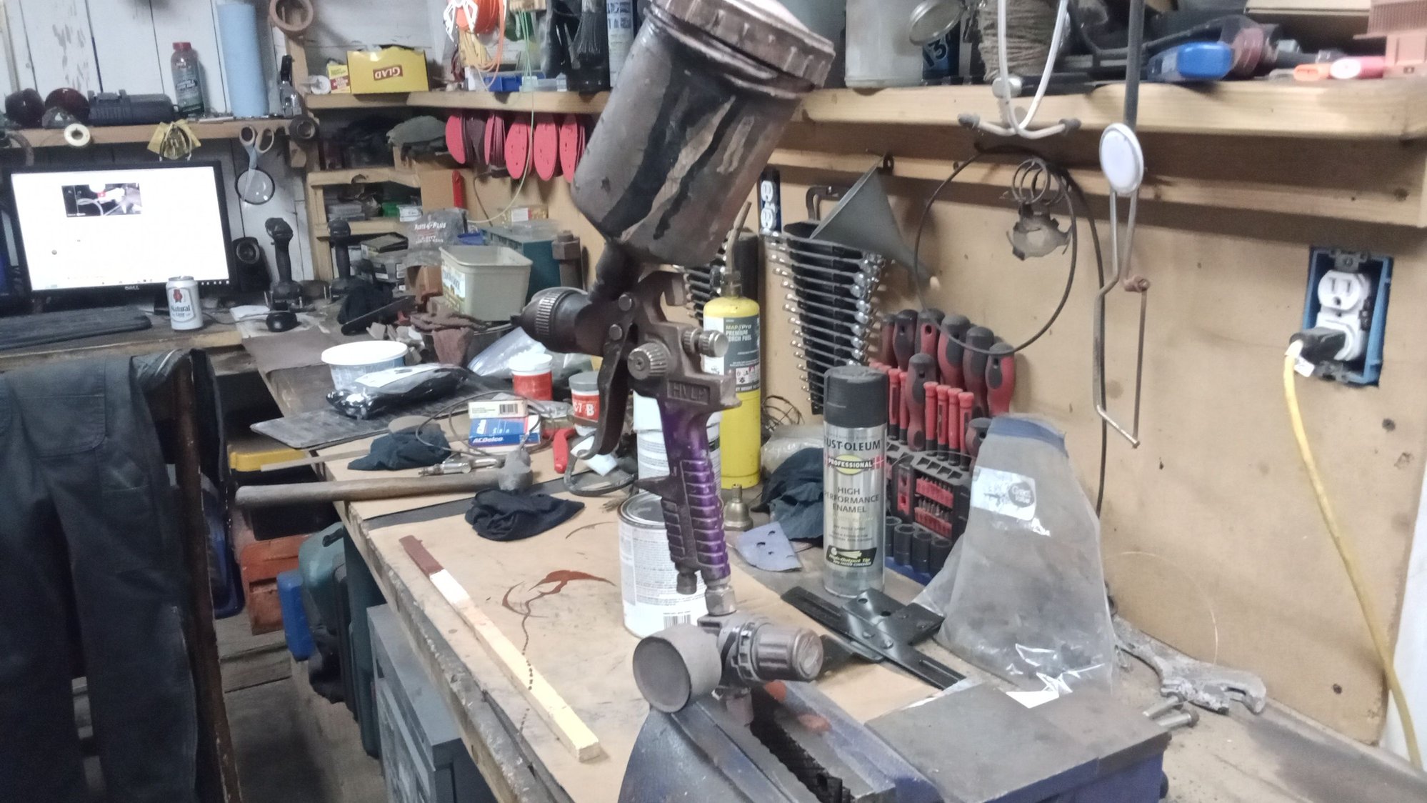

I planned on primer on the fenders and paint the steering wheel, had everything ready to go and then pulled out my old $15 harbor freight hvlp and it was a no go.
I sprayed some thinner through it and was fine, then mixed some primer and filled it .... can not get the lid back on .... the cup is deformed, 5 years old and I have sprayed several gallons of paint through it .... I ordered a new gun just like it, this time it was on sale for $9.99 .... After Christmas sale

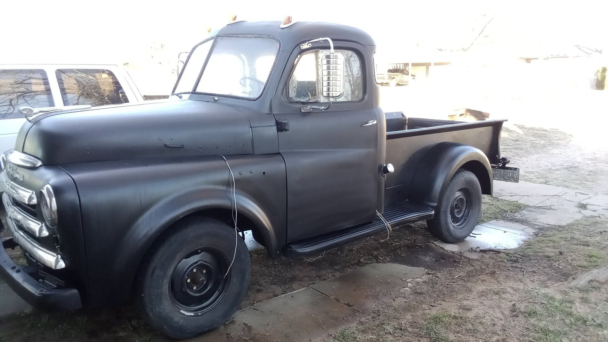

I did get the fenders primed .... I'm fine with how they came out, considering what I started with .... will work fine for a driver.
I left a few dings in them to call it character.
Then there was qne more good day and I hurriedly painted them .... was a mistake because a wind storm picked up and was blowing dust everywhere. Was not til I was putting the paint can away in the office to keep it warm, I saw the low gloss paint I thought I had just sprayed ..... I knew instantly I sprayed the wrong color with gloss black.
Oh well, they have paint and are protected ..... will just call it a base coat and spray them again when the weather is right

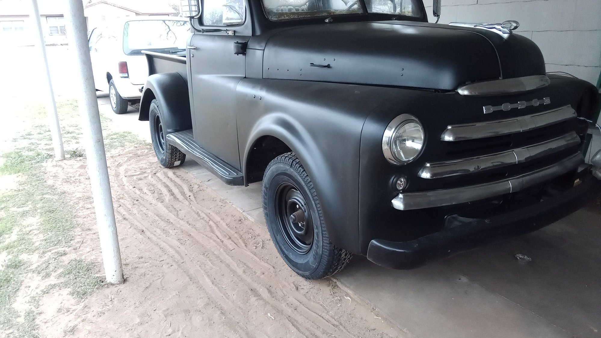

I had some time and painted the rear fenders the correct color, then I even washed it for the first time I painted the truck over 1 year ago.
I was not sure about the tires yet .... I remember the old days when they would run a aggressive mud/snow tire in the rear, then a highway tread up front .... I ordered 2, 235 75R 15 AT tires for the rear.
I did want to see if they would be OK on the front also .... Always nice to have all 4 the same. .... Finally got some good weather again and was able to clean up the bare wheels and actually paint them proper .... they were just rattle can with the tires on before.
I'm satisfied these will work OK and will order 2 more.
