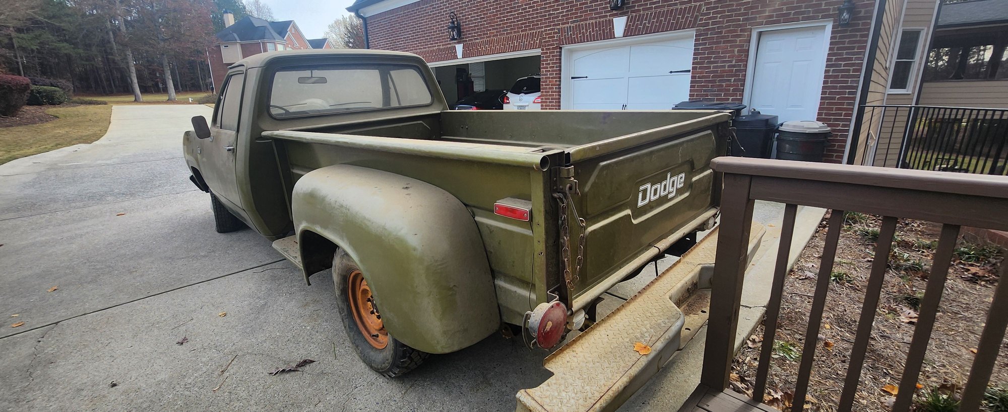

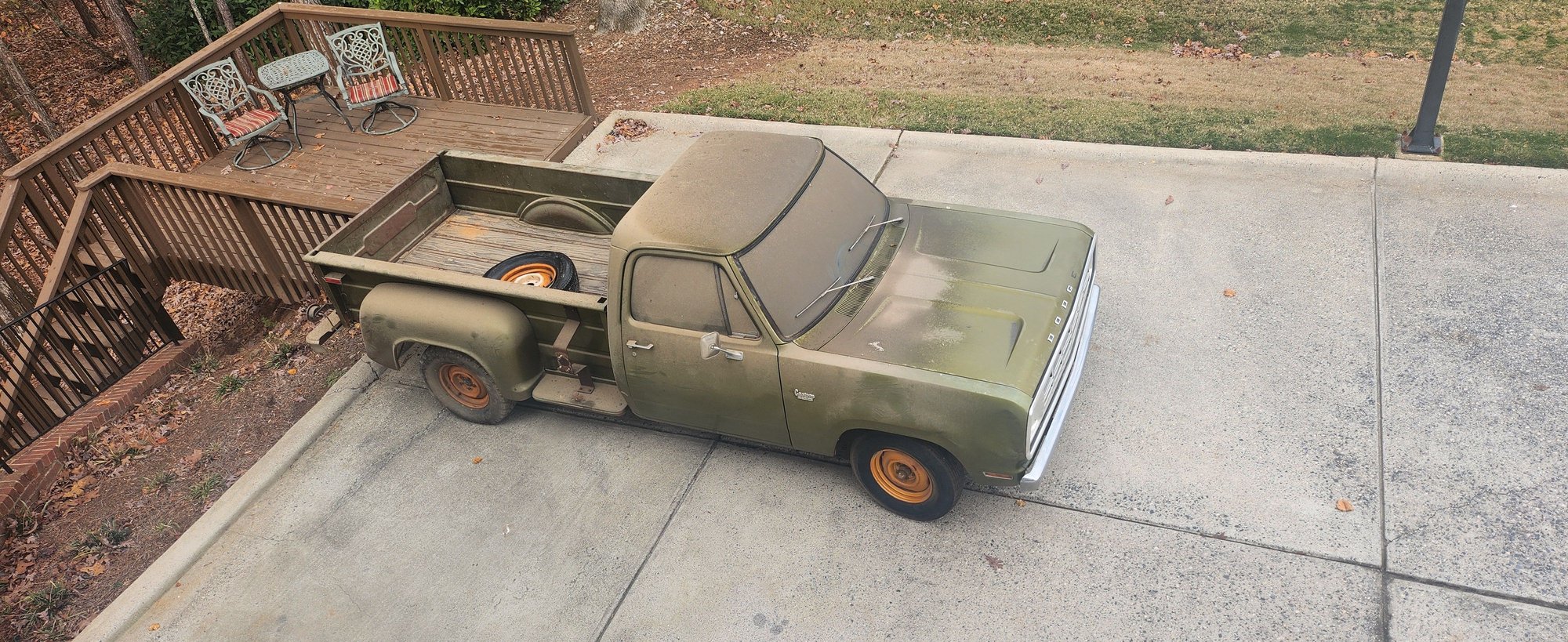

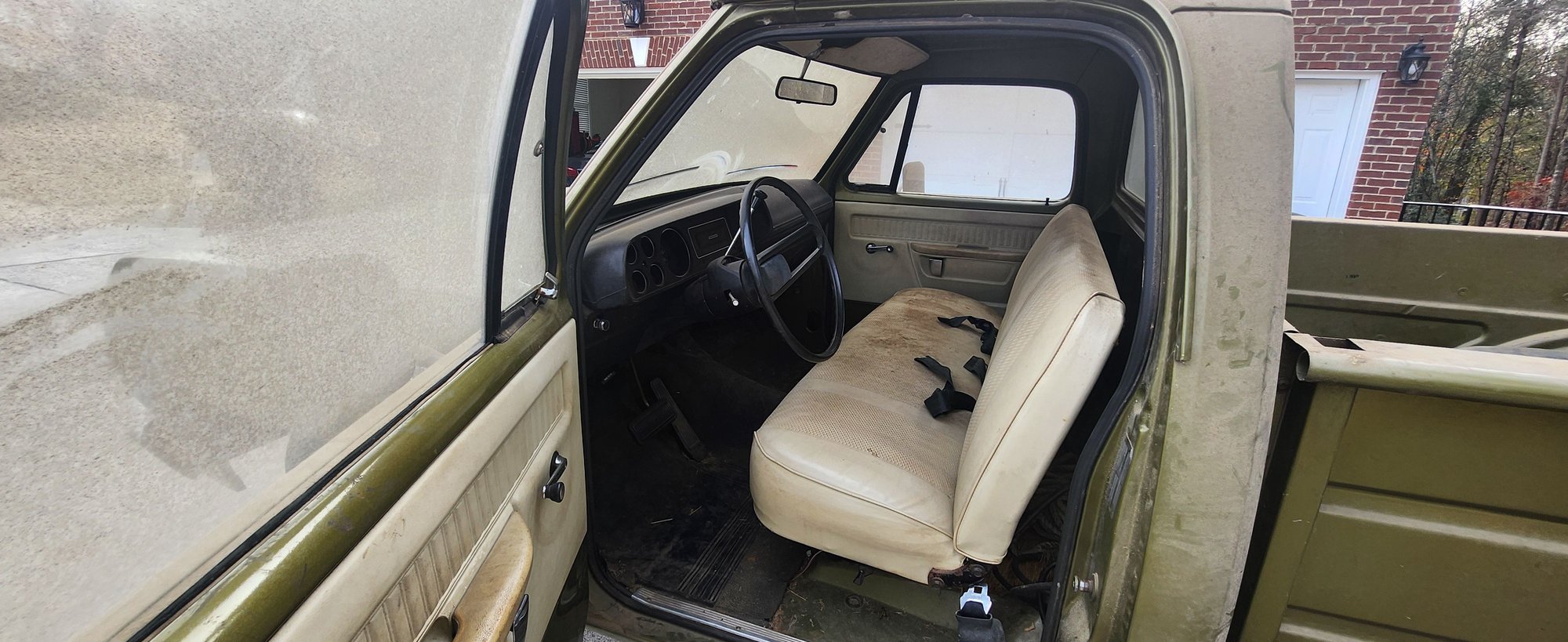

I've attached a few photos.

Looking at the photos, the trucks looks to be an original 21K unit. Usually, when it's a low number, I figure it's flipped over. You don't have points or condenser in your ignition at it's the third year for electronic gnition as standard. 1972 it was optional. I'd replace the cap, rotor, plugs and plug wires along with getting an extra ballast resistor to have as a spare. Those were the weak spot on Mopar ignitions back then. I always carried a spare wrapped in a towel in my tool box.
