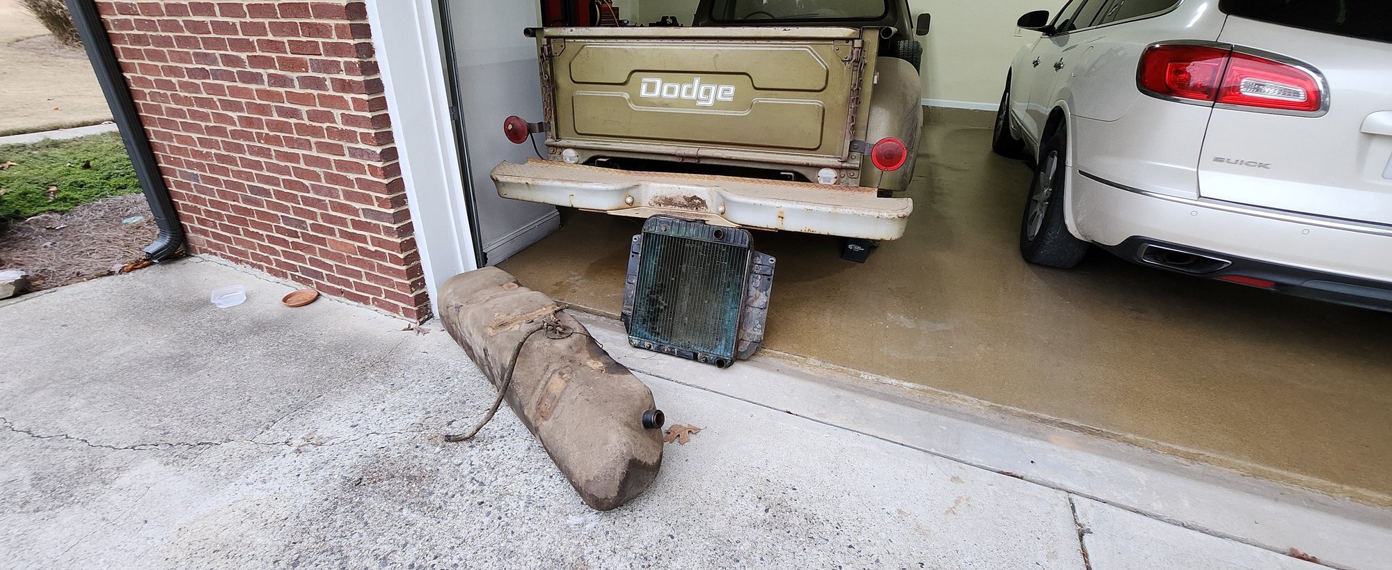

Well, I was supposed to be working but I couldn't help myself. I went out and pulled the tank and radiator so I can get them to the shop to have them flushed and pressure checked.
The fuel tank was held in by 3 straps, I undid the hoses and ground strap before I dropped it so no harm in doing that. However, the top of the tank has a crack that fluid leaks from when tipped on the side. It is plastic, which surprised me.

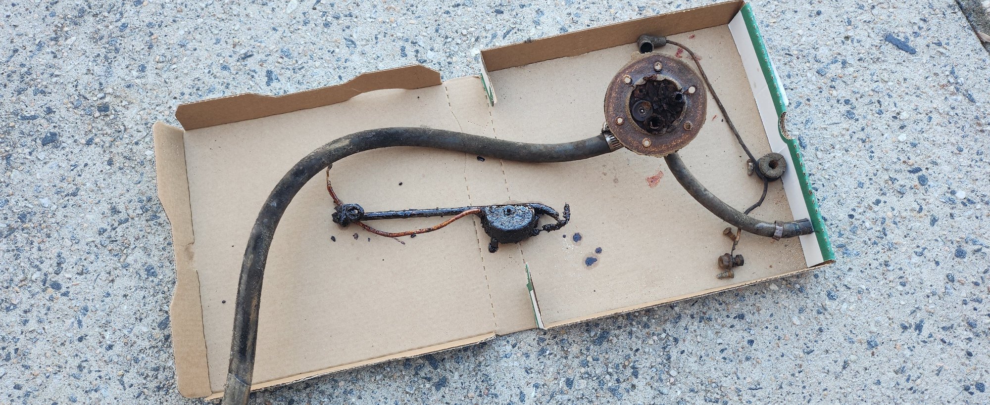

Question: How do I get the fuel sending unit off? On a Chevy there would be a lock ring. This has no such lock ring. I don't want to apply pressure trying to turn it without knowing what I'm doing.

Take a picture of the ring on top of the fuel tank. It may have a plastic ring instead of the metal one most tanks use. You press a tab in then rotate the ring. Back in the late 70's, I've seen metal and plastic tanks both. My '78 Trailduster used two tanks. A metal 24 gallon and a 40 gallon plastic tank. I have a spare 40 gallon in the garage and the top was held in ith screws.

Think this sending unit is reusable? 😄
Drained the tank. I'm going to take it to a radiator shop and have them boil it out. There's a lot of visible sludge in the tank still.
What I drained was black gasoline. Nasty.
