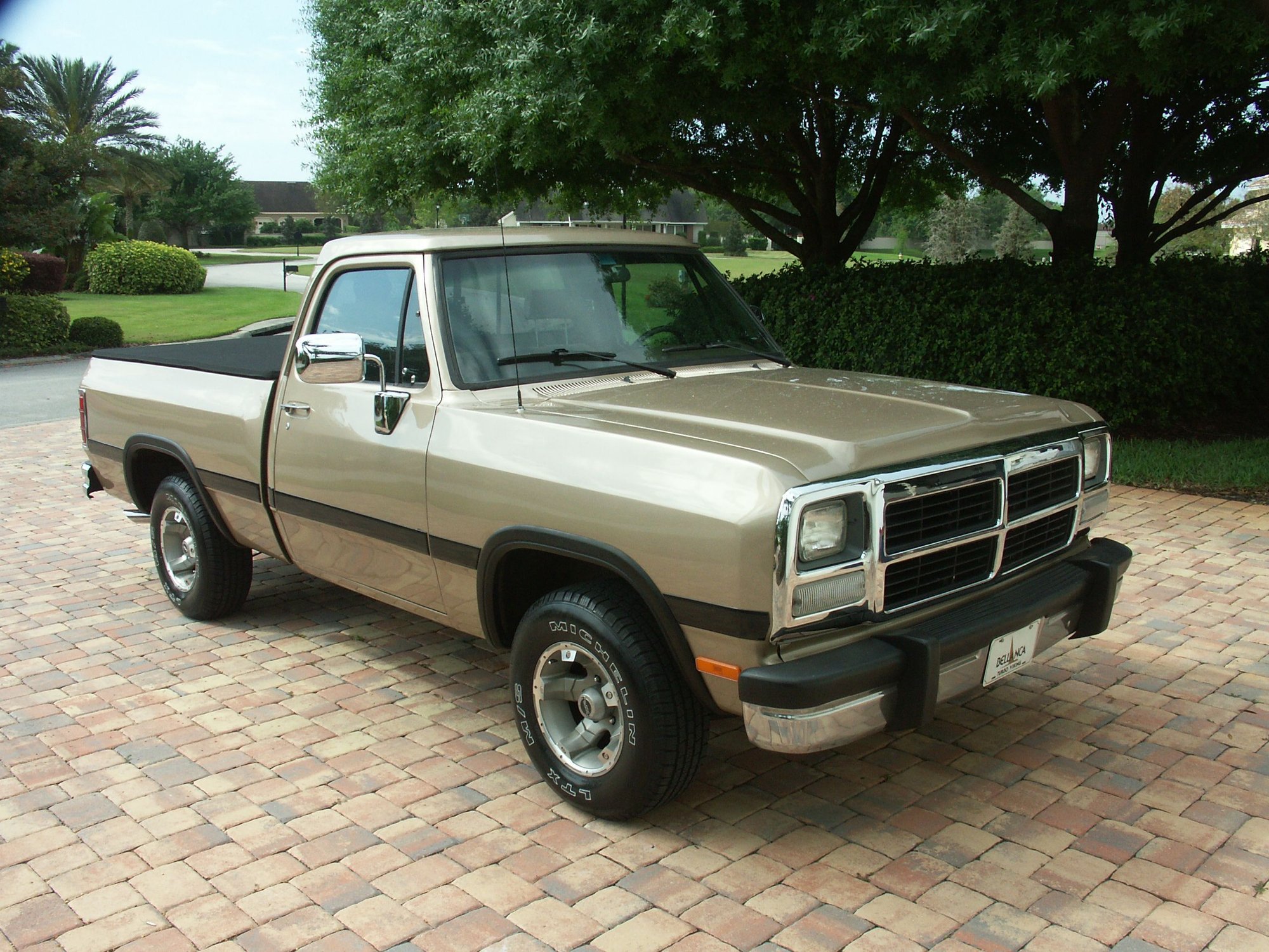

The ECM on my 91' Dodge D150 failed two months ago. As I could not source a replacement anywhere, I sent the unit for repair/overhaul. I received it back, it was plugged in and the truck started right up. My mechanic drove it briefly and then when they brought it back and tried to move it to another bay, It started and then promptly quit. I sent the unit back to the servicer a few weeks ago and I'm still waiting for it to come back. My mechanic is very well assured that the issue is the ECM and nothing else.
If I can't find something like the Blue Streak Electronics BSE-ECC2666, then I would also be willing to just find a core that I can send out for overhaul to BSE via Autozone. At this point I'm pretty frustrated as all I want is a plug and start cure to keep my relationship with this reliable old girl going. I've owned this truck since 1992 and I invested in a new gauge cluster for it last year from LMC.
If anyone knows where I can find one of these ECM's working or not, please pm me. The truck is 2WD, with a 318 and automatic tranny with overdrive. It was an LX so I even have electric windows and cruise!
