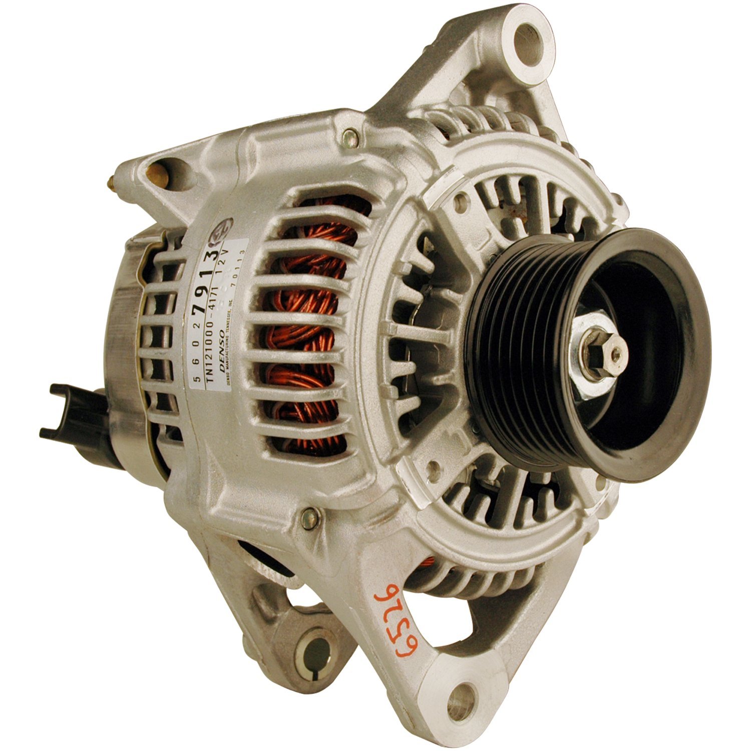

This Bosh (Denso) unit looks pretty nice, it's a 136 AMP output and only $116! With FREE shipping. That's an important factor to us folks in Alaska...
http://www.amazon.com/dp/B000BZIJAW/ref=wl_it_dp_o_pC_S_ttl?_encoding=UTF8&colid=DQ83S69VKBDK&coliid=IQRC8TVRJ1RMA http://www.amazon.com/dp/B000BZIJAW/ref=wl_it_dp_o_pC_S_ttl?_encoding=UTF8&colid=DQ83S69VKBDK&coliid=IQRC8TVRJ1RMA

New is always better than rebuilt or a good used part.
I snagged a good used one as a backup last year from a Jeep that was just a fun machine mostly parked in a garage besides the accident that put it out of action it looked like a new Jeep.
I was luck it just came in the junk yard that day and was in the prep yard still. They pulled it for me as I watched I asked for any bolts and screws off it they said just go get them if I wanted them as they left them in the engine bay.
Very friendly small junkyard cool place in Apache Junction AZ
If that part is new that's a great price but if that is the pic for it… it has junkyard writing on it so I question if it’s new?
Some places call rebuilt New so be aware of that I don't trust rebuilds seen many go bad in one year I stopped going rebuilt many years ago.

If you read some of the reviews for some of the other alternators offered by Amazon, they say something about how the box is imprinted "re-conditioned." That implies to me that it's new but a customer return that's gone in for a checkup and corrective action. A lot of the reviews mention crappy packaging and damaged in shipment (that Amazon ends up replacing)--which would go a long way towards explaining the source of the "re-conditioned" alternators.
Not sure what you are looking at but THIS is what I see:
100% new premium quality components, including major heat related/wear items: rectifier, regulator, rotor, stator and bearings withstand excessive heat and high electrical demands.
Bosch Professional Preferred 100% New Alternators are 100% full-loaded tested to meet or exceed original equipment manufacturers' amperage and voltage output standards for proven charging performance.
No other original equipment alternator or starter manufacturer charges as many batteries as Bosch in the Nextel Cup Series because the Bosch Professional Preferred 100% New Alternators provide more power under extreme, high-demand conditions.
100% full-load tested for proven starting/charging performance
There are many OTHER units that are advertised as reconditioned but this one list as NEW to me.
