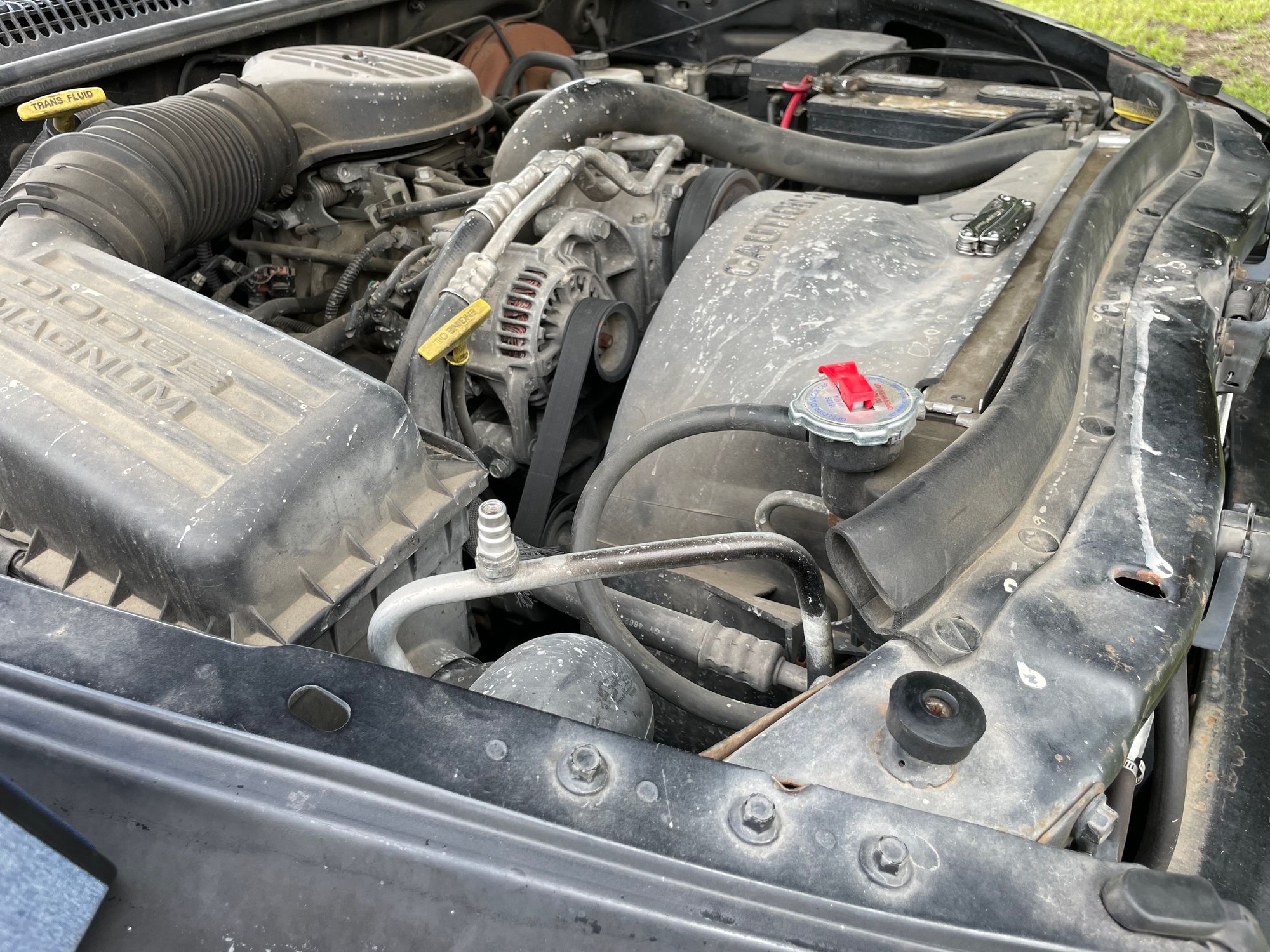

Looks like I have the same situation as the original poster. I was all set to do this myself but quickly learned that I don’t appear to have a low pressure port on my 1997 Dodge Dakota Sport V6. Good grief.

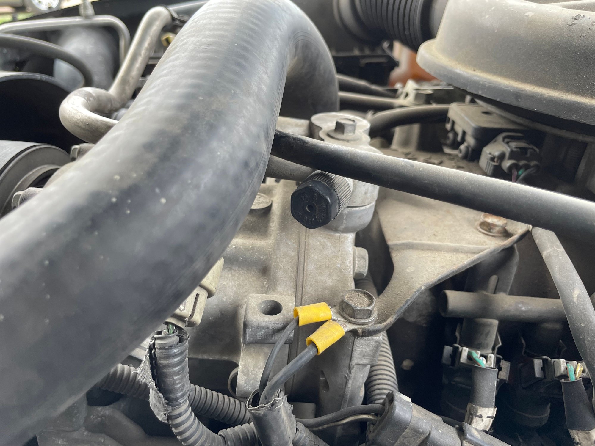

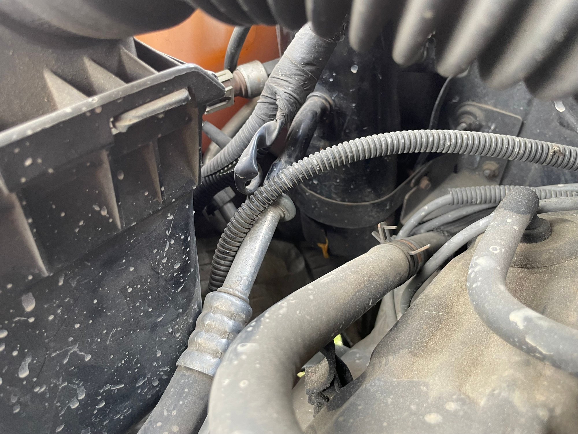

Default Some photos
Old Jul 15, 2023 | 08:43 PM
Posts: 87,480
Low pressure port is the one on the line by the radiator. Under that black cap on the compressor is the high pressure port.
Thanks, from reading the above it seemed that the port you referred to next to the radiator was another high pressure port. I suppose they were mistaken?

I did successfully recharge the truck for cool comfort using that port. Thanks, Hey you.
