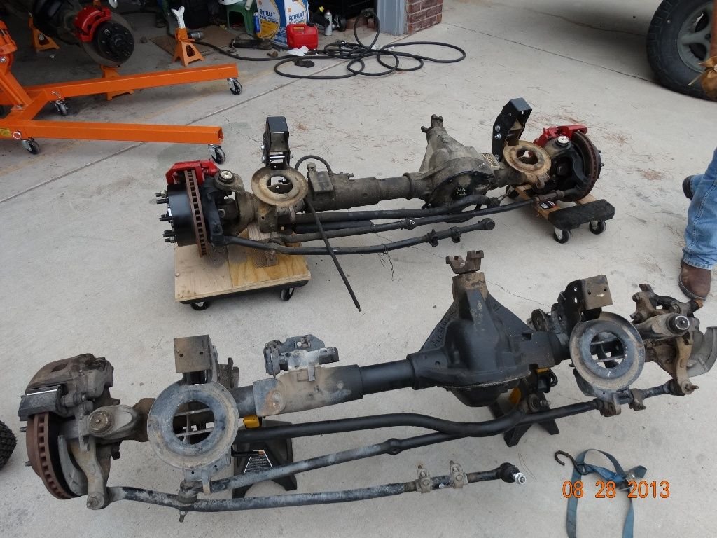

how much harder would it be to use a waggy front end. can i use an '80 waggy front axle?
Old Jan 15, 2015 | 10:03 PM
Tom A's Avatar
Tom A
Section Moderator
Joined: May 2012
Posts: 1,564
Likes: 9
From: Concord, CA
It's still pretty easy. You just have to make some kind of a front crossmember for the leaf spring hangers and figure out the shackles for the rear of the springs.
I'm not a waggy expert, so I'm not familiar with the specifics of different years, but if it has a left side pumpkin and no central axle disconnect or anything, it should work. My axle came from an '83 J10 pickup, if that helps.

Mine is from a Jeep J10 Pickup truck.
The crossmember is a structural piece that holds the stationary end of the leaf springs.
Some front axles have a 2-piece shaft on one side with a mechanism to connect and disconnect it. They're often found on vehicles that can shift into 4x4 "on the fly" and they are not nearly as desirable as axles with locking hubs. You can see them on these axles.
