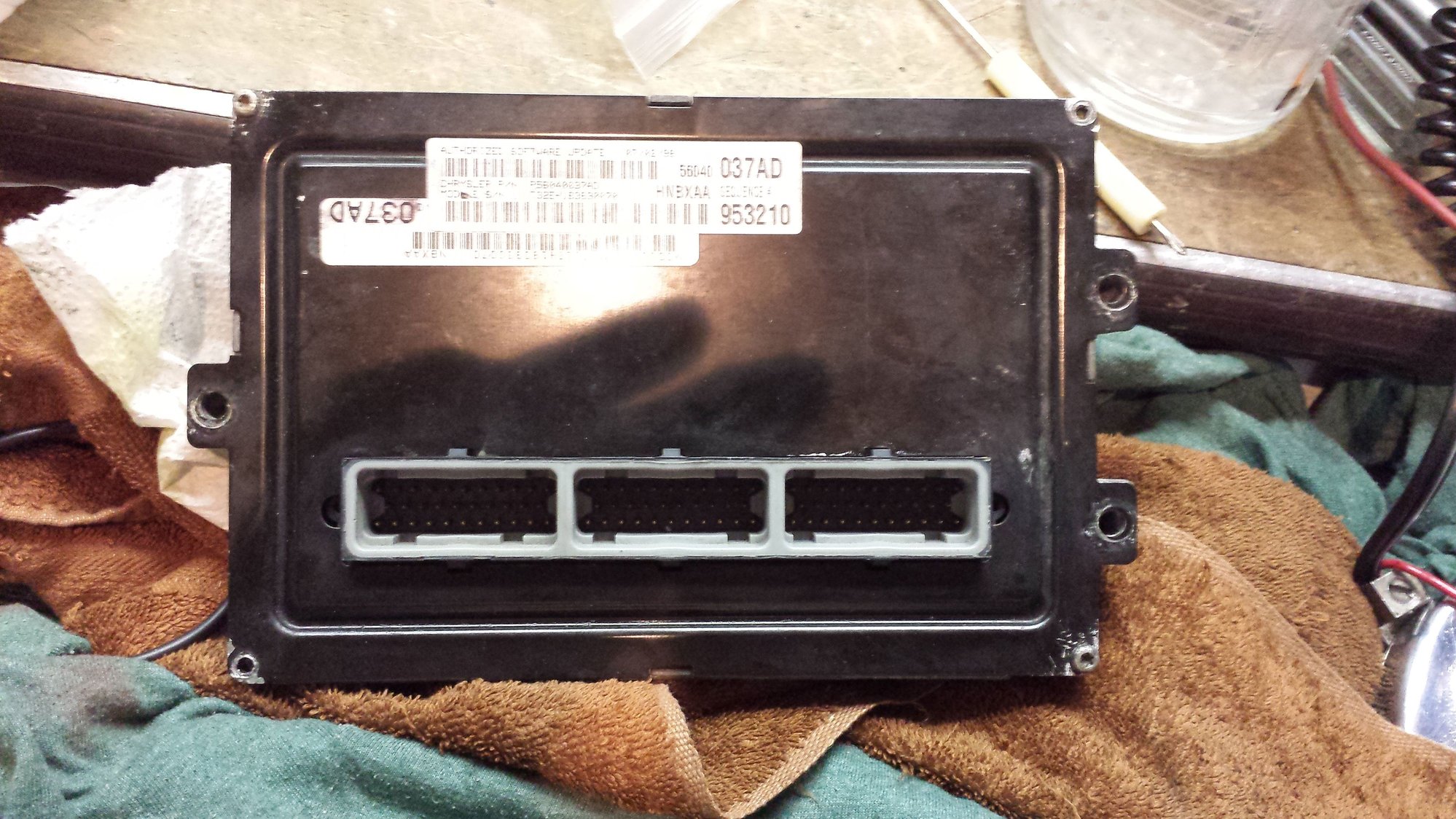

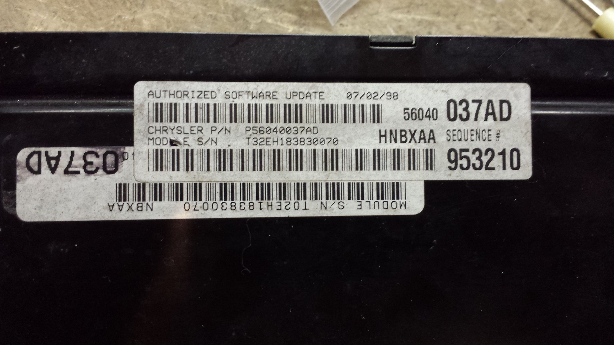

I wish I had an electrical print of this truck. .the pinout of the obd2 connector I have isn't the same as what I have on the truck. Here are some pictures.
Dakota <br/>
Dodge Dakota

This is for an '00. It's "almost" identical to your '99.
