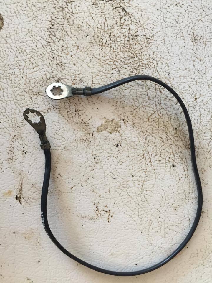

I have my son helping me today and everything is going really smooth. Whe we pulled the engine a week or so ago he removed this ground. Neither of us can remember where it goes. Any help out there?
Part number says 61789A and has rubber coating rather than looking like a normal ground.

Looks like one I found not connected and never could figure were it connected but everything works so no biggy.
If everything works don't worry about it I'm sure its an engine ground strap from the firewall to block usually connected to one of the valve cover bolts.
