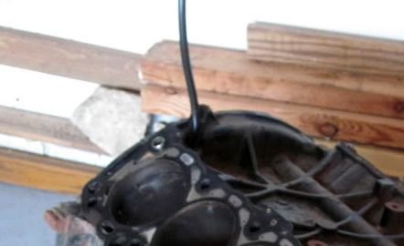

The block is cast iron, the heads aluminum.
It's based on the 4.7.

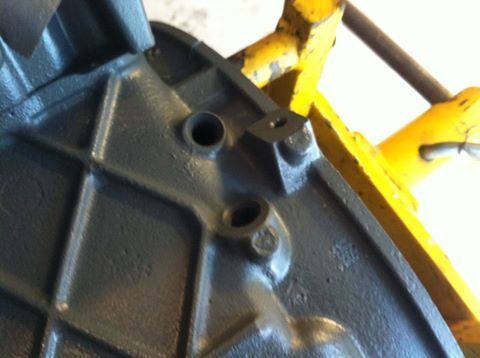

OK, On the top of the engine, under the intake manifold in the rear are three holes. 2 are for the dipstick. What is the other one?

This is a guess
Its a bolt hole that holds down one or both dipsticks.
