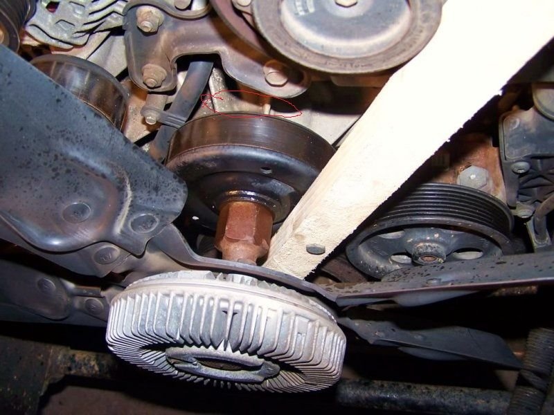

ok look at this pics ..theres some metal grind right here where the red circle is
this is the back of the fan clutch and it make some metal grind sound coming right here too so no choice :P
and this is not a picture of my truck its google

That's the water pump. It's probably bad. Take the belt off and see if you have any play in the cooling fan. If it wobbles at all, time for a new water pump.
