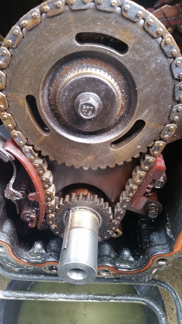

I got it it off finally.
Pretty nasty down there

When I was trying to get the balancer off. I did make turn accidentally. Did I mess the timing up?
Here is the cover off.
