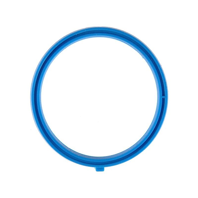

Yes. All the auto part stores have them and they cost about 2 bucks. I used this blue Felpro gasket. I also used Napa premium thermostat for about 8 bucks. When you install, look carefully at the little tab on the gasket (see bottom of pic above). It goes on a particular way. Oh, and the spring end of the thermostat points to the engine block, in case you forget.
The 4.7 thermostat is a pain to remove. I happened to have the radiator shroud/coolant overflow bottle off and it was real easy to pull from up top. I never got under the truck. It's easier pulling that, than fussing with everything in the way.
