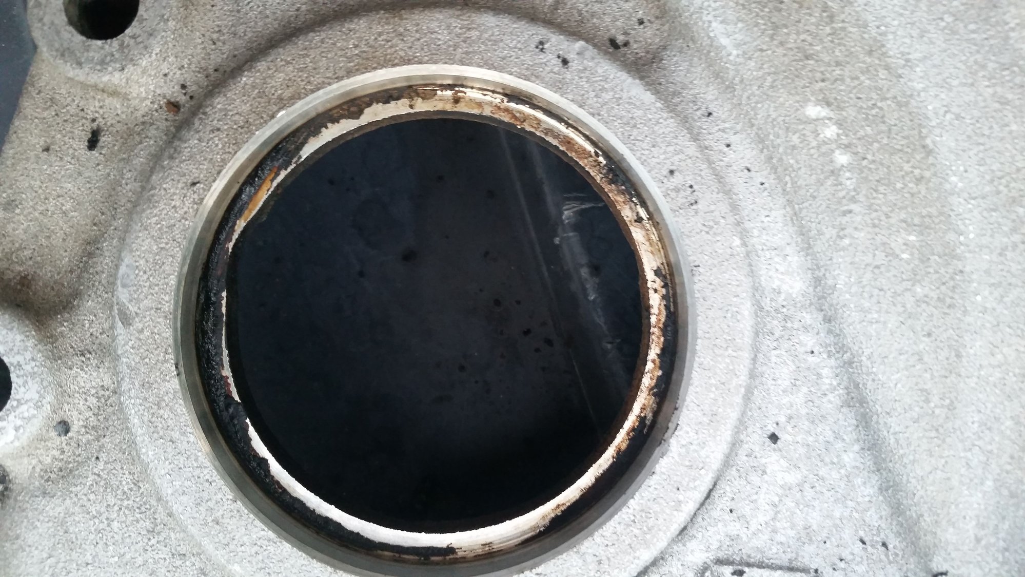

Old Jul 23, 2016 | 09:03 PM
  #30
markk96's Avatar
markk96
Joined: Apr 2011
Posts: 66
From: Belleville, IL
So I thought I would share. I got a salvaged timing cover. So stripping it I pulled the front seal out and noticed a bunch of sludge at the bottom of the opening after I got the seal out and I noticed this notch or whatever. So I got my original cover and did the same thing and had the same issue.
Salvage cover
Here is the original cover.
